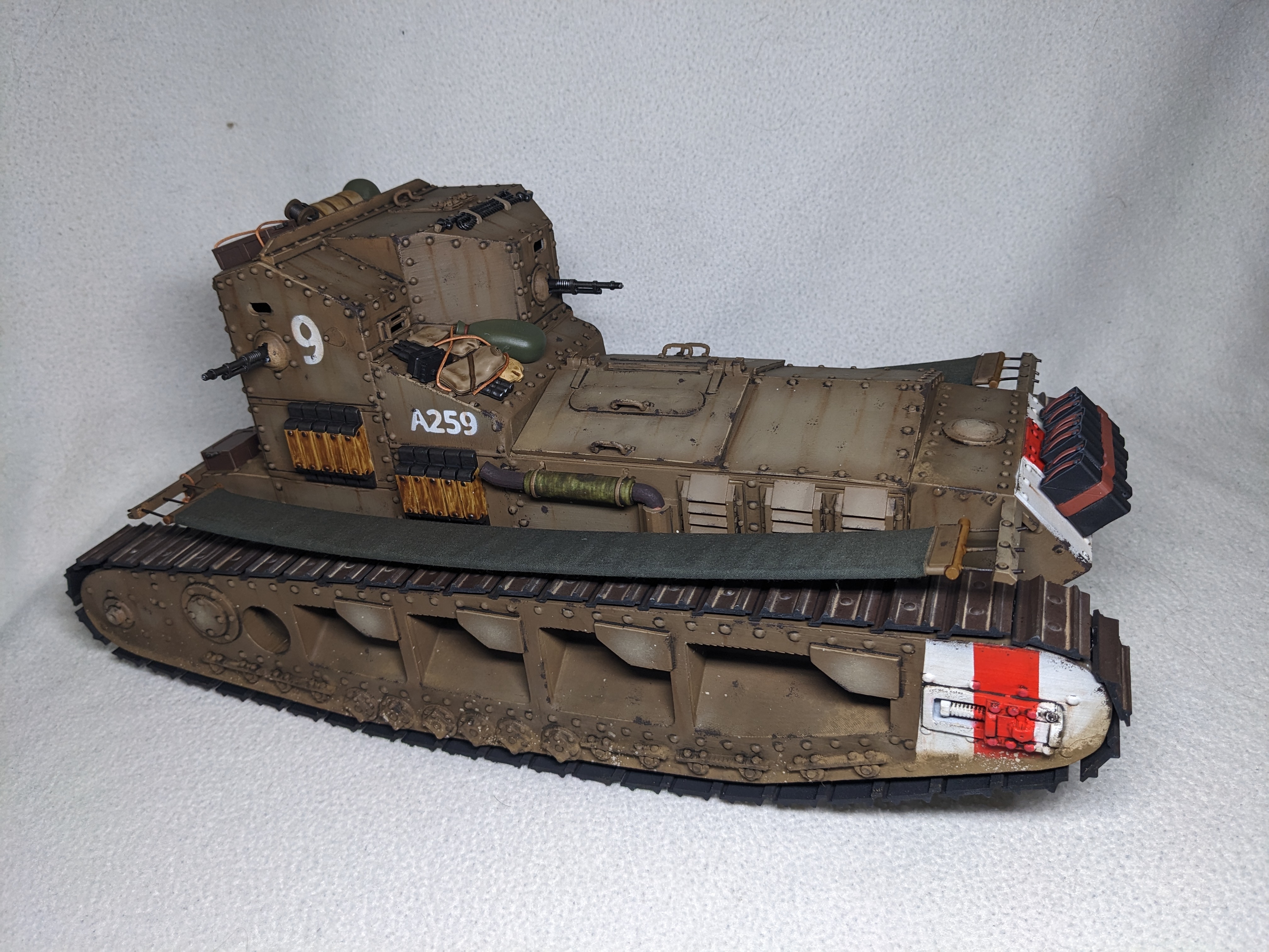

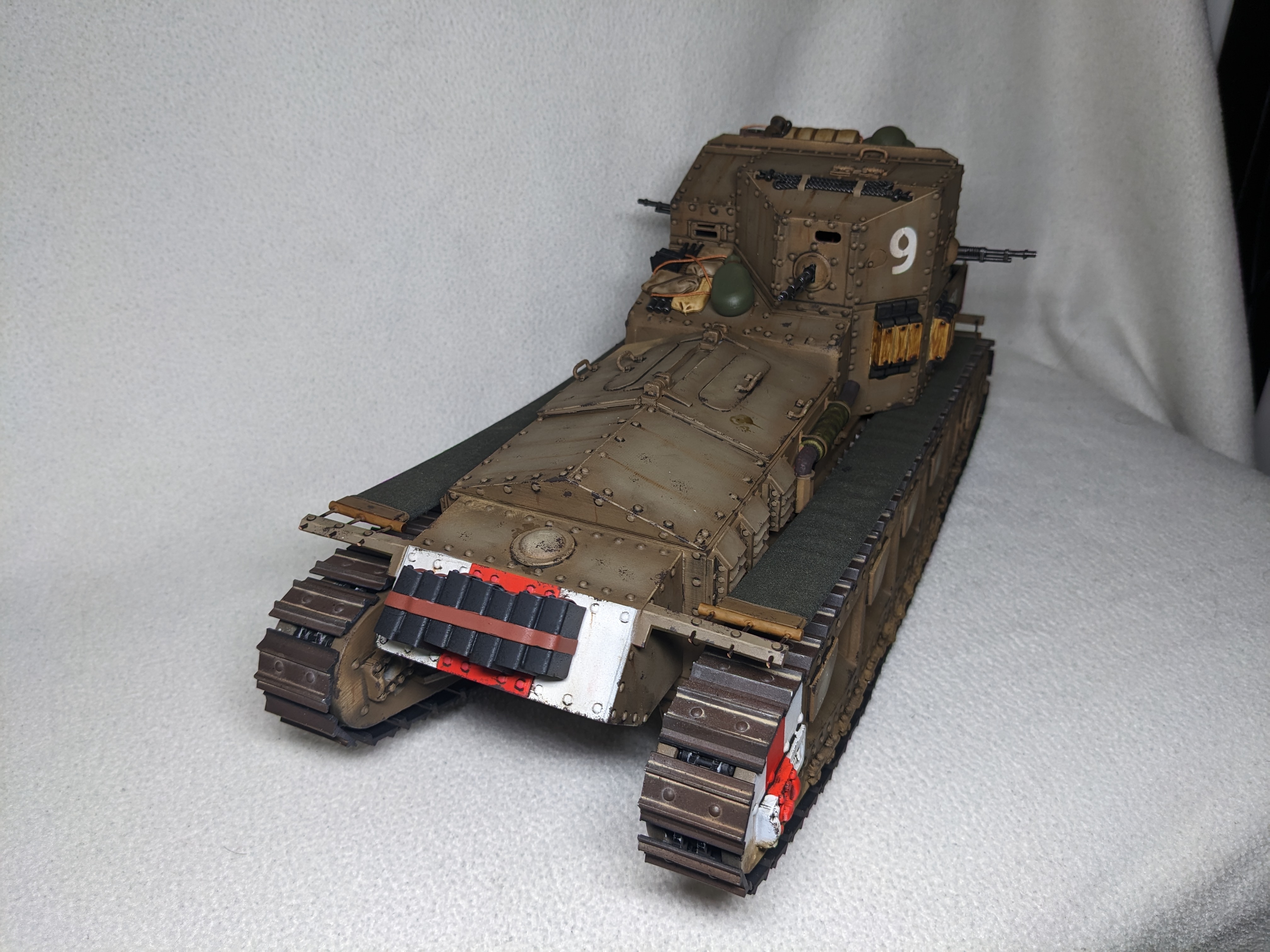

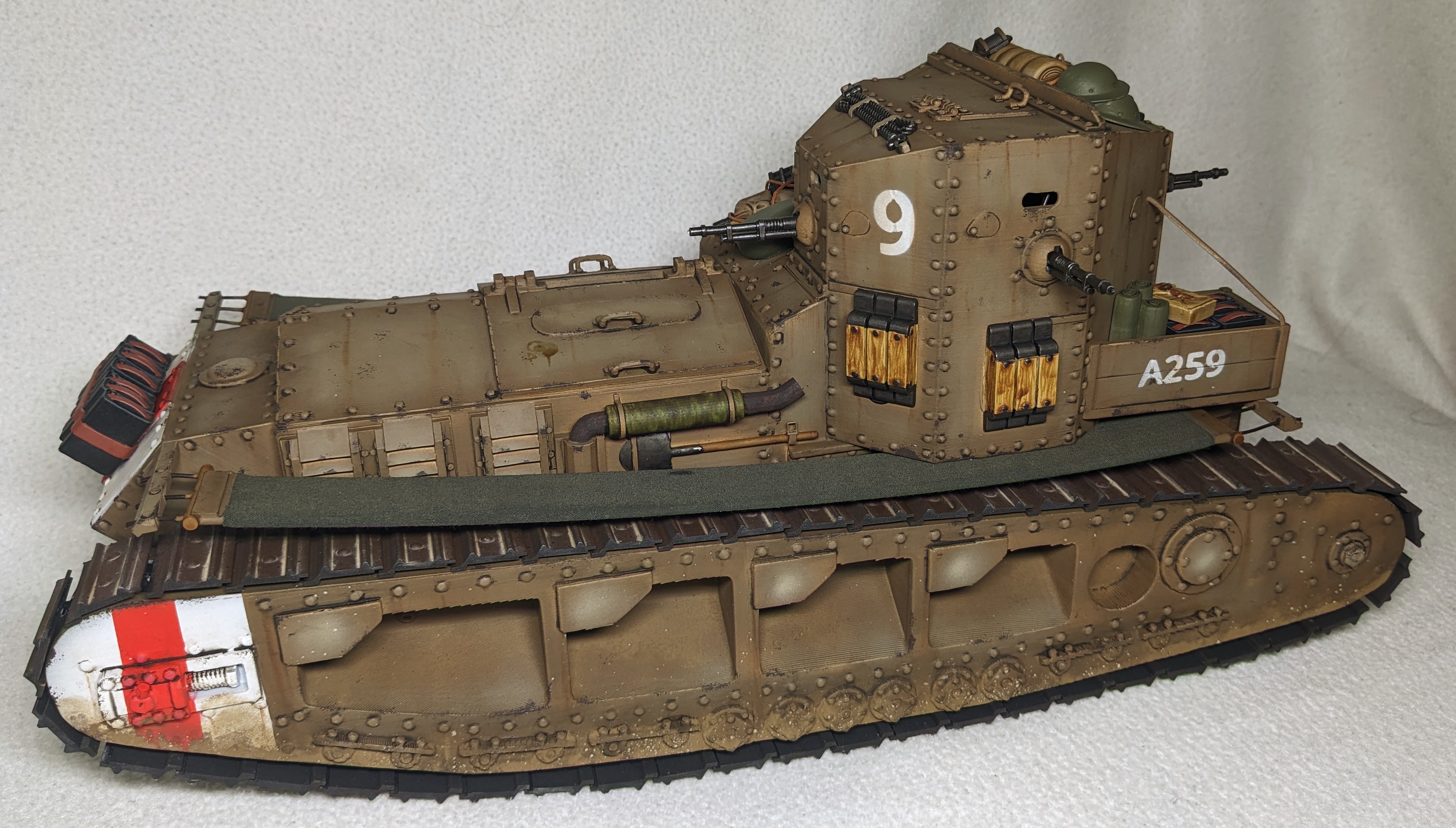

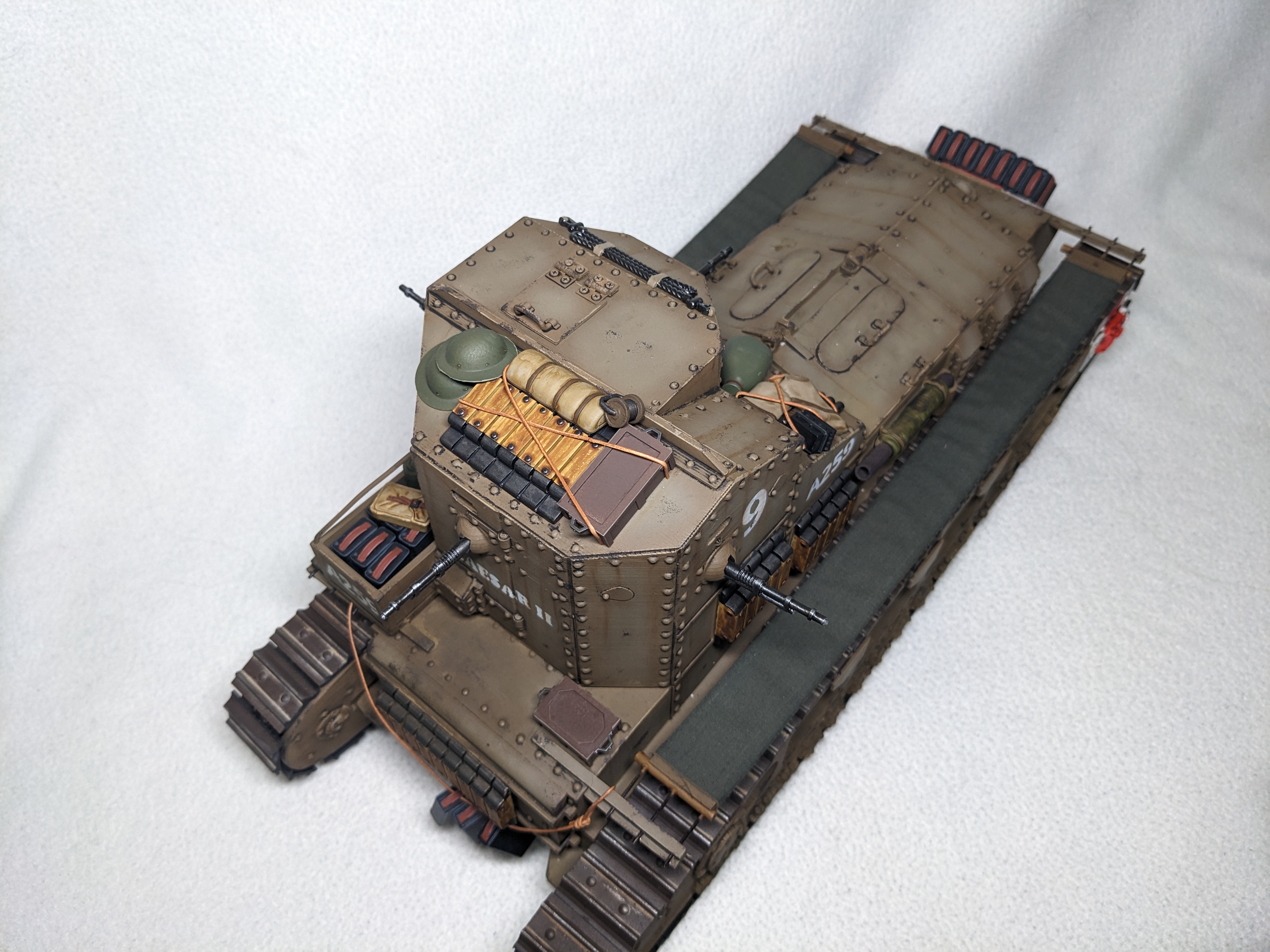

Hi, I just want to share with you my latest build.
WW1 Whippet tank. This is based on static model available here: https://cults3d.com/en/3d-model/art/whi ... edium-tank
I decided to build it after completing my Hooben Mark IV, big fan of early designs.
3d printed: main body in PLA, tracks and details in resin.
Electronis: dual ESC, DasMikro for tank sounds, DF Player and a small sugarcube speaker for background sound, Heng Long smoker (modified, motor replaced with a fan), MG flash, cab light.
Unfortunately I used too weak motors. All was fine when I was testing (floor tiles). After building and painting I tested again on a carpet and it struggles turning. Lesson learned. Not a major disaster, I just need to replace JGY-370 motors. I'm thinking 35kg servo modified to run as a motor should work perfectly.
Anyway, several photos and a video below.

Absolutely awesome, I love those WWI tanks !

Great build! Kind of surprised my brother hasn't chimed in, I think he saw those in action....

Fantastic build sir, and rare in this scale too.

Thanks Guys,
Really happy with that tank except those underpowered motors, how I managed to do it? So silly mistake. But fixable, just needs a small surgery.
I'll take a break and do Ferdinand first as I want something simple but the next one I will publish here with more photos.
My plan was to do Tsar but when I calculated the size of it in 1/16... I don't have space for that! That leaves me with either Schneider or more likely Matilda I.
I was thinking about documenting one of my builds as I've not seen anybody adopting similar approach (redesigning existing static 3d models).
