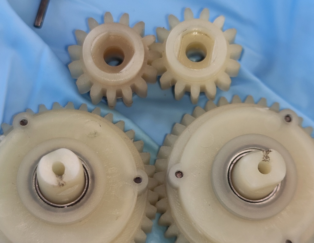

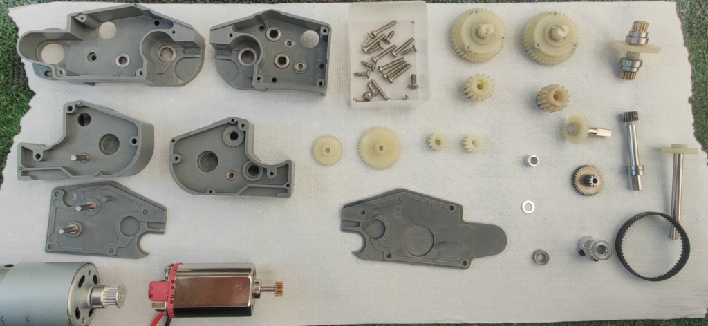

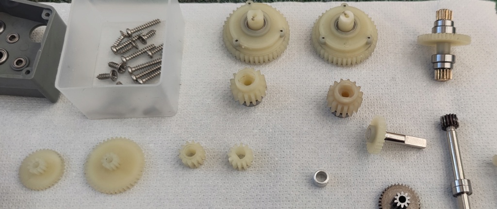

We proceed to tear the Gear Box to pieces:

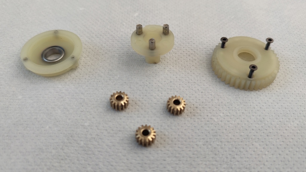

The heart of the Gear Box are two planetary gearboxes
Let's compare them:

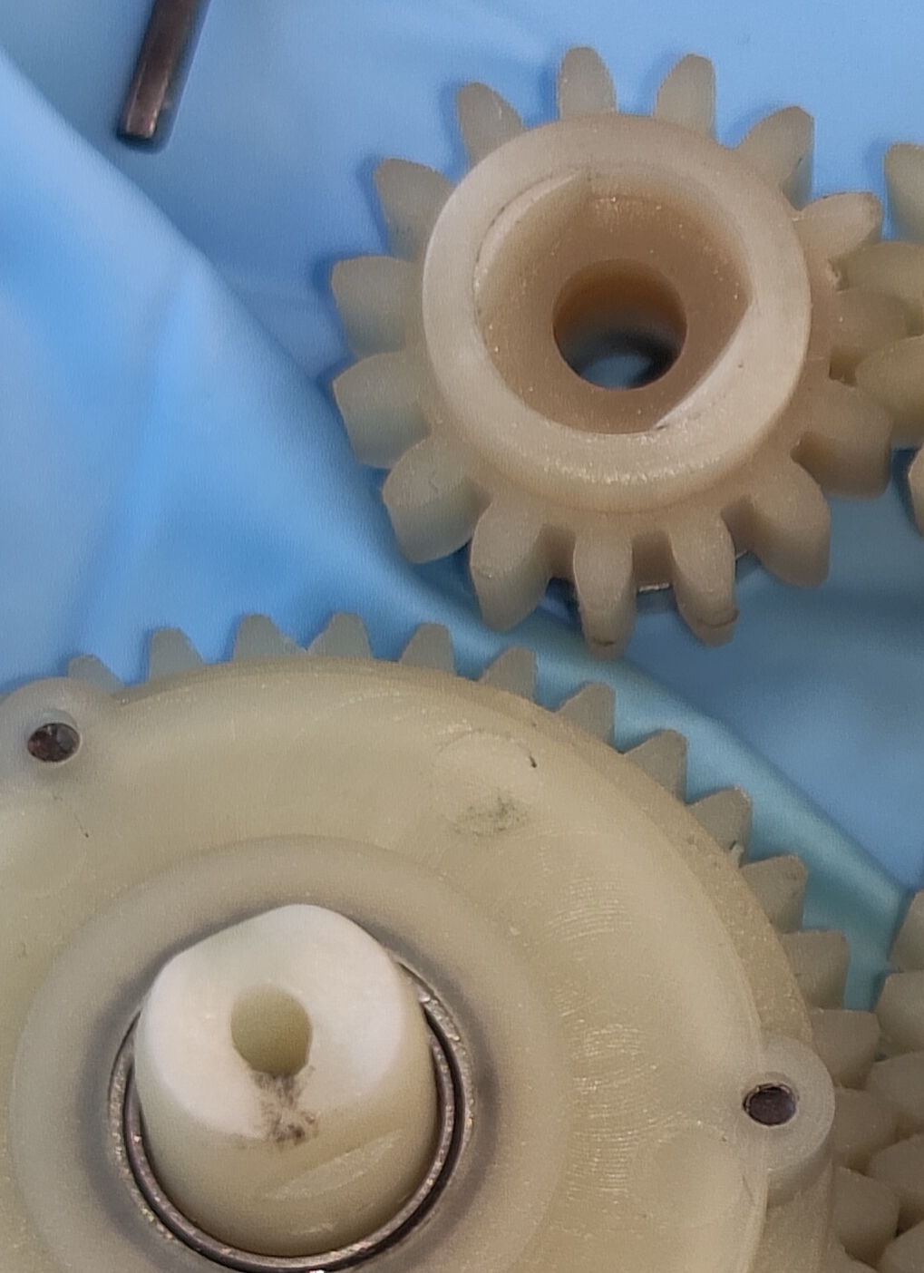

Under stress, the output shaft of one of the two planetary units yielded and deformed. The housing in the output gear has also been deformed. It got hot ........ look how it changed color:
So excellent silent and precise Gear Box for a light and fast tank. If you want a Gear Box for a heavy tank, which reproduces the speed of a WWII tank, which does not walk only on golf courses, it is good to stay away and go back to the classic Gear Box with gears:
