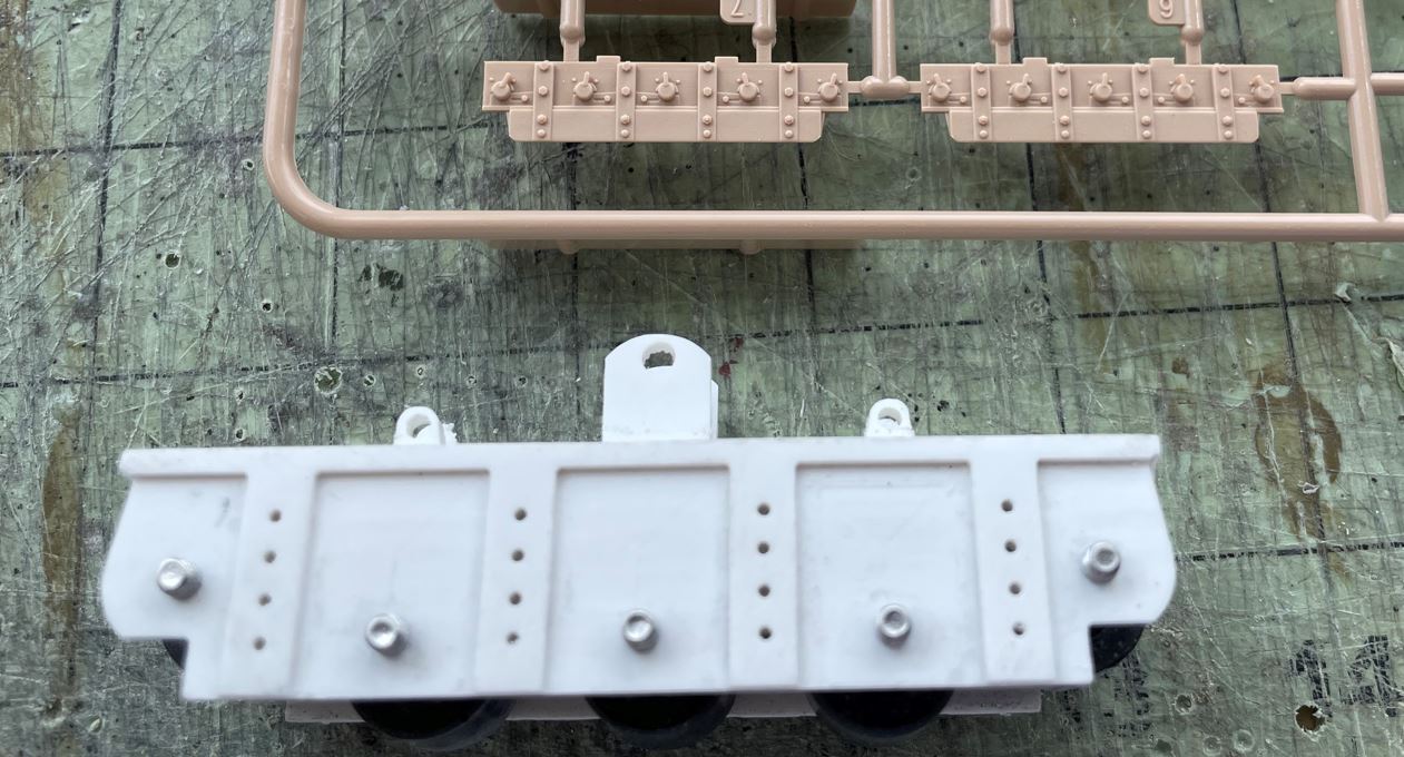

Now, comparing the 1/16 Ludwig kit with extrapolated measurements from the 1/35 Meng kit, i can already see some issues with the Ludwig kit.
- Length is ok
- Width has problems
- The crew compartment is about 14mm too high
- Doors are too wide, all the hatches have dimension problems.
A7V German WW1 tank 1/16 RC - Build
Main issue for a rivet counter like me is the fact that the pre-drilled holes for the rivets are not right. Not enough of them and the disposition is inaccurate.
Angles are also not right. Oh well, nothing new, i have built many Ludwig kits, I expected that but always hoping for the best. All of it will require a level of correction, or parts replacement.

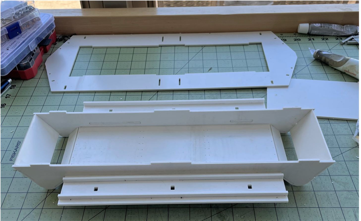

Starting with the lower chassis, build without problems using the few vague pictures provided on the Ludwig website.

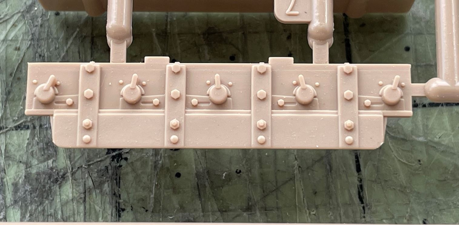

Comparing the suspension modules with the 1/35 kit, we can see many differences in shapes.
Because of the Sherman tracks used, the roadwheels needed to be positioned lower on the Ludwig modules.
We can see that the real tank had tracks with a large and raised structure, not present with the T49 tracks.
Because the module are very inaccurate, i did not thick it was worth spending time trying to rework them. They are too different from the real thing and they need to be functional. At least, i gave them rivets instead of the 4 rows of holes on the sides.
