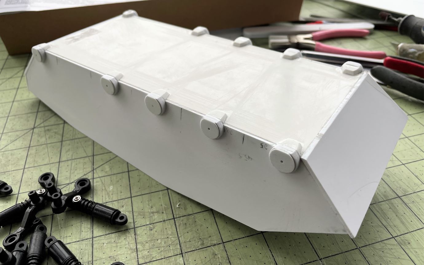

Seen here are the M-24 suspension hubs that need to be created. It involves some complexity because the side armored plate are not strait. The suspension arms have a specific shape and length. How it comes together is unique to this tank, every millimetre makes a big difference. The idea is to do something close, but adapted to RC components that are the closest match.
RC 1/16 M-24 Chaffee light tank- Dien Bien Phu 1954 - Build
First tasks is to create the suspension hubs. Basic shapes and components are created.
The positioning of the suspension arms need to account for the length and thickness of the suspension arms, the size of the roadwheel, height, space between roadwheel, placement of the dampers, distance between the tracks and the hull, etc. It took me a couple of hours to do calculations and make decisions on the positions, but also shape and thickness of every parts, etc. Adaptation and compromises are required to make the integration work.

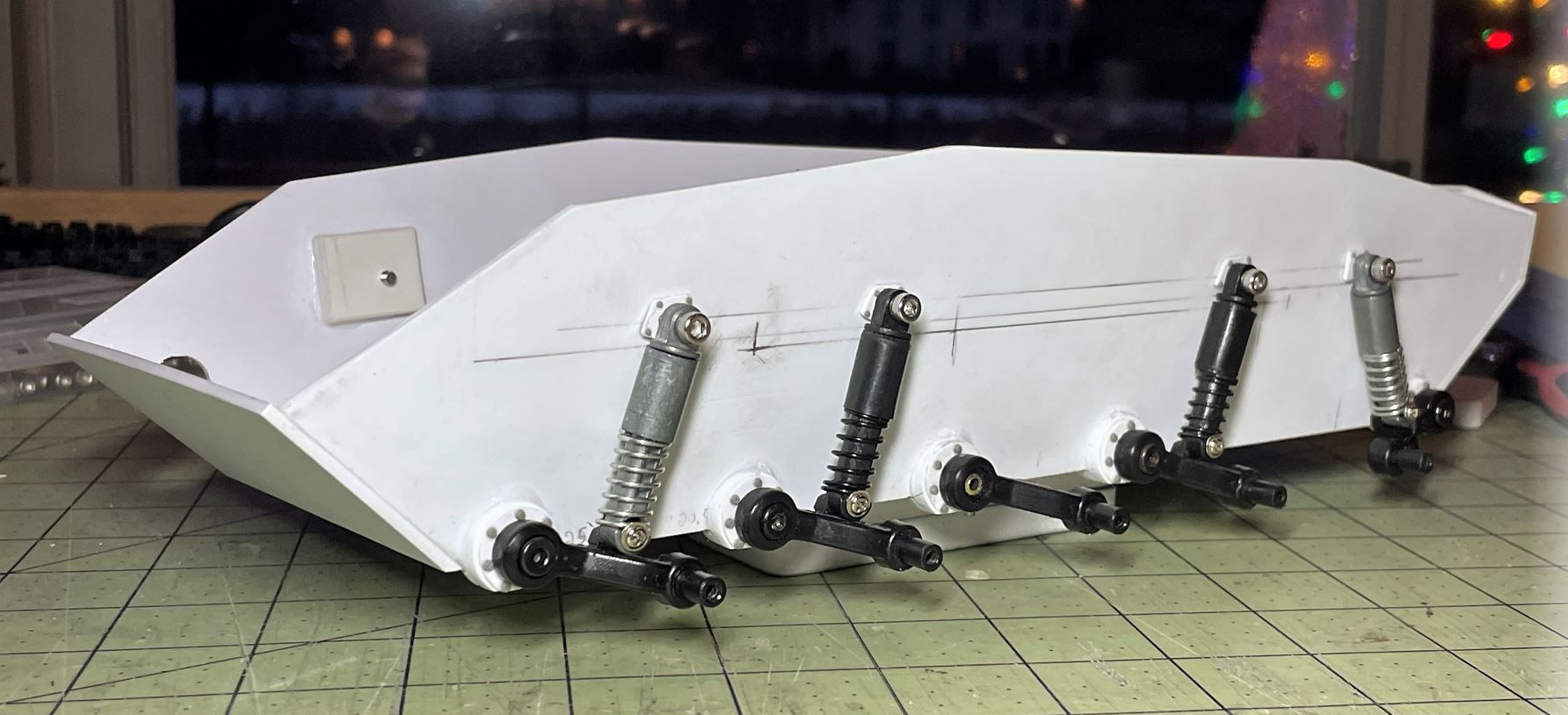

Hubs are positioned carefully, every half millimeter makes a difference.
The suspensions arms are prepared. An assembly chain was created to rework all the 20 roadwheels according to the prototype shown early.
Roadwheel 1, 2, 4 and 5 have a damper and that is what makes the suspension for those wheels. However, road wheel number 3 does not have a damper. I thought about giving no 3 a torsion blade suspension but i had difficulty creating a system that will hold the suspension arms in place with the torsion blade using the HL suspension arms.
So, i opted instead to move the damper inside the hull like i have done in past builds. A shaft extension is created that connects the external suspension arm to another arm inside the hull linked to the damper. The main shaft is in thick brass and goes through an aluminum tube so that it does not get into contact with the softer plastic when operating.

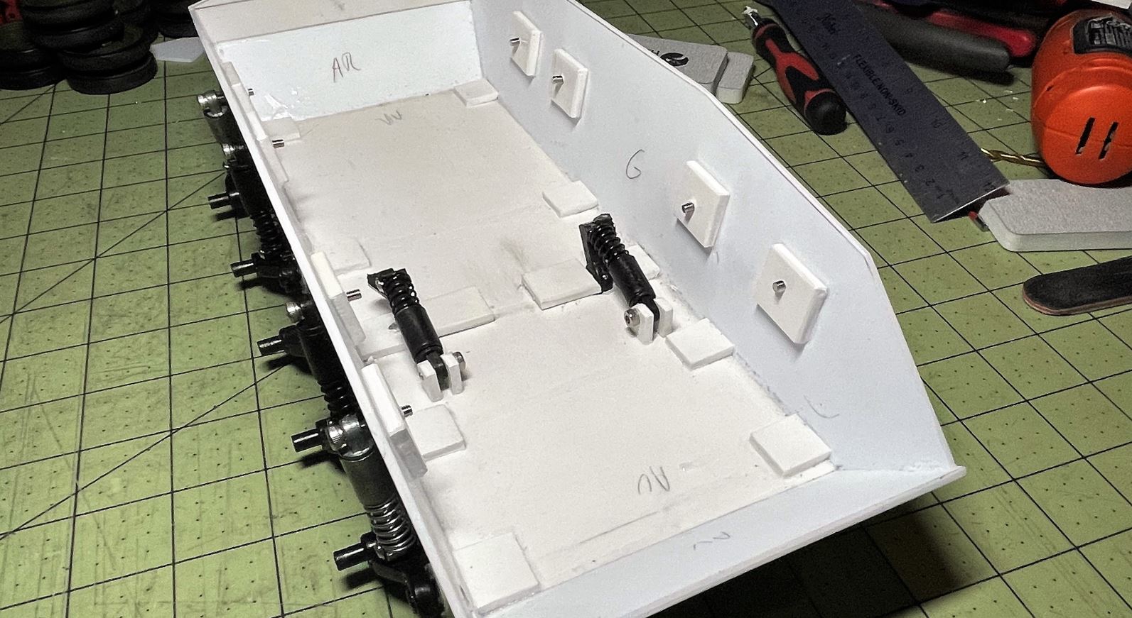

The internal dampers are given anchor points at the proper location to activate the suspension like if it was outside.
continuing on following post
Re: RC 1/16 M-24 Chaffee light tank- Dien Bien Phu 1954 - Bu
Overview of the hull with its main suspension. I had to put the dampers a bit more strait than i wanted compared to the M-24. If i gave the damper the same angles as the real ones on the M24, the RC suspension was becoming inefficient.
Because of the weight of the gearbox at the front and also because the tracks will be pretty tight, I gave roadwheel 1 and 5 a stronger metal damper with harder spring. It will be less smooth when hitting an obstacle, but the hull will show correctly.

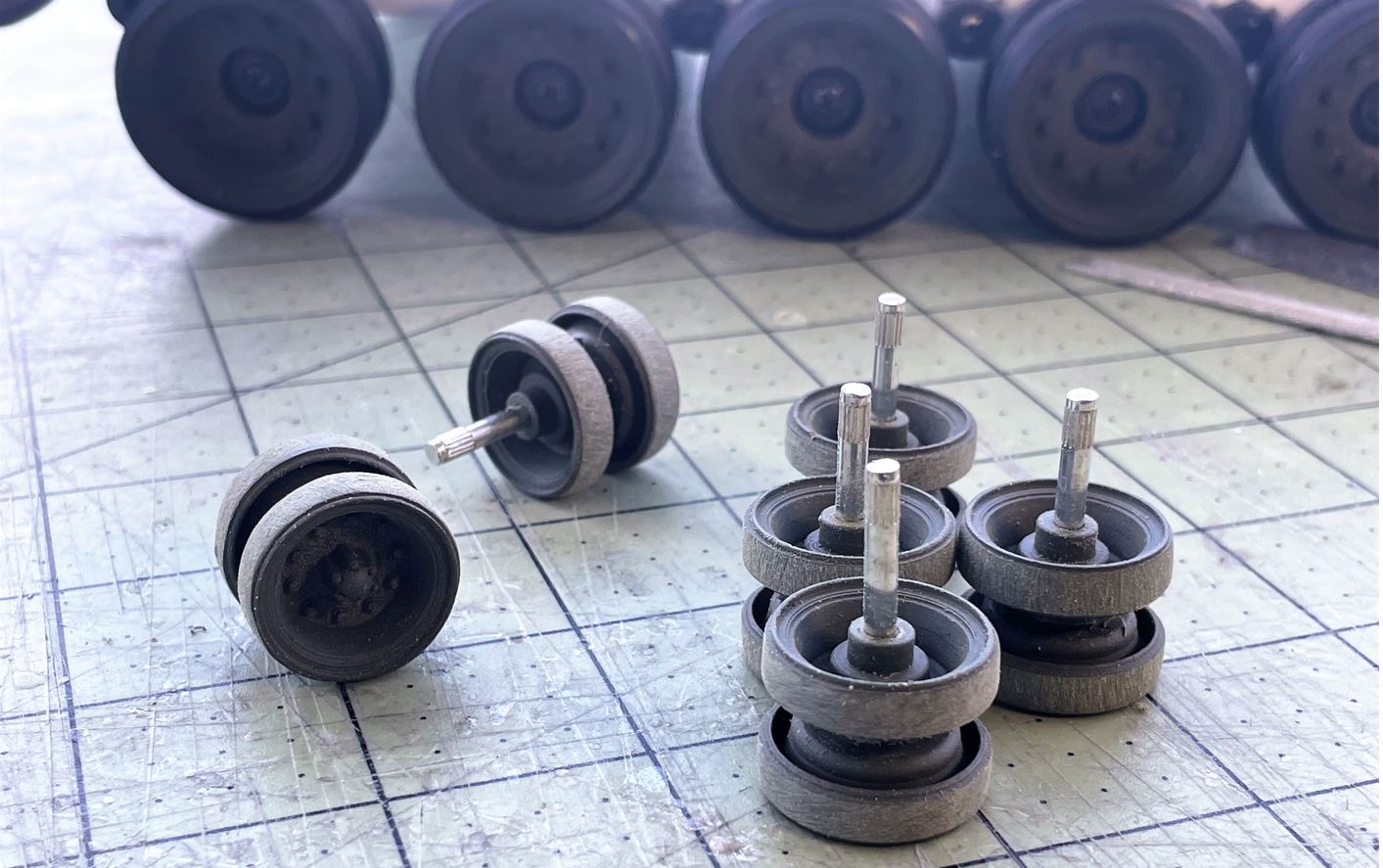

The reworked road wheels are installed. At this point, everything if pretty rough, i did not polished anything. The gearbox was simply thrown inside to give the hull some weight.
Alignment and solidity are critical.
Notice the thinner roadwheels compared to regular M41A3 or M26 roadwheels. A lot of efforts went into this. The resizing of roadwheels is recommended only to experienced modellers.

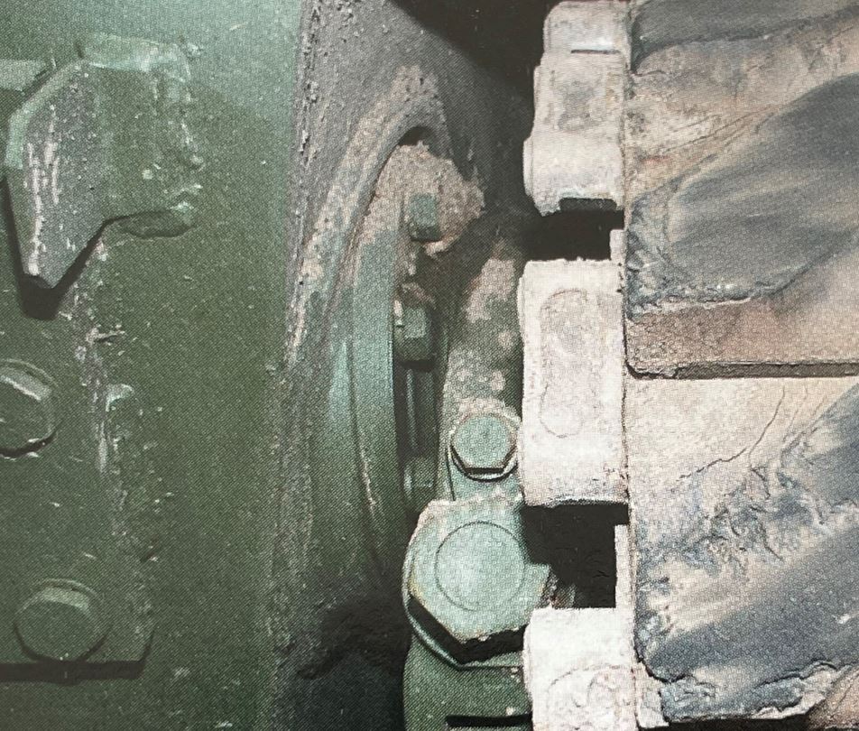

View of the M24 Chaffee sprocket. It is very similar to a Sherman but with closed teeth.

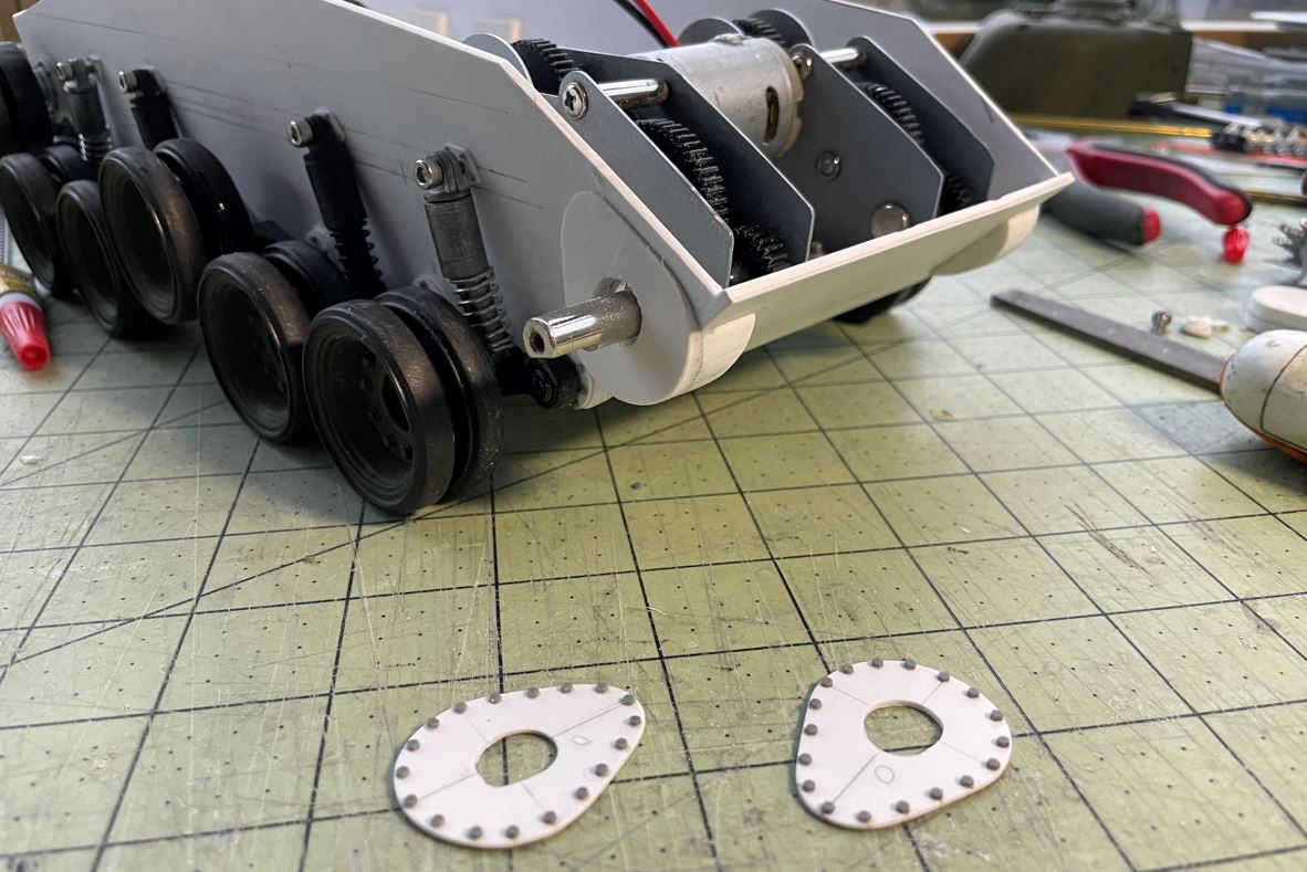

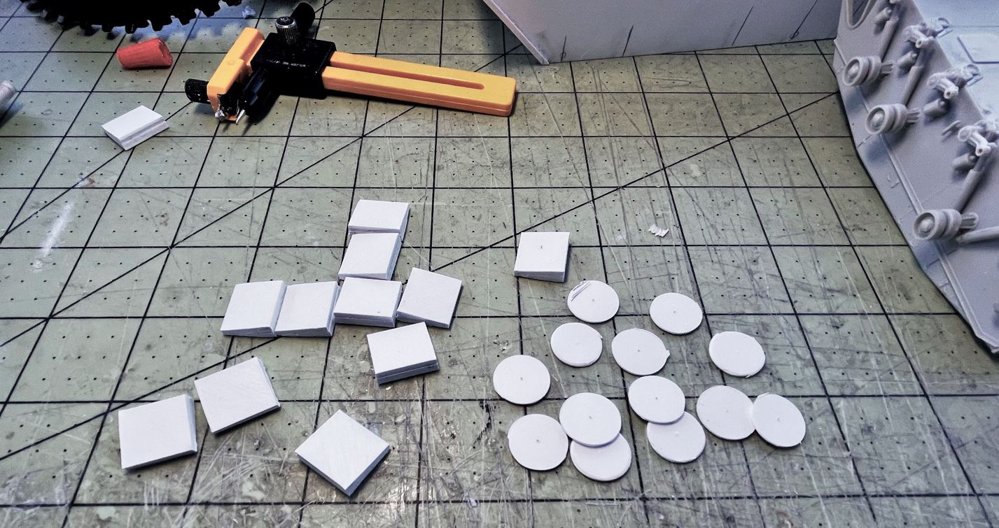

Looking at the front lower panel, the M24 has large sprocket hubs.
I decided to build these using solid 4mm plasticard in 2 separate sections (frontal and sides) coming together at the front. Plasticard layers are glued together and then carved with the Dremel in a slow telescopic fashion, adapting the parts to the various angles of the hull on all sides. Grinding a bit here, a bit more there, until they seem about right. The superglued and sanded smooth, superglue being used as filler on all joints.
The side bolted plates are done separately as they are technically removable, the separation must show.
Here are the finished sprocket hubs.

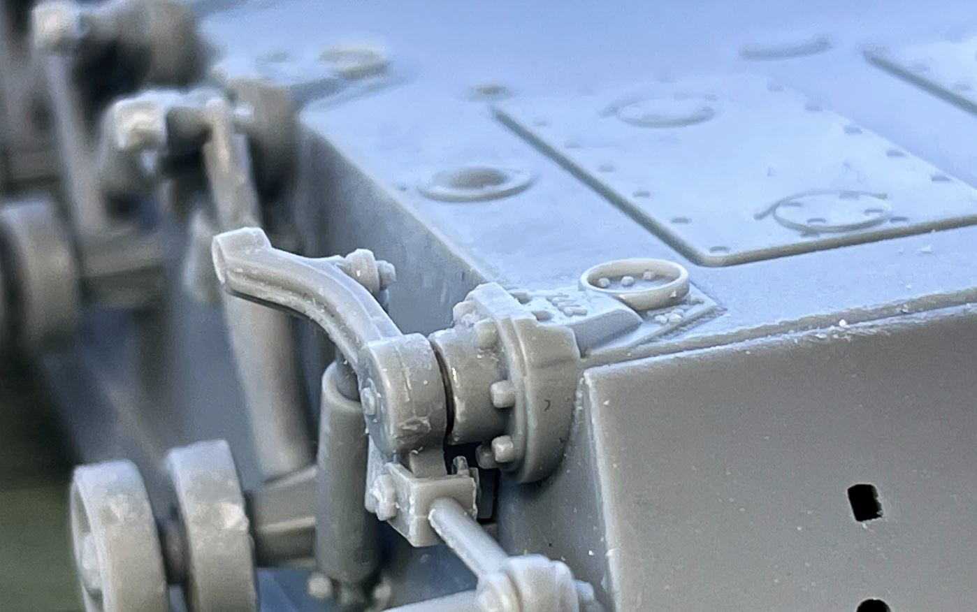

The return roller mounts and roller as seen on the Bronco 1/35 kit.
For the return roller mounts, i took an old M41 chassis in the scrapyard and cut the 6 mounts with the Dremel to provide raw material for the M24 roller mounts. Because the M24 has an angle on the side armor, i am again forced to manage angles.

I added the side reinforcements and some details. At this point, they are longer than they should. They will be cut at the right length once the return roller wheel in put on and exact calculations can be made.
The return roller mounts are installed and then cut to the right length on the exterior end.
Continuing on following post

The return rollers are prepared but not reduced in size as much as planned. They would have been too weak.
Return rollers are installed.
I did not polish the rubber rims.
On the M24, the return rollers are higher than the sprockets and idlers. They are properly aligned, something to watch for on such scratch build model where everything bad and wrong can happen at every step.
A few words on the references used on this build.
The Squadron Signal Walk around book on the M24 is a must have for this build. Contains tons of color pictures, explanation graphics, painting guides and is well explained.

The WWP book on the M24 is ok but there are gaps in the walk around set of pictures, requiring the modeller to look elsewhere for specific areas of the tank. Strangely, half the book is focussed on the interior and the engine compartment. I am aware of the Verlinden 1/35 engine compartment that would make engine pictures relevant, but i do not see how all the other pictures of the interior can be of use to most buyers unless the modeller scratch build it all.
