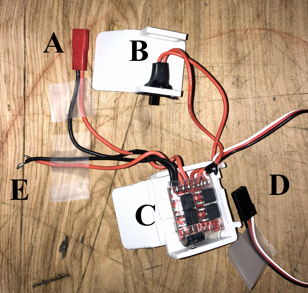

Here come the first of many questions.
I have guesses as to the purposes of each of A through J, but I am checking here. Once I have these all correctly identified, I will have more questions.
A: goes to ...?
B: is obviously the on/off switch under the passenger seat.
C: is the receiver/controller board or ? under the driver's seat
D: goes to ...?
E: goes to ...?
F: this must be the steering servo
G: goes to ...?
H: goes to ...?
J: goes to ...?

A: battery
C: Electronic speed controller (ESC)
D: Receiver (neutral, active and signal wires)
E: motor
G: goes to receiver
H und J: look like lights front and rear, so it goes to whatever supplies the correct voltage (5v? 3.7v?)
But I am a novice - don't trust me!

Right then professor here goes :D
A - is where you plug a 2s lipo battery into
B - as you rightly say is the on/off switch
C - is the esc ( electronic speed controller ) which is basically the small brain's running the jeep
D - plugs into the throttle channel on your receiver
E - are the cables ( minus a connector ? ) into which your motor cables should go
F - is the steering servo
G - is the steering servo plug and goes into channel 2 on your receiver ( next one over to the throttle channel )
H and J - these are the cables from the motors, you can fit an appropriate connector to plug them into the corresponding connector that you should fit to E.
Hope this little lot will get you started :thumbup:
If I had to guess as to the connectors, I would have done alright. I see that my next challenge will be getting a transmitter, receiver, battery, and charger. Hmm... I could go to a hobby store later this week.... @) I am thinking about a FlySky with six channels...
