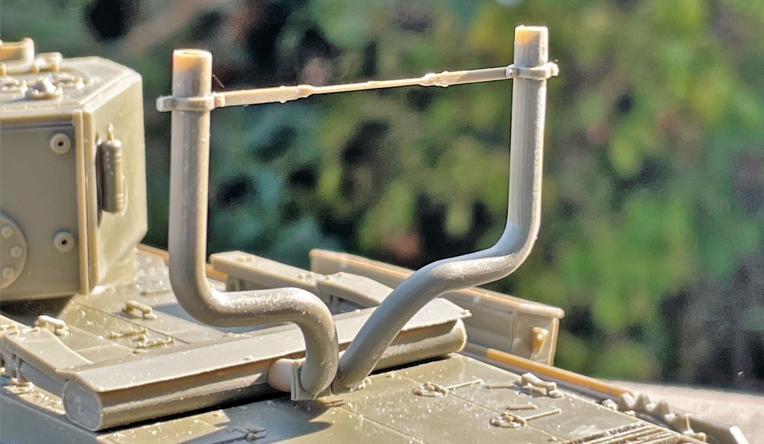

A trademark of a landed Churchill Mk III tank at Dieppe is the presence of deep wading stacks connected to the standard two pipe exhaust on the rear deck. But they only seem to be adding depth to the disturbing sights of the carnage.

I completed a bit more of the 1/35 tank to get a feeling of the general placement of each items on the rear deck, such at the exhaust exit points, hinges, hatch locks and handles.

The deep wading exhaust stacks. I used them as a model for the 1/16 scale but i later sadly noticed some shape issues with them that i think i will have to rectify. The second section is horizontal while it should be sloped a bit towards the inside.
