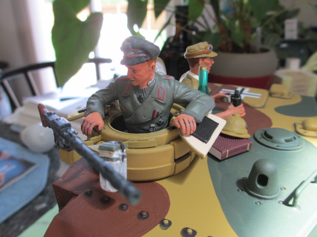

Good Afternoon,
A lot can be done with the older Heng Long figures. Just takes some extra work as they are nowhere near as sharply defined as even Tamiya figures. Best bet is to lightly buff the whole figure then primer it in a good Tamiya type plastic primer. Then get out your various sizes of brushes and acrylic and oil paints and pick a uniform and set of facial colors and go to work. I'm the guy who created 'Crazy Joe' and have always had more luck with Uniforms than faces but there are some true Masters on the Forum here when it comes to Figures.
regards and following along,
