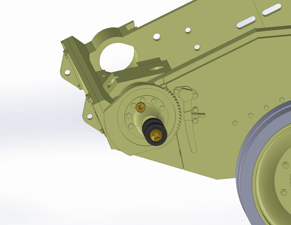

This is a track tensioner from the outside.
Following original as much as possible.
There will be still some limitations and some compromises, but i am trying to do my best.
