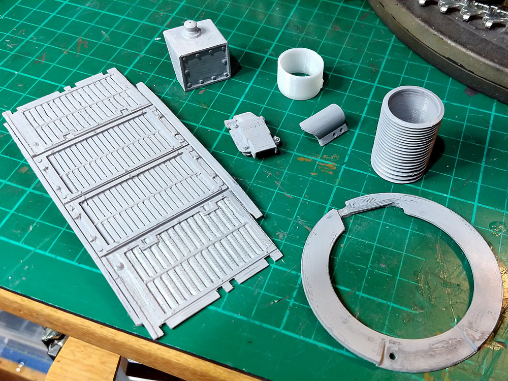

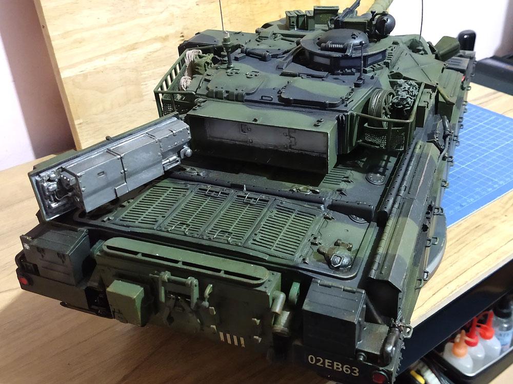

Early on I made a start by designing and making the various parts needed to upgrade the Chieftain to Mk.5 and beyond. The following are just a few of the 3D printed parts I made. In fact I designed and printed around 50-60 parts in the end but I didn't get to take pictures of them all unfortunately (pictured here is the raised 4 door engine deck, the MRS light projector, MRS mirror housing, cannon boot, Capola ring, Clansman radio box, and fume extractor counterweight)....

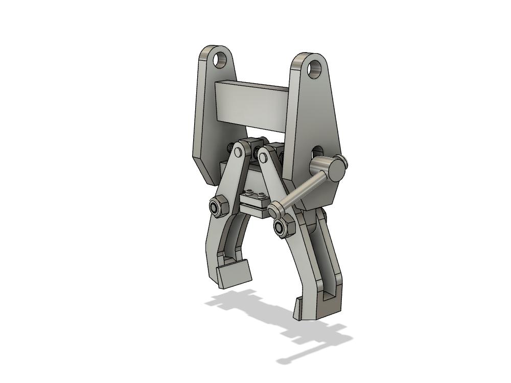

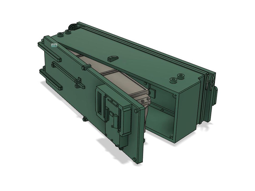

Here are a couple of the more difficult parts from the Fusion 360 collection, the NBC no.6 pack for the rear of the turret and the later design travel lock which I designed to be fully functional.....
Travel Lock Fusion 360.jpg (36.75 KiB) Viewed 7221 times

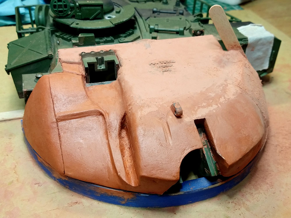

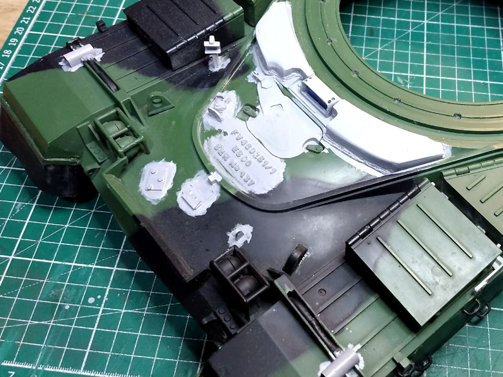

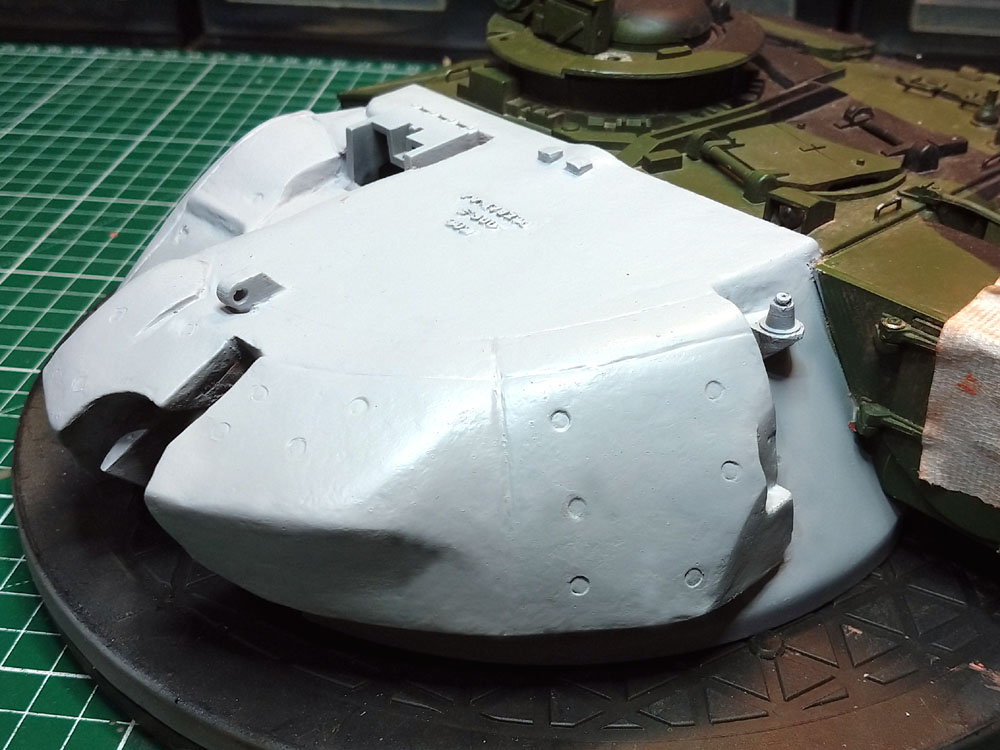

Having begun to strip down the Chieftain I began installing some of the upgrade parts. However, I eventually arrived at the point where I need to tackle something that I knew was going to be a bit of a challenge - the StillBrew armour 8O . I knew this was going to be a challenge because I had little available in terms of data for the shapes, depthss and angles, etc, involved and I am just not too good at all when it comes to surfacing modelling in Fusion 360 . Well, the truth is this is my Waterloo, so to speak, so I decided :think: to do it the old way - the really old way with modelling clay. The reason for this was that using this medium provides a long drying time, and time is what I needed if I was going to get this anywhere near where I wanted to be......
Over several days, as time permitted, I worked the surfaces, sanding, grinding, etc, and applying liberal quantities of Mr Surfacer too ;) ...

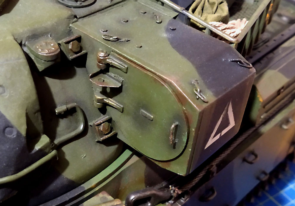

The picture below shows some of the detail added to the front of the upper hull, not least of which is the two Stillbrew armour collars either side of the drivers periscope as well as the new sidelights now complete with working switchable LED lights, cast identification letters and numbers on the glacis plate, and a modified drivers hatch with the lock, latch, and travel stop, etc. Additionally, the drillings for the turret ring bearings are visible here. Ironically (perhaps), the addition of Stillbrew armour to the turret of my Chieftain has made the it much heavier, just as this did to actual tank (by some 2.25 tons apparently). As a precauation I decided to add ball bearings to the face which are supported underneath by a reinforcement ring that i 3D printed earlier. I also upgraded the turret drive ring and gearbox to the all metal versions.....

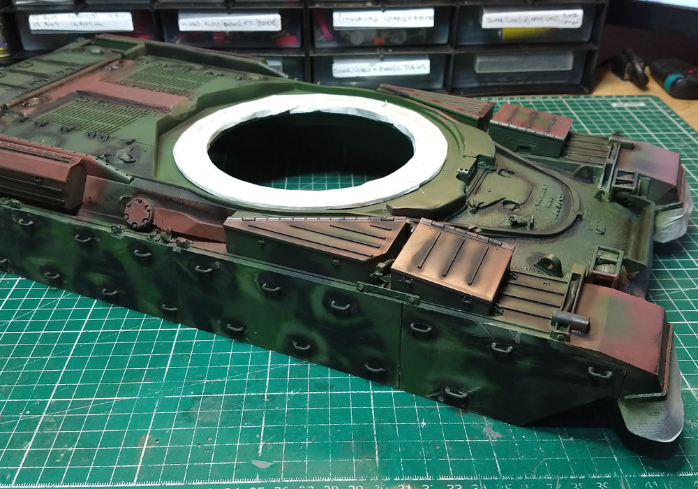

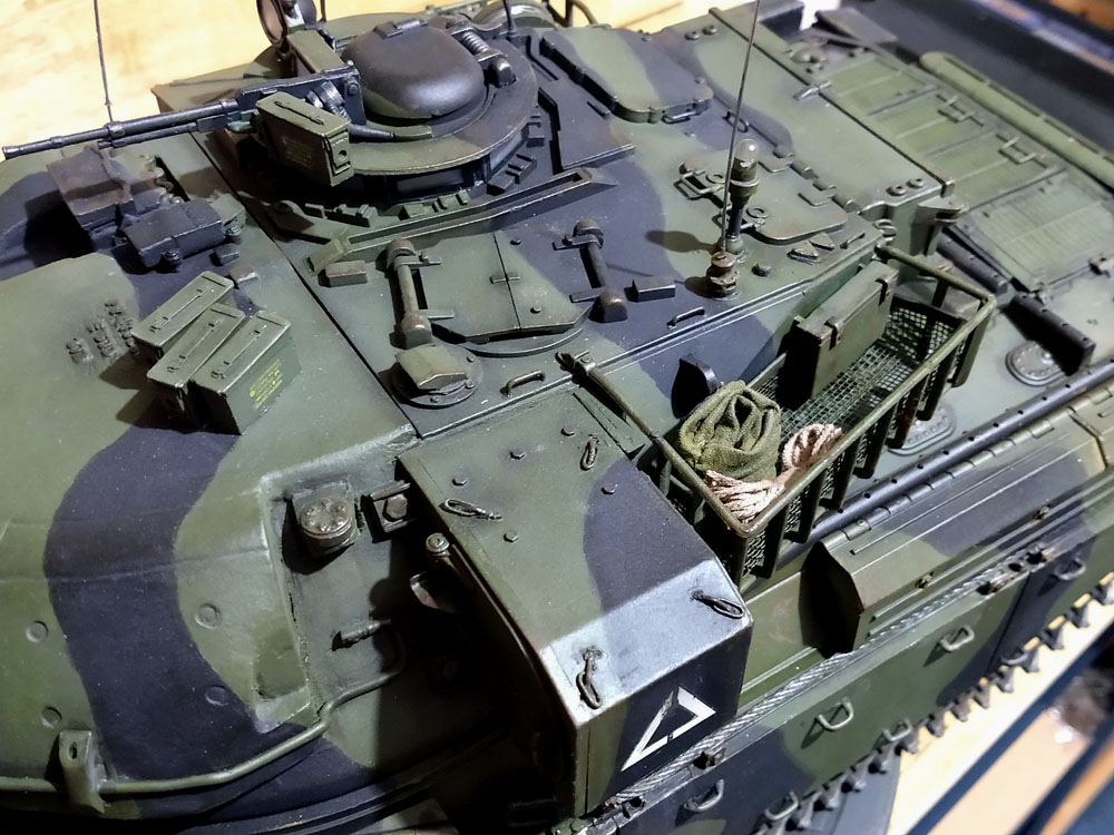

The next picture shows the upper hull primed prior to top coating. Visible here are the nearly 40 8O handles that festoon the 'bazooka plates' (skirts to me). For practicality I used stiff wire sheived with shrink wrap - I just knew that being a working RC model any paint would otherwise wear off very quickly. The glacis plate casting effects can now be seen, as can the mud flaps and the bazooka plate fixings and tow cable fittings (all missing previously). Notice, in particular, the cutaway to the corner of the triangular storage bin, this is not present on the left side bin.......

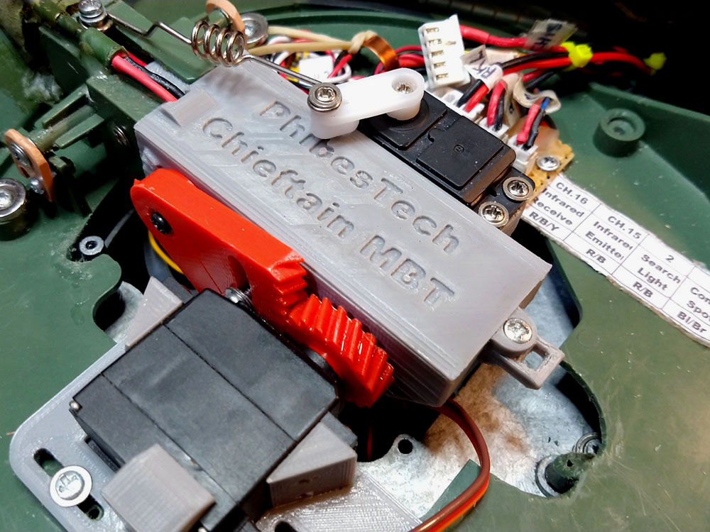

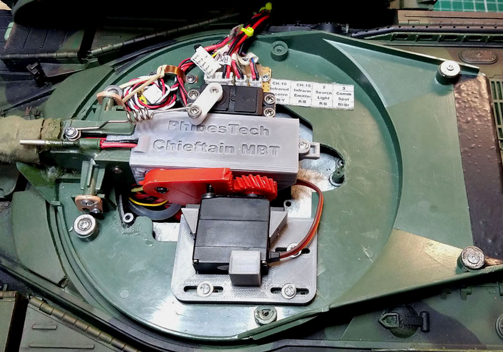

Following on from my first post (and because image number is limited per post) the next couple of images are of the modifications to the turret internals. What I did here, amongst other things, was to convert the Chieftain turret so as to make the upper shell quickly removal using magnets instead of screws. This way, as with many Tamiya's for example, access to the turret internals is very simple and stress free. This makes for further upgrading being relatively simple too.
The next major change here is the removal of the HL BB unit installed by Haya and replacing this with my own design recoil and elevation unit. I designed this to carry inside sufficient counterweights (penny coins actually!) so as to balance the breech with the long multi-part metal barrel supplied by Haya. This worked perfectly and the whole is now perfectly balanced on the pivot mounting. This takes all the stress off the elevation servo that replaces the HL elevation unit that comes as standard on the Haya Chieftain.
The elevation gearing on my unit is fully adjustable and I also made a selection of helical drive gears so as to get the correct degrees of elevation (still playing with this set up). The Haya recoil servo and set-up I simply adapted to fit the new breech unit........

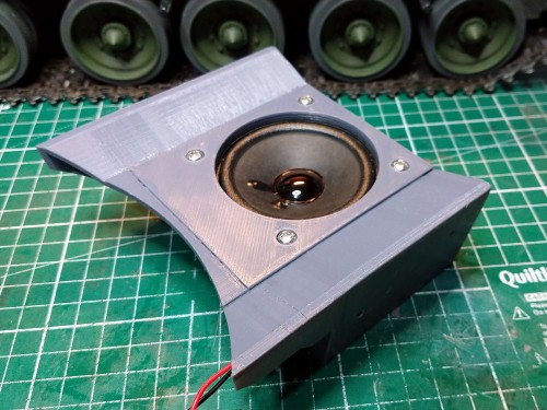

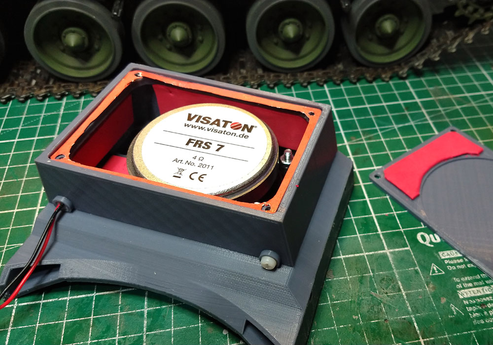

The next two pictures are of something I have been very pleased with (unusually) - a Chieftain specific loudspeaker box that houses a Visaton FRS7. I spend considerable time designing and testing this. The results of my labour, I will say, paid dividends as the sound from the twin reflex port design is excellent. Not only does this sealed unit help increase, measurably, the output from the Visaton speaker but even though I am still running on the Haya TK6.3 (aka HL 6.1s) board separation and detail now picked up through the reflex ports is significantly improved. I think with a Clark TK80 clark board installed (as I am presently contemplating) the sound will be substantially better still. The design, I might add, I have extrapolated over to a similar unit for an as yet un-started T-34/85 project and it works exceptionally well there, even though in that project I am an old Taigen version 1 MFU temporarily installed!......

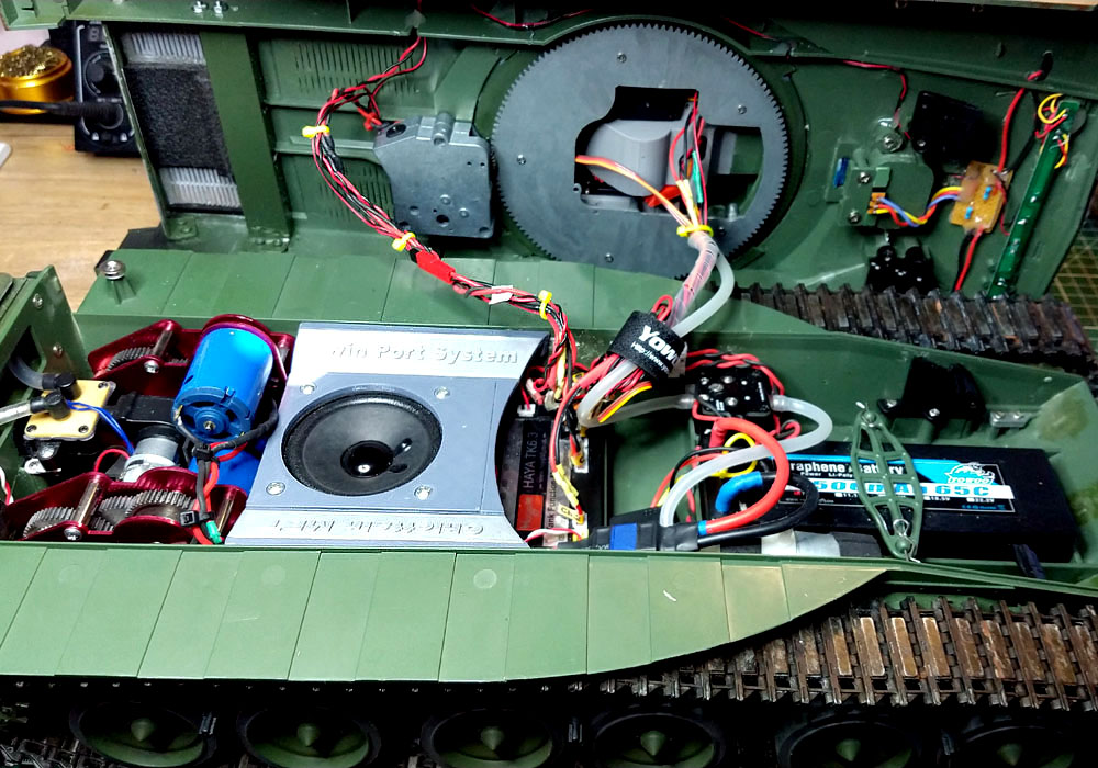

In the next picture can be seen the new speaker installed in the Chieftain hull. The bonus here is that it maximizes available space for the box and also adds greater structural integrity to the hull itself as it is secured to the hull on both sides. I have also installed her the Heng Long 'Ultimate' premium gearboxes which, so far are proving very good, if running pretty hot on extended test runs - the 6500mh Graphene Lipo may play a part here of course! :think:........

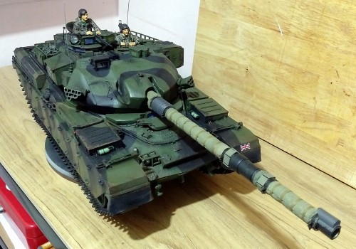

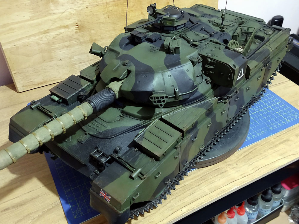

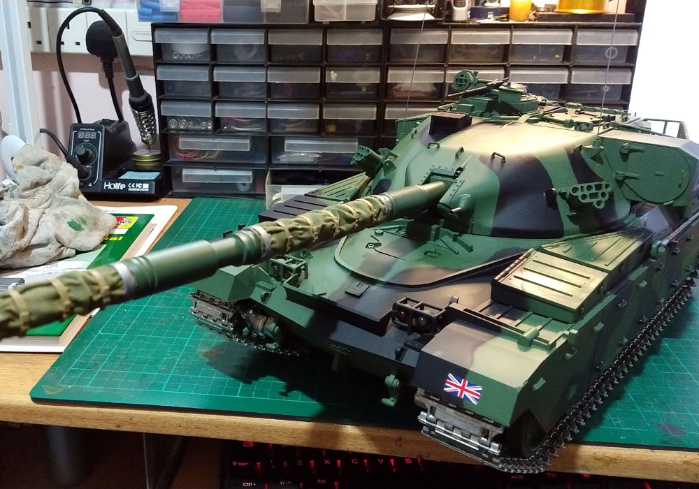

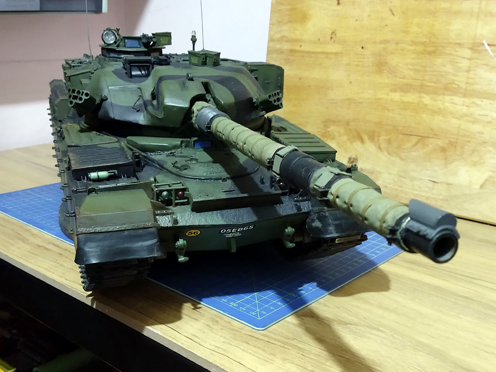

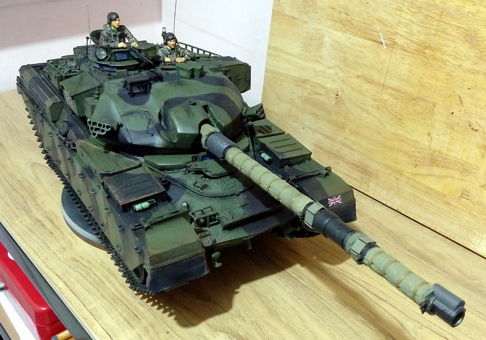

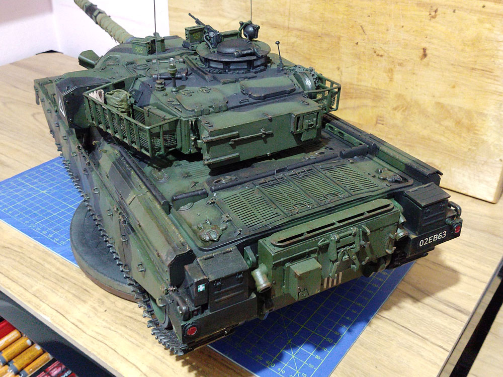

Moving on, then, and back to the finished result (well, sort of) here are the overall results of my Chieftain Mk.3 to Mk.10 modification conversion story.......
I had originally kept to a British bronze green but given that my aim was to represent a late (1987-1990) Chieftain Mk.10 I opted for Nato green and black as was often applied at this time, or so I understand (the British 'Totem Pole' upgrade programme is quite a convoluted enterprise, to say the least}.......

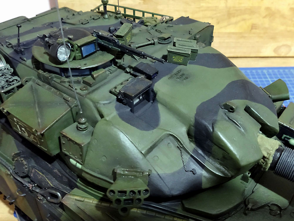

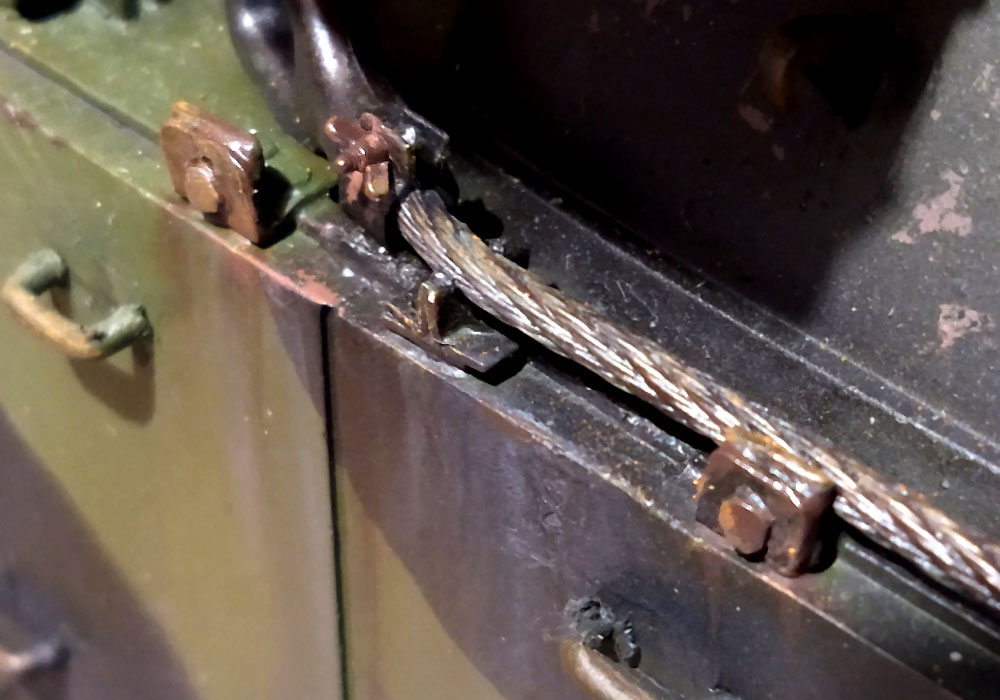

The 'light Projector' as the technical manual referred to it....

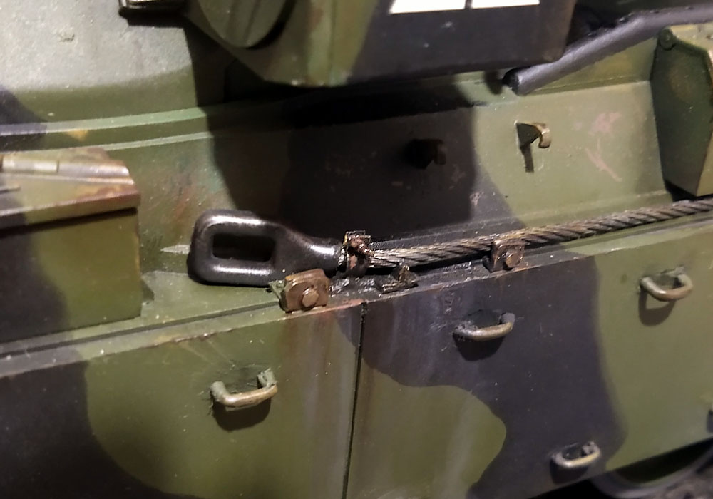

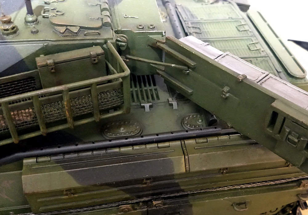

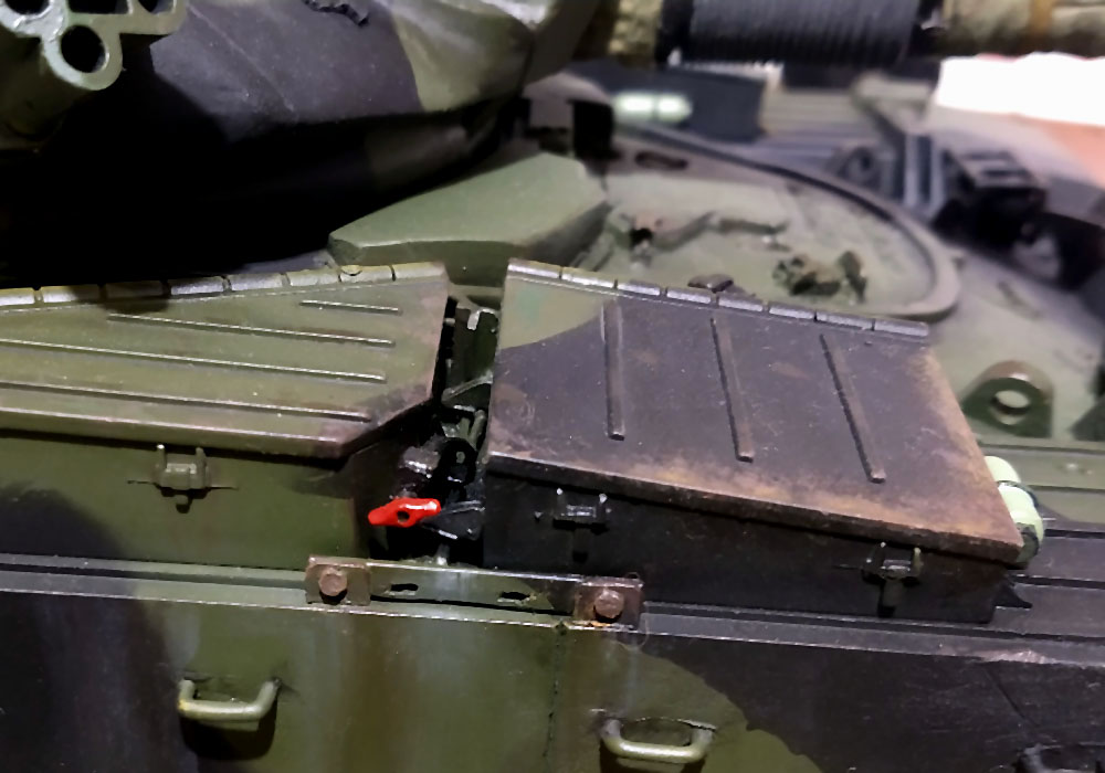

Storage bins, bazooka plate hangers and handles, and damper valve control......

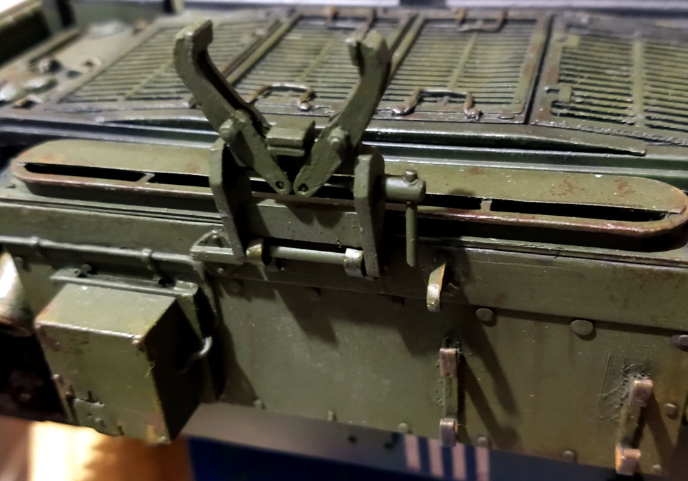

The travel lock is 3D printed from many parts and opens and closes like the original.
The NBC pack I modelled here was based on the few images I could find. This was of the No.6 pack which was the standard Totem Pole upgrade to Mk.5's through to Mk.10 when another upgrade to the No.11 filtration unit was introduced. This externally identical (as was No.3 through to No.5) but internally introduced cylindrical filter units. Needless to say I was at first a little disappointed as this seemed to suggested I had the wrong filtration unit in the NBC pack for a Mk.10 Chieftain. However, I discover that, in fact, not all Mk.10's did in fact receive the No.11 filtration pack.

To say this build is finished is typically incorrect, but at least I have it somewhere near what I imagined as a reasonable rendition of a Mk.10 Cheiftain. This is, though, the end of the first phase, so to speak. I will be tackling other projects for a while but intend to upgrade the electronics, although the Haya/HL 6.3/6.1s is by no means at all bad, and certainlt a huge step up from the earlier RX18's, etc. I further intend to make the turret fully 360 (which it is not at present0 and to re-design the recoil and elevation unit to include a helical gear driven recoil function. ......... It never ends does really does it? :crazy: :D
