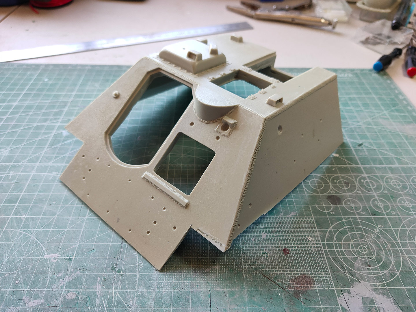

And a truly heroic amount of sanding got the resin fighting compartment down to size.
I suspect the kit was designed with the intent that you'd remove basically the entire T-34 glacis and superstructure sides, but I'd learned from a previous Juckenburg kit that that's asking for trouble. I wanted to retain as much of the ABS hull as possible for rigidity. To help with that, I decided to use M3 bolts to pin the resin kit in place in addition to generous amounts of the gel super glue recommended by Herman, Painless and others.
Starting to look like something!
Sitting the combined upper hull over the airsoft gun, you can see the distinctive low silhouette forming:

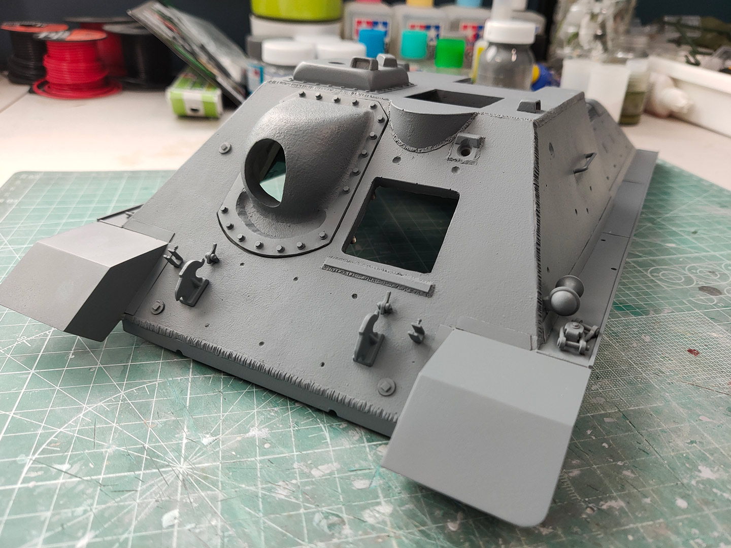

I've been making a bit of a concerted push lately, but I don't have any in-progress photos. Here's where we are this morning after a few thin coats of automotive primer:
You might have noticed that the mantlet housing is an almost completely different shape. I'd estimate that I probably removed about two thirds of its mass hollowing it out and reshaping the front to fit a workable elevation arc. It's been reinforced with styrene internally and detailed with Tamiya putty and Meng bolts externally. The amount of dust this kind of work generates is tremendous, I'm glad we don't have carpet!
Mounting the airsoft gun and allowing elevation was tricky and required a little bit of maths, a lot of plastic cement and even more luck. From left to right, these three pieces mount the mantlet to the airsoft gun, mount the airsoft gun to the hull and act as a hopper for BBs.
Everything mounted and removable in case of repairs or upgrades. Note the upside-down hook on the back of the airsoft gun to make up for the low ceiling height.

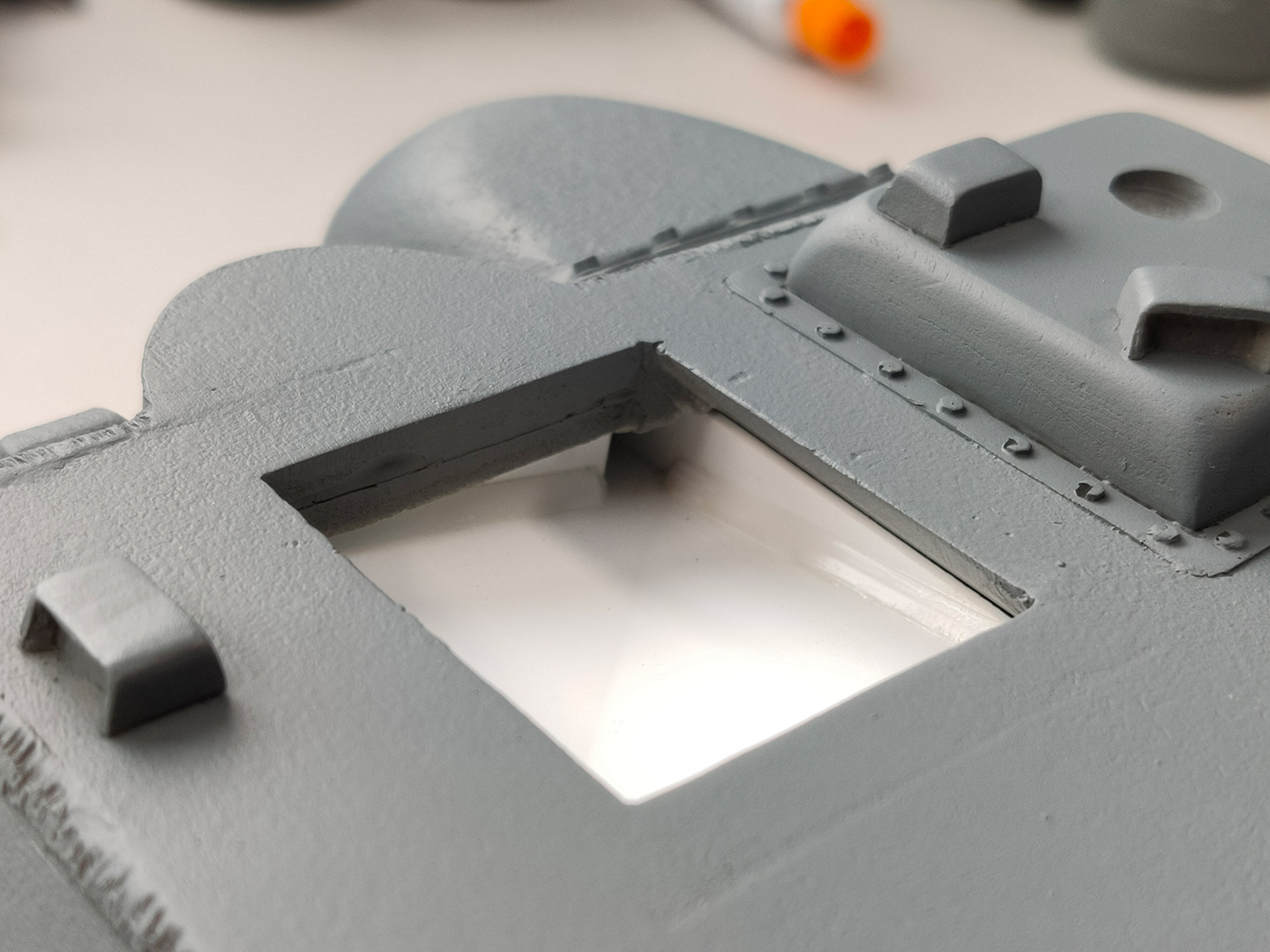

A view into the gunner's hatch showing the chute that feeds into the mantlet housing. I've test-fired the gun a few times and everything works.
