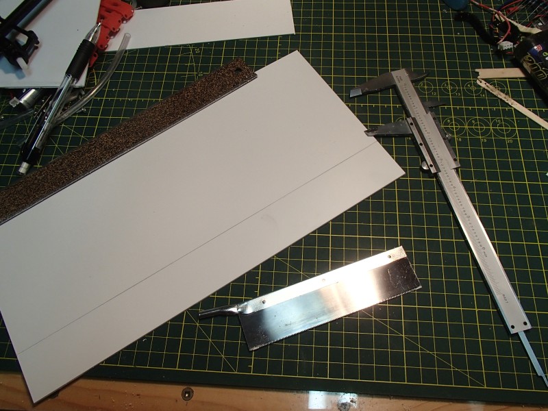

Maybe a Proxxon 37006 KS 115 Bench Circular Saw or similar...
Just a old school Vernier caliper for measuring... No fancy digital here.
Read the graduations! READ THEM!

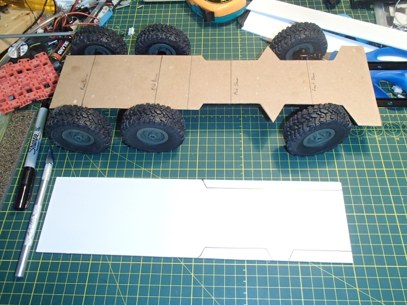

Basic straight lines are pretty simple, but when I start having to do coping or more intricate details.
Layout is key for me. Make a simple template, go scissors!
Thankfully I have an ample supply of cardstock for layouts.
And way more from my place of employment. (They literally throw these away!)
