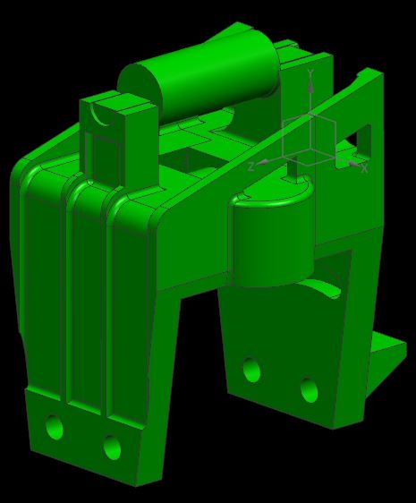

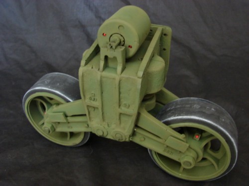

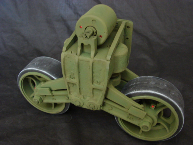

Regarding the design of the bogeys. (and yes I've seen the original pre-primed, pre-installed components).
They are a 2 piece design. They reuse the following components from the HL factory bogies.
  • Swing arms
  • Swing arm pins
  • Return roller
  • spring
Since they use the original swing arms, you can use the stock road wheels and axle hardware, but I think Dean's spoked wheels are nifty looking (I'm not a Sherman connoisseur).
They are a 2 piece assembly that are printed in different orientation (to prevent common shear planes from the printing) and are assembled prior to mounting on the hull.
You do need to shave down the HL hull mounting pegs however, and it is secured by a SHCS from inside and the bottom.
The question will be if they survive metal tracks and the added mass to the overall tank (and life time/durability).

One question, are these bogies going to have the fake volute springs moulded on their sides on the final print?
Ah, I think I'm going blind, I just looked again, I believe I can see them lurking in the shadows :{
Jarlath
Posts: 413
Location: Ontario, Canada
Re: 3D printed M3 LEE/GRANT running gear early
Post by Jarlath »
Son of a gun-ner wrote:One question, are these bogies going to have the fake volute springs moulded on their sides on the final print?
Other than the cast cups for the springs, there are no additional spring details. They would be too flimsy for FDM printing and would likely break during assembly of the components.
The bogies themselves are made from ABS, hopefully Dean gets around to beating the hell out of them and we can examine for flaws and durability.

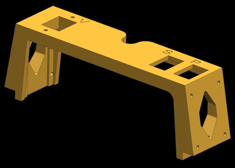

I'm working on his MATO Sherman innards right now for adding in my wiring clean up and internal arrangements. Dean is the artist for details and paint, I'm the builder for electrical and mechanical :)
The Switch Bridge for the MATO that will have power, smoker, and volume controls situated under the front hatches (which of course open).
Bridge itself can be glued, screwed, or use 5mm x 3mm magnets (qty 4) to hold in place.
