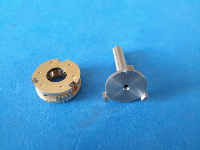

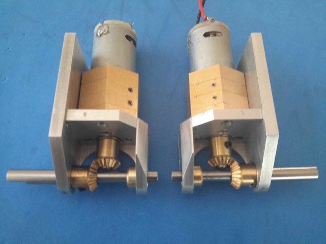

Drive shaft and drive cage.
IMG_20191107_110513 (2) (Small).jpg (86.86 KiB) Viewed 9578 times

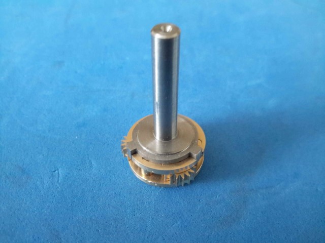

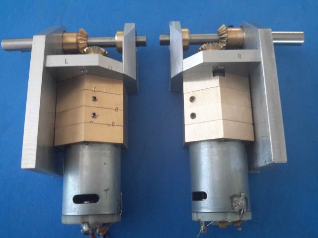

Another view.
IMG_20191107_110553 (2) (Small).jpg (77.67 KiB) Viewed 9577 times

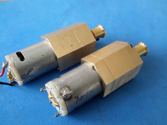

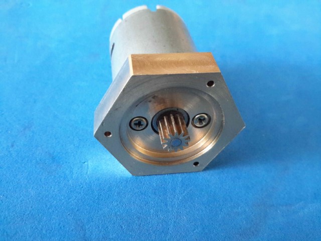

Finished motor end.
IMG_20191107_110622 (2) (Small).jpg (90.2 KiB) Viewed 9576 times

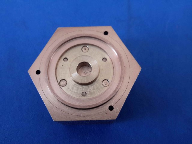

Ring gear segment with gear cage.
IMG_20191030_104721 (2) (Small).jpg (62.74 KiB) Viewed 9575 times

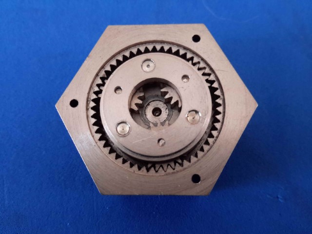

Finished gear box with 3 gear cages 5:1,4:1,4:1
IMG_20191116_113731 (2) (Small).jpg (66.46 KiB) Viewed 9573 times

Other side
IMG_20191116_113745 (2) (Small).jpg (59.57 KiB) Viewed 9572 times

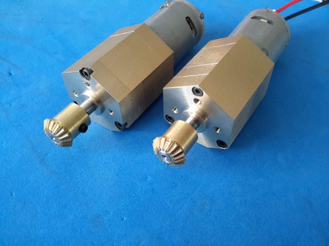

Complete gear box in its housing. This photo shows gear box with two gear cages.
IMG_20191230_100725 (2) (Small).jpg (74.67 KiB) Viewed 9571 times
