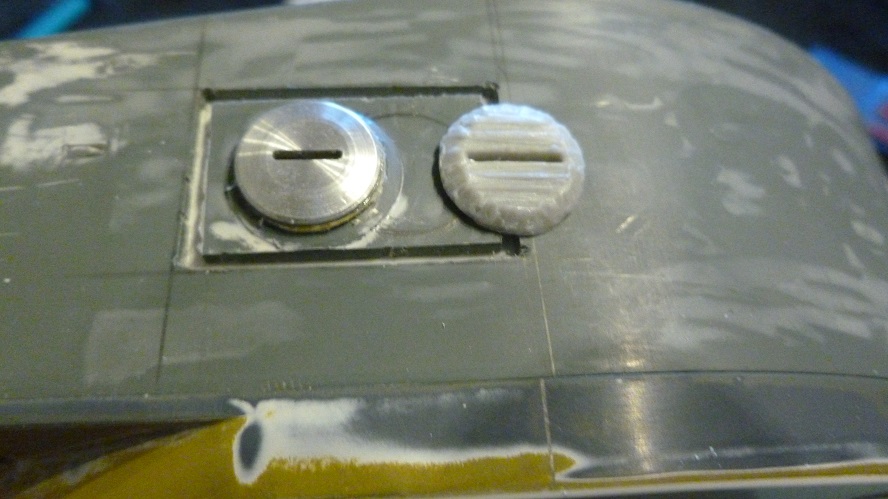

The last job was to swop the metal vision ports purchased from Tank.Modellbau.De for the resin ones from the Attak Zimmerit kit. One thing I picked up from reading Sov's Tiger Build was David Byrden's advise that there were two width to the actual slot cut into the steel plug for viewing. The Early type has the slot running to the edges to the inner flange, the later type were slightly wider. The picture below is a pretty good comparison, as you can see the slot on the later model plug is wider.
Early vision plug left and later wider vision slot on right.
So once the resin Attak version was bonded on it will be a case of filling gaps with Milliput once I have completed all the Turret modifications.
