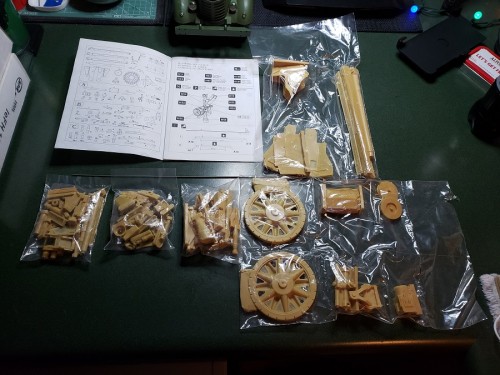

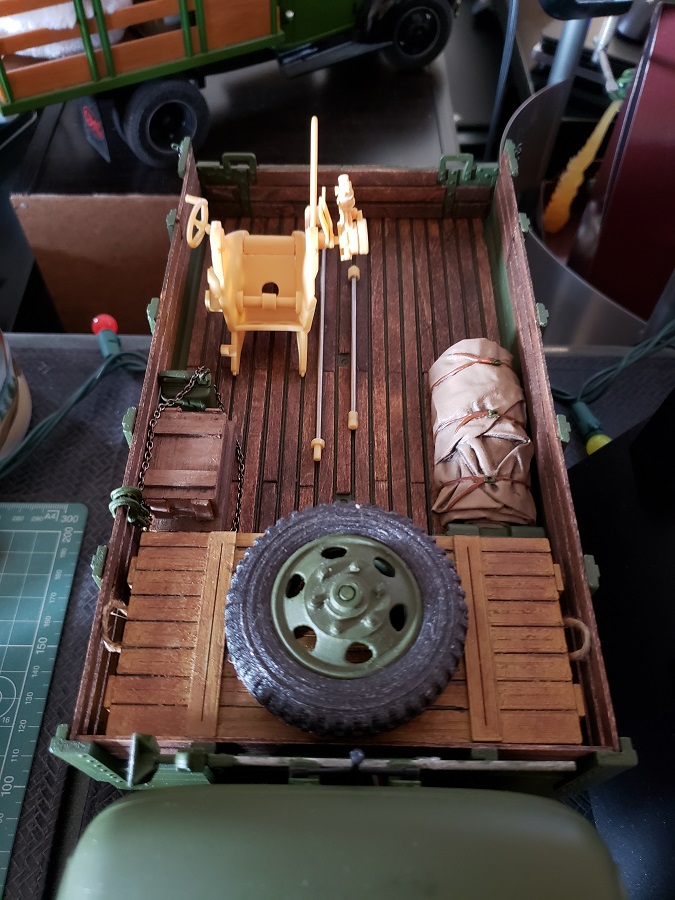

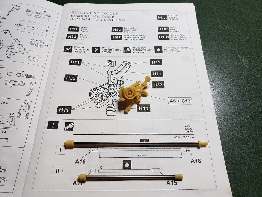

I finally got the 44' International Harvester KR-11 Lend Lease truck completed so now it is time to work on the Field Piece that it will tow. I remembered when I opened it up that it was a cast resin kit. The manufacturer is MPM and it is certainly intricate with _lots_ of small parts cast with _LOTS_ of base material requiring removal. After removal of finger prints and a nice slash on the left index finger, I have worked out a process and have the right tools to safely remove all that extra material. I will be following up with pics and progress updates a lot quicker than I did with the truck. The kit is 1/15 in scale but who knows what scale the JJRC base truck actually is ( I think it is 1/16 - 1/14 ) so this gun will not look out of place being towed or sitting next to the truck in the tank area. Pics: ( Click to Enlarge )

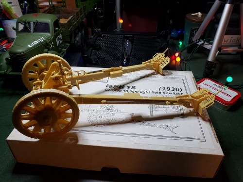

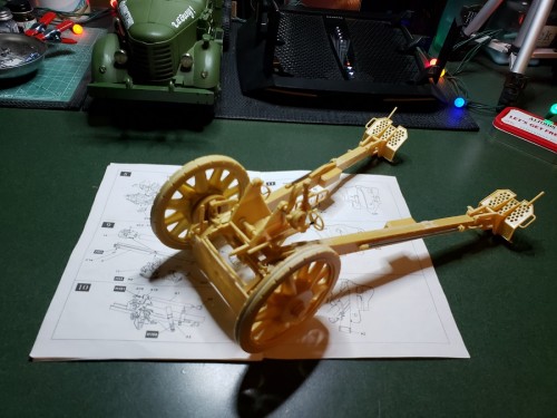

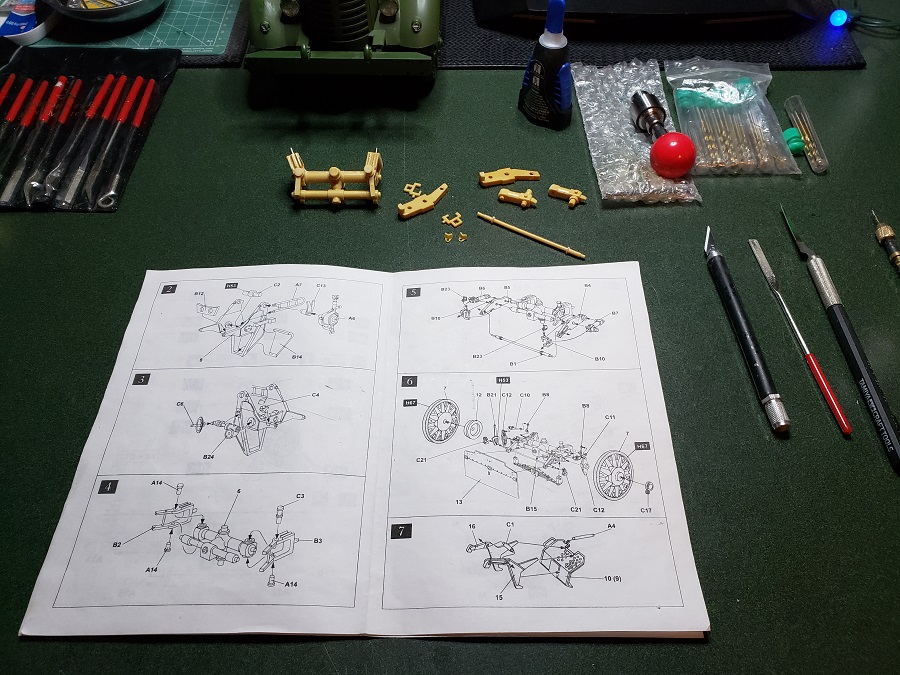

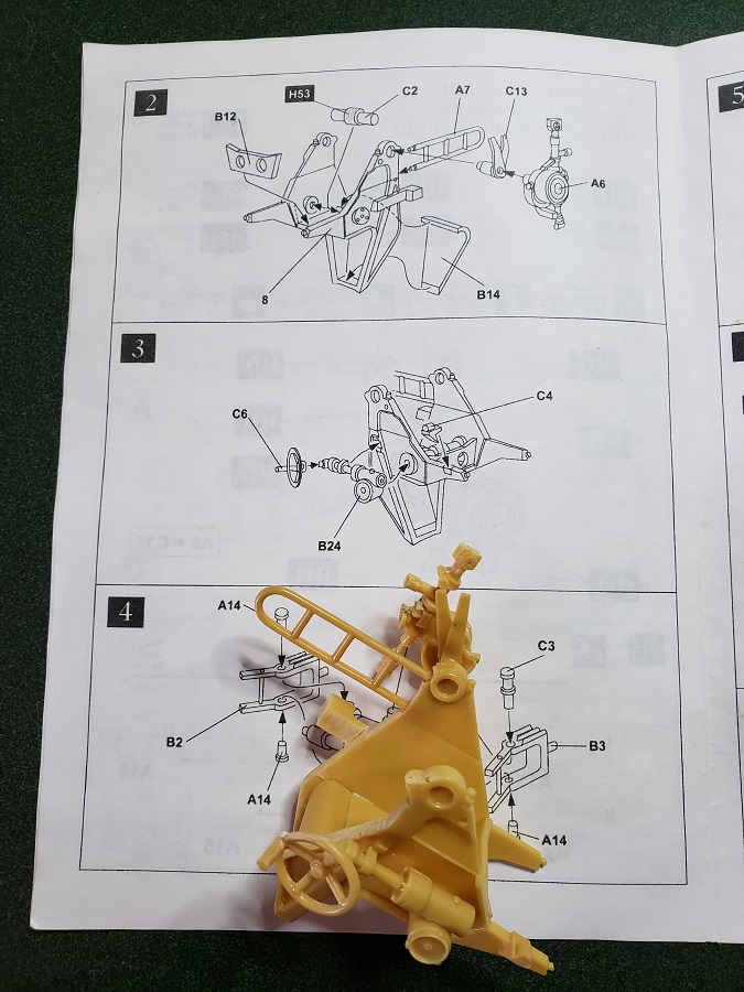

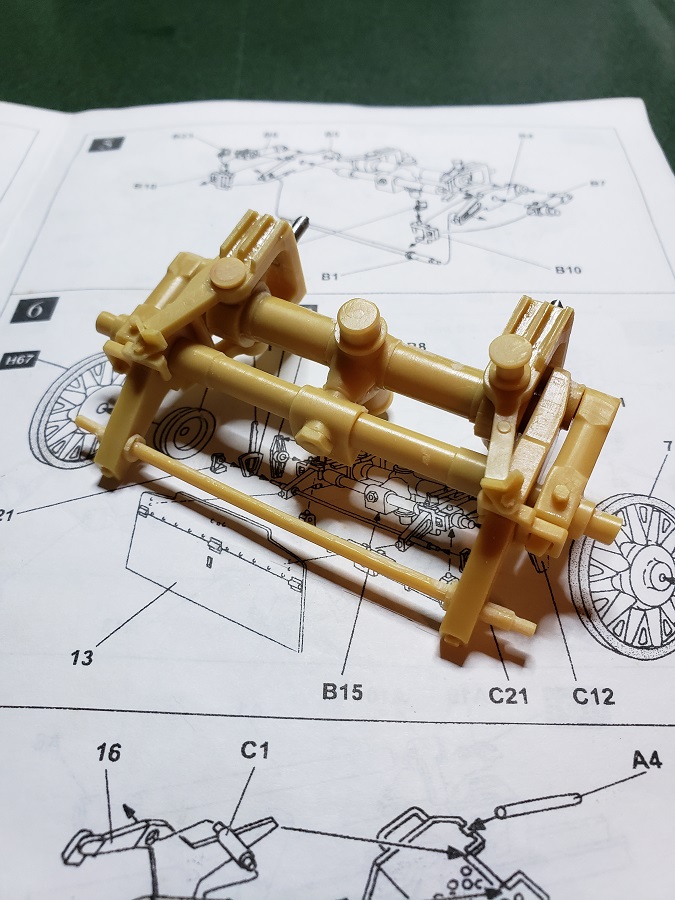

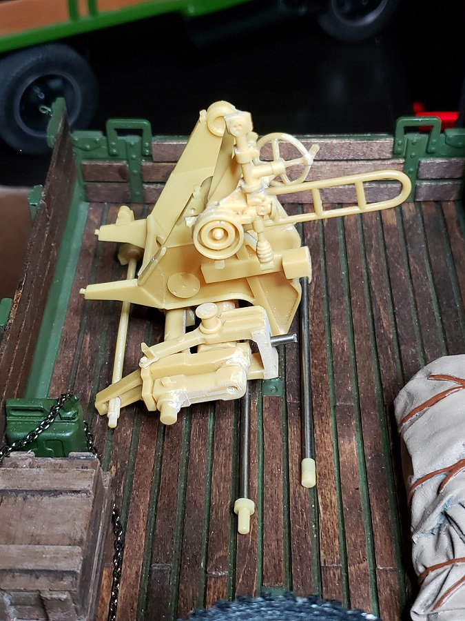

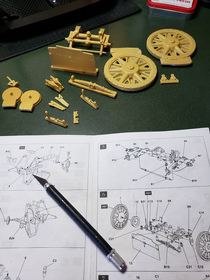

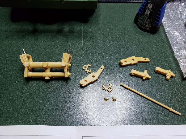

Another night, another drill bit in the ol' index finger. ;o) Tonight saw steps Four and Five completed. Thank all the Powers for the Tamiya flexible plastic saw. I might make this assemblage of old resin into a Field Piece yet. Again, the base material covered up pegs meant to mount other parts. Fortunately, I have a goodly length of that metal rod left that came with the kit. Pics: ( Click to Enlarge )

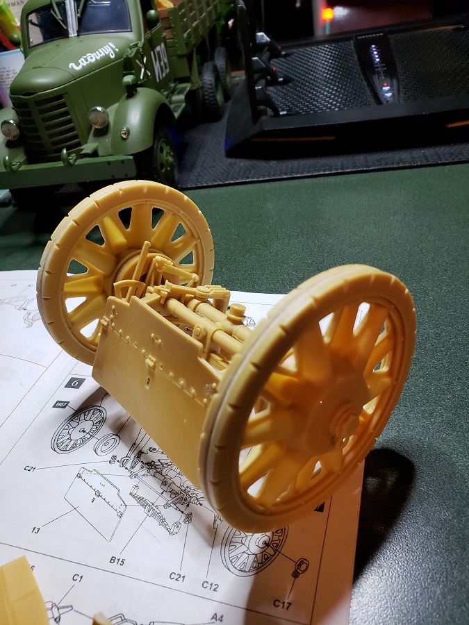

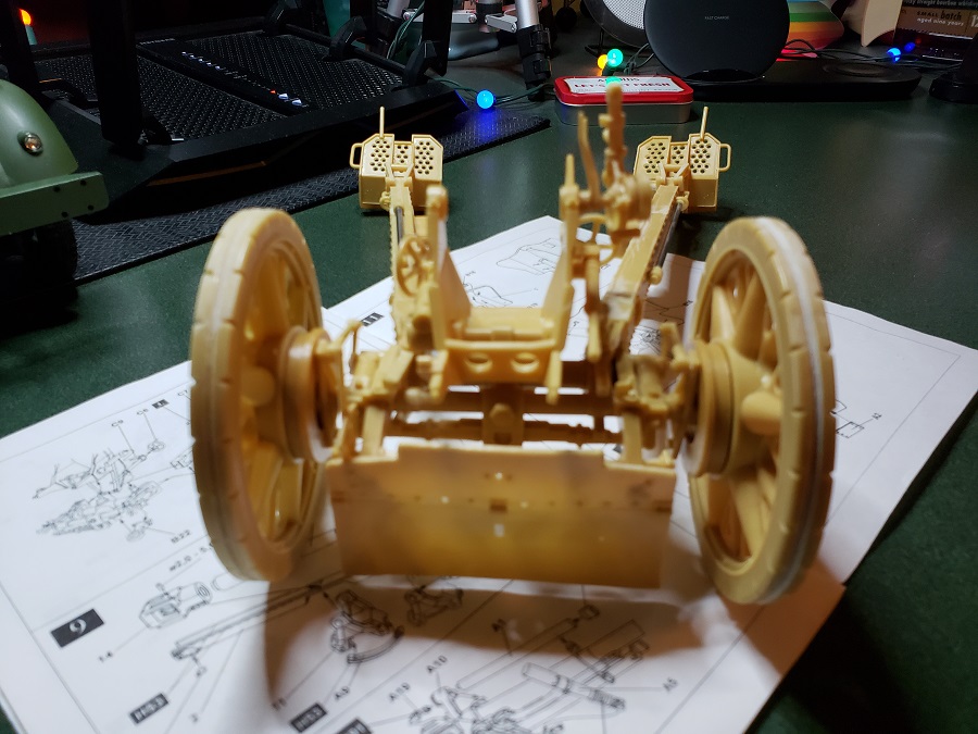

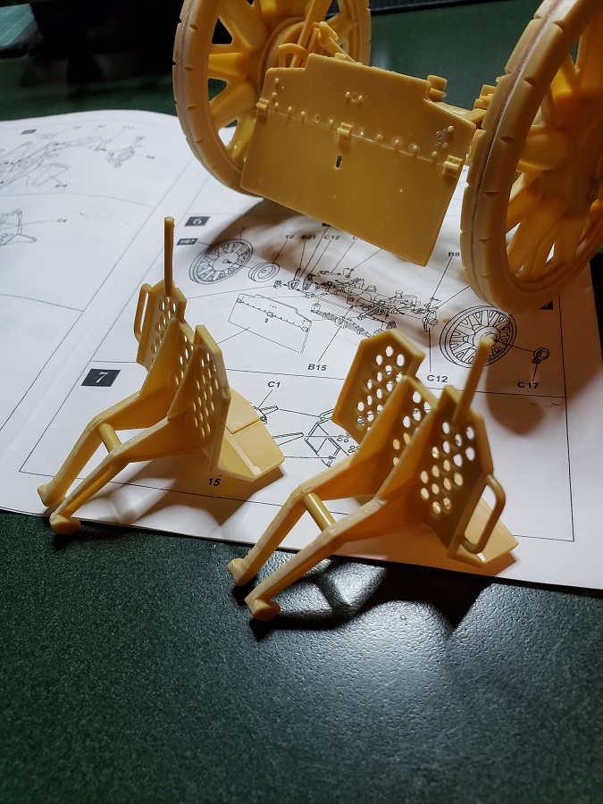

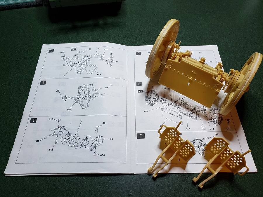

I was able to spend sometime working on the next two steps ( almost was just one but I'm thick headed that way ) today. Some head scratching on how to let the wheels go round and round was needed. A little careful drilling and some machine screws provided the answer. I want as many of the parts on this model that are supposed to move, move like they are supposed to. Aside from going crazy in brass ( no offense, Barry ;o), I think it will be functional enough. My fingers are cursing me roundly because of all the resin I am removing ( which is slowly removing the tips of my fingers as well). Pics: ( Click to Enlarge )

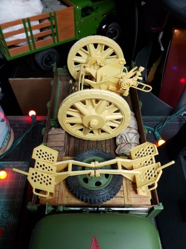

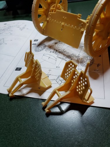

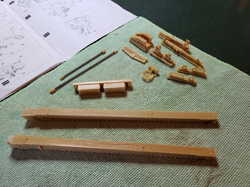

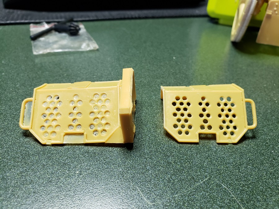

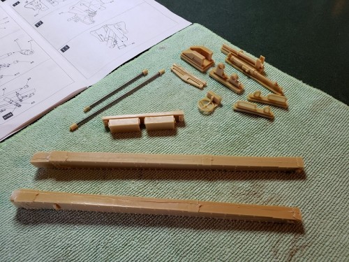

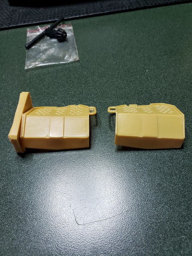

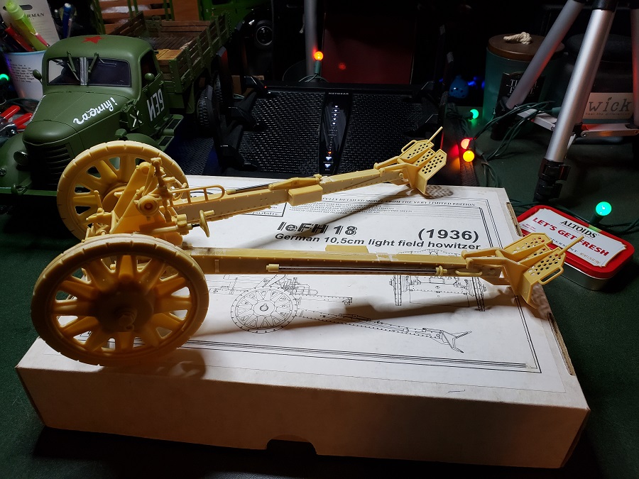

I jumped onto the build tonight expecting to knock out a couple of critical steps, 8 and 9. Well, four hours later, Step 8 was done. The large pieces for the gun trails were soaked in extra resin and some of the small boxes required extensive cutting and sanding and cleanup as well. At least we have caisson tonight. I should be able to start priming and painting within a week. I will be satisfied with that. Pics: ( Click to Enlarge )

That looks great, Painless. I would highly advise that you use bearings on that axle. Resin doesn't wear very well.

This kit was designed as a display model. I have had to do a significant amount of drilling and pinning to get parts to move so that I could have a towed form of the Gun and a dug in\ready to fire version. The wheels were just stub and hole mounts suitable for gluing together. I drilled all the way though and made a screw channel out of epoxy. The axles are now small carriage screws. This is good resin but as you say, resin is still resin. I don't anticipate a lot of use outside of the odd video and static display but if that ever changes, I can remove and install bearings with this new setup.
