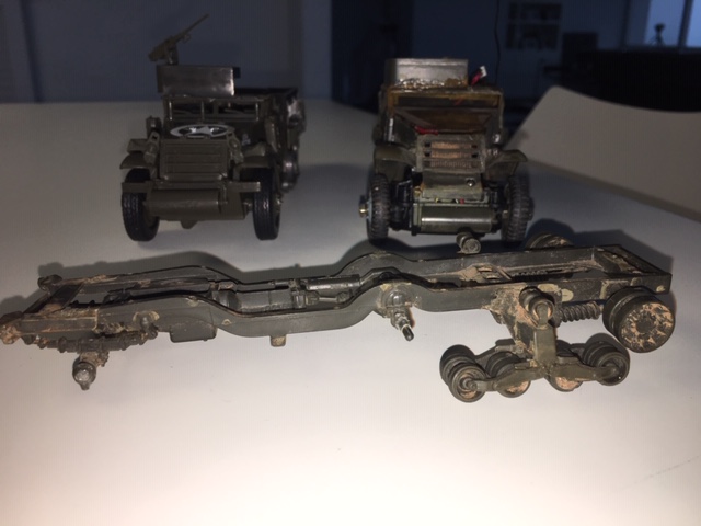

oh look, this goes here!
Testers donar model from the drugstore.

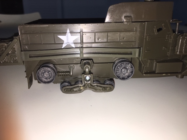

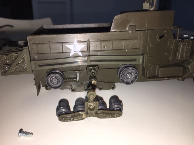

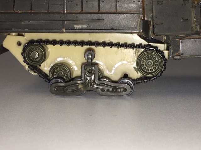

How convenient, this road wheel suspension is easily removable with one screw!

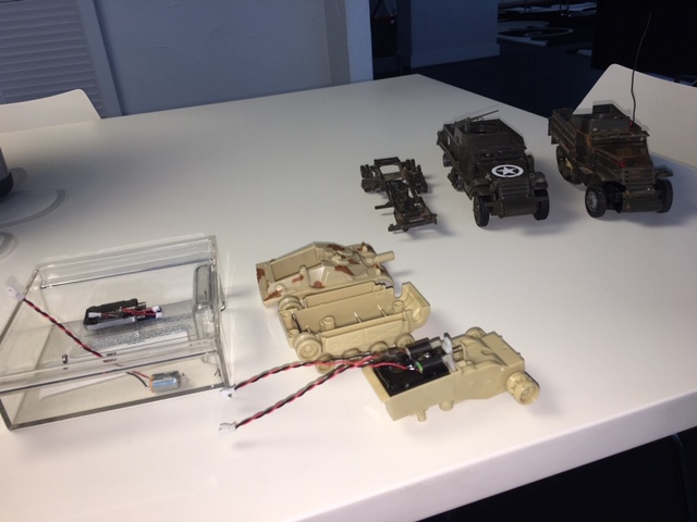

This is the duplicate of the gearbox I am using currently in the M3.
Original chassis. getting close to the point where I can motorized this scale chassis.It is just a matter of time.

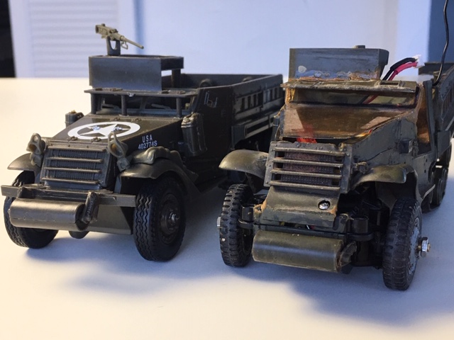

The HT on the left is a Newer Testers kit which is actually pretty cool but it will be used for parts for the 1972 Tamiya vintage model.

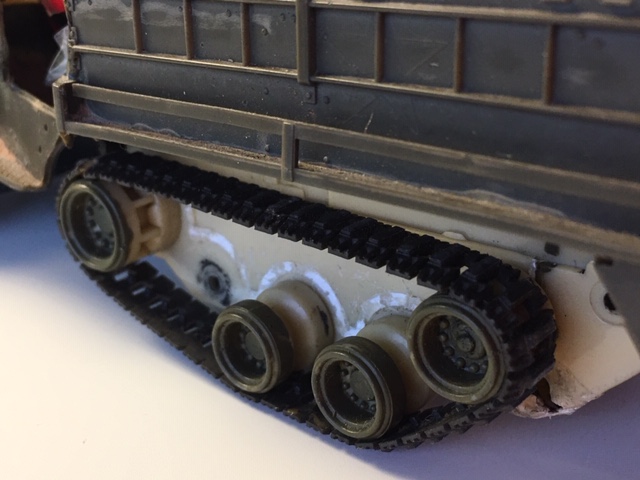

recently was able to get the stock Tamiya tracks to work. I am still working on the road wheel situation but it does work good and has very good track stability.

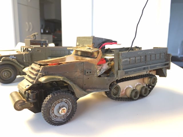

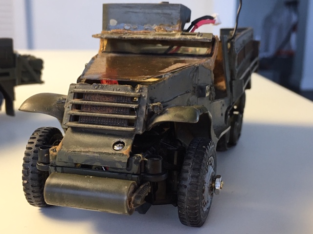

I built this Tamiya M3 HT model in 1984 and tried on and off for a few decades to motorize it. Finally in 2002 managed to get it moving under its own power without throwing a track every few feet.

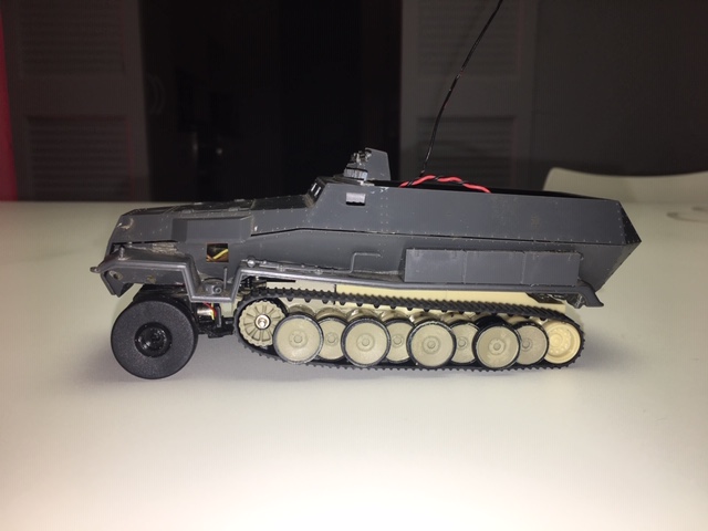

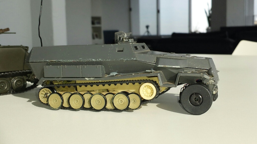

I am working on a Hanomag Halftrack today...Started this model in 1984 and thought I could make it RRC lol.. well it has taken a while and I think finally it will get done and look pretty close to scale...at least enemy silhouette standards lol 8O
I have had many different drive setups on this model but none looks scale or even close to scale due to the unique road wheel offset pattern of this and all German Half tracks.
You are not likely to see this 1/35 Hanomag model as a Radio Remote control model or even simple single motor "motorized" because it is impossible to do on this small scale and complicated staggered road wheel configuration.
This is a twin motor configuration with 1 motor per track wired in series to emulate a live axle. With a single motor driving both tracks, the steering would be very poor.
Still working on the track chassis but this is closer than it has ever been.I am tired of working on it for now so and will work on something else for a while. I will do a video of it running on the table asap.

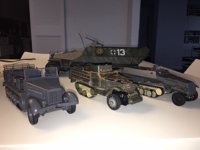

Half track fleet so far..

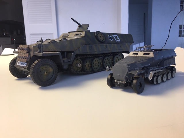

I am using this Century 1/18 Hanomag RRC model as a build reference for the Tamiya 1/35 model.

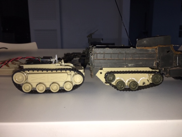

you can see the difference from this picture of the previous chassis work. The tracks were unstable with this configuration as well.

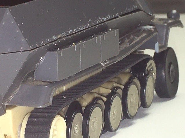

Latest chassis improvement includes moving the rear idler wheel up higher than the road wheels. The drive sprocket is also a bit higher than the road wheels and looks more like the correct stock position. So Drive sprocket and idler moved up higher than the road wheels now.
Completely redone the track chassis
