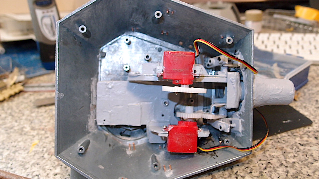

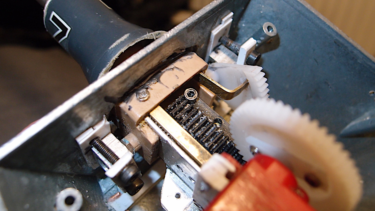

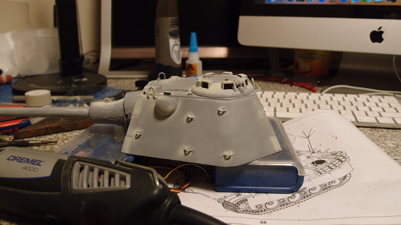

Recoil and elevation setup. The top of the mantlet is wrong shape if you want +15 and -8 or +20 and -10 degrees for the elevation/ depression and fit the debris guard . Going to reshape the mantlet, its RC so getting the mechanics correct is a must before getting everything else done. Found out recoil was 420mm ? so thats 26.25 scale, had to fit a larger cog for the recoil travel.
Mantlet will foul the debris guard.
checking elevation.
checking elevation.
checking depression.
Debris guard is pushed up .  Recoil mark barrel should be out another 1 or 2 mm better have another servo adjust.

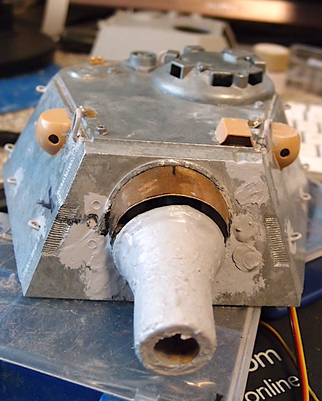

Thinking the mantlet was designed by the person who done the JP one . Going to make one and move gun pivot position . Pictures are worth a thousand words and save rambling on about the build.
Will this work.
Will this work.
No turning back now
No turning back now

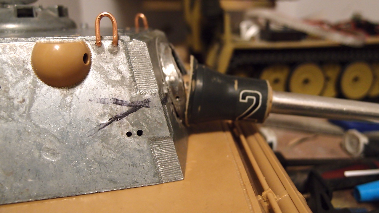

Need more space , cut away some of the front
Reshaped gun mount to a curved section
Pivot points further out and bearings in a square housing.
cutting angles in mantlet
Top is good can fit debris guard
Some filler to hide the lines and then Mr Surfacer
Gun pivot point 10mm forward ,  bearings in housings easy to fit

:thumbup: :thumbup: I'm particularly impressed by the elegance, and simplicity, of the micro-servo recoil solution, Ronnie. o- Your arrangement could also be a good fit for my Comet :thumbup: Cheers!

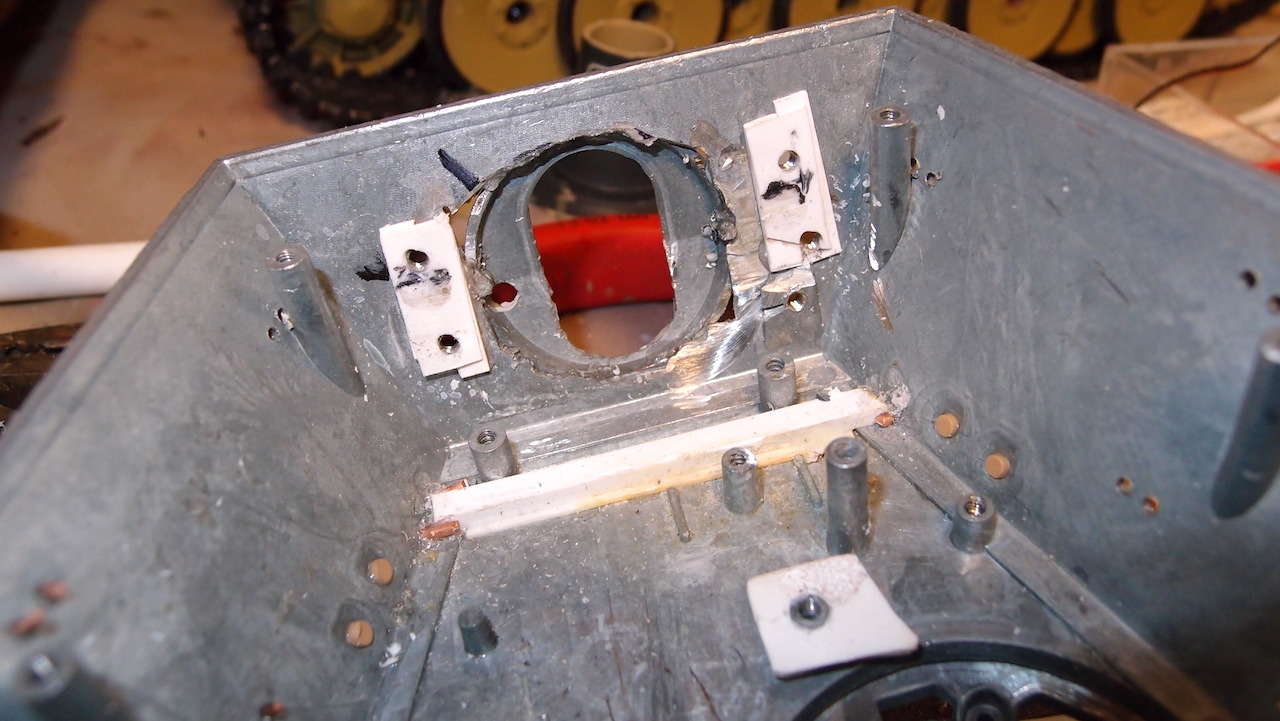

Turret done , fixed mg has no guard over mg hole , no gunners sight filled in and made new gas brackets plastic ones far too thick .
Front fixed.
Front fixed.
brackets look scale now
fixed elevation servo gear position.

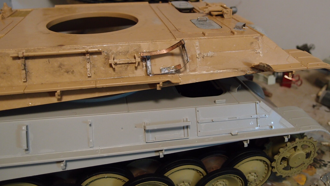

Now the turret is fixed lets unfix the upper hull. Started the brass work , going for hull side damage . The F was a paper panzer , so war drags on and fighting in villages and towns lasts until late 46. Will have turns damage , corners etc. 1st up the jack block holder.
Urban damage.
Urban damage.

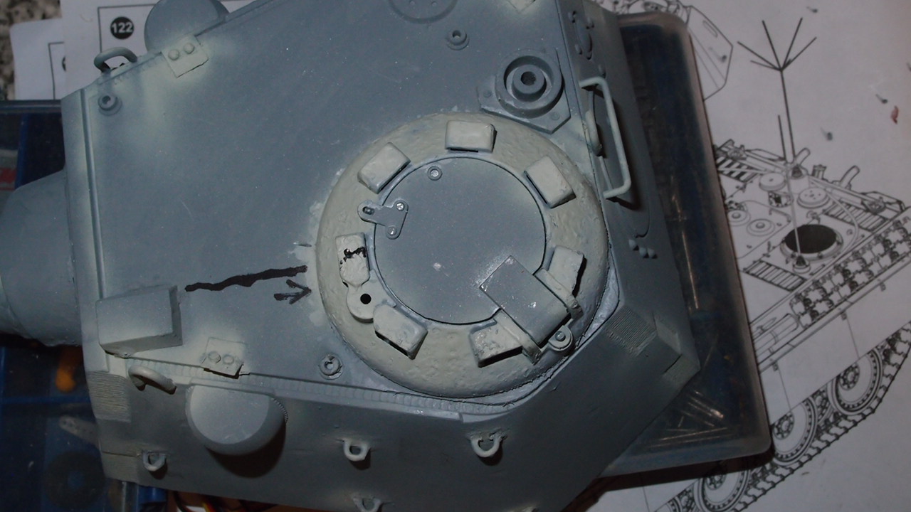

This is another fix required ,don't like the shadow. Will move cupola or reshape to turret roof edge . Couple of pics on web show rear and cupola appears to be on the edge of roof.
Shadow cant be correct
ronnie42
Posts: 834
Re: Panther F
Post by ronnie42 »
moved it cut half the locating lip away.
no shadow sits just on edge of the 3 sides.
refitted
refitted
