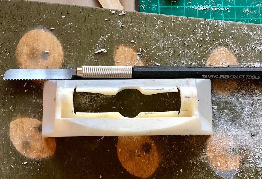

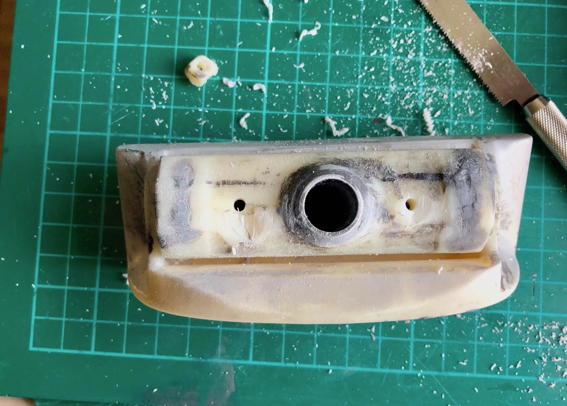

Well, I have the mountings, finally. The gun-holding mantlet now moves with ease :thumbup: Phew...what a pain >:<

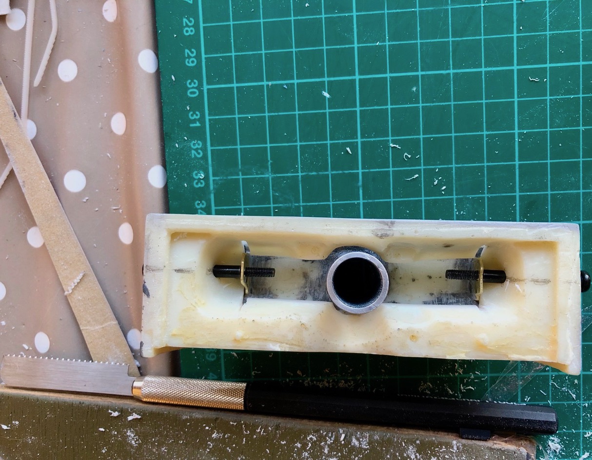

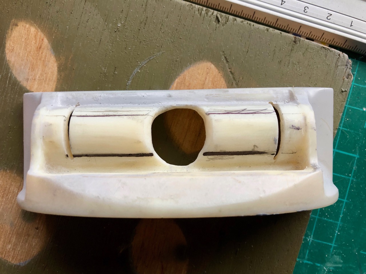

I'm using Mato Tiger 1 axles for the trunnion pivots/swivels. Finally, by using dividers, rulers, and No. 1 eyeball I located the optimum position for the pins in this setup.
Comet mantlet housing-Before...
Comet Mantlet Housing- post-operative...
...and with the Mato Tiger axles fitted ( but not bonded in yet)
Comet Mantlet Trunnion Pivot pics...
Mantlet trunnion pivot-detail...
I'm happy with the outcome so far. :) Why? well:
1. The assembly is now more like the real deal, in principle, anyway,
2. It actually moves smoothly now, and should allow about the right amount of barrel elevation and depression. :thumbup: Should being the operative word...
The mato axles will be shortened on the outside, to be flush with the mantlet surface. That's after being bonded in place with JB Weld metal epoxy.(Great stuff!!)
I could put bearings on the inboard shaft, an lock them in place with nyloc nuts. or, I may just use a nut and washer.
Overall, coming up with this solution has taken more time, and more patience than any other part of the project. But, semi-scratch building being what it is, it would surprise me one little bit (een lutte beten in Platt Deutsch)..if some other conundrum crops up to top this one for frustration. >:< :lolno:

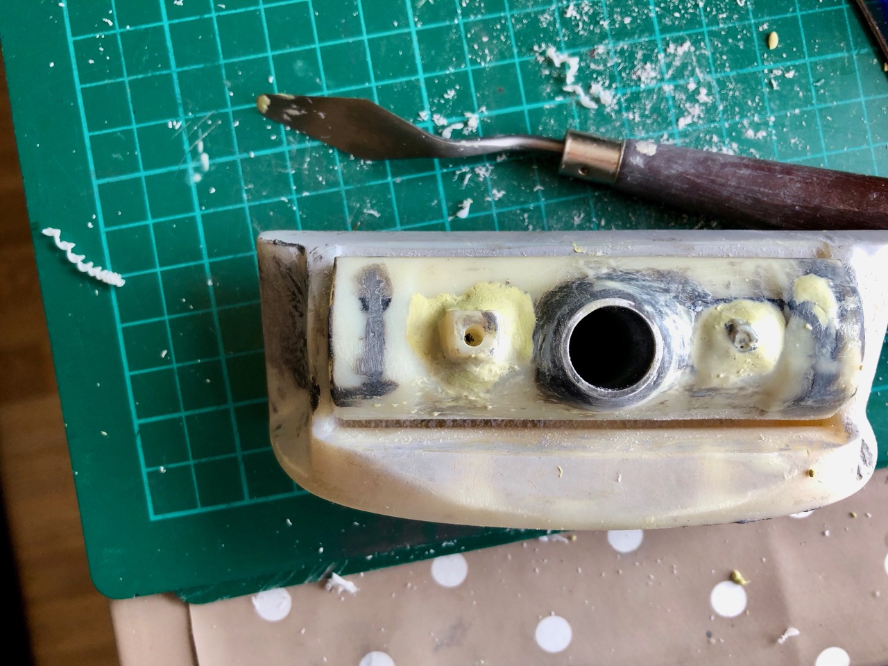

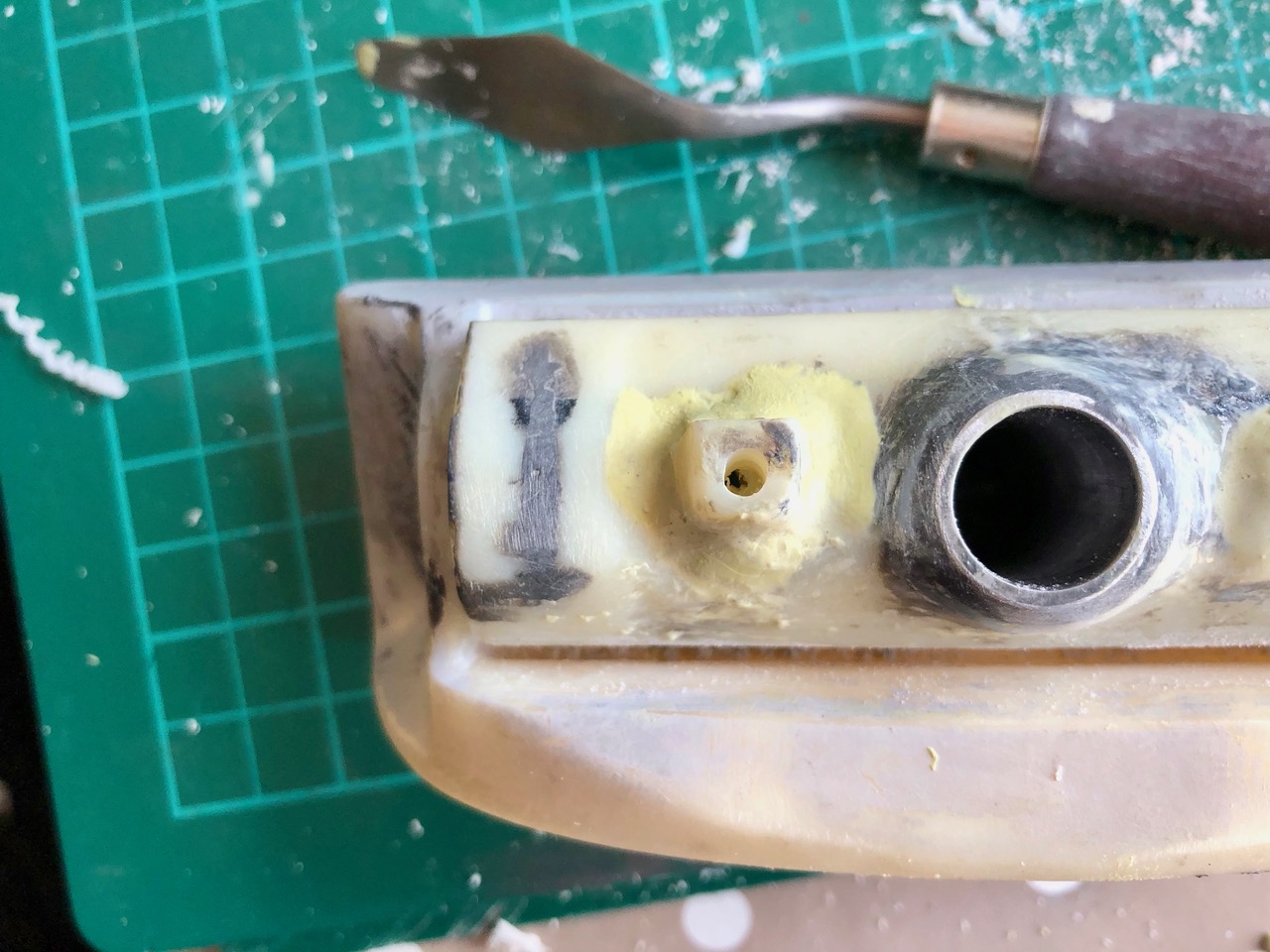

Right, well, getting the mantlet to elevate smoothly has boosted the old endorphins. Now, I think I can move the MG and optical sight without ruining the resin. I just have to cut them out, carefully, and replant them in the correct positions using Milliput. First, I'll drill the holes that will allow a light-emitting MG to be fitted, and maybe some ersatz lens for the optical gunsight.
As ever, click to ENLARGE the pics :thumbup:
Moving the Mantlet MG-pic A-Before surgery
Relocating Mantlet MG-pic B-excising MG and optic
Relocating Mantlet MG-pic C
When the Milliput base for the relocated MG, and optical sight, has cured, I'll sand the Mantlet to get form the most credible of contours. I may even bring the MG out a little further.
Correct position for MG housing and Optical Sight housing.
