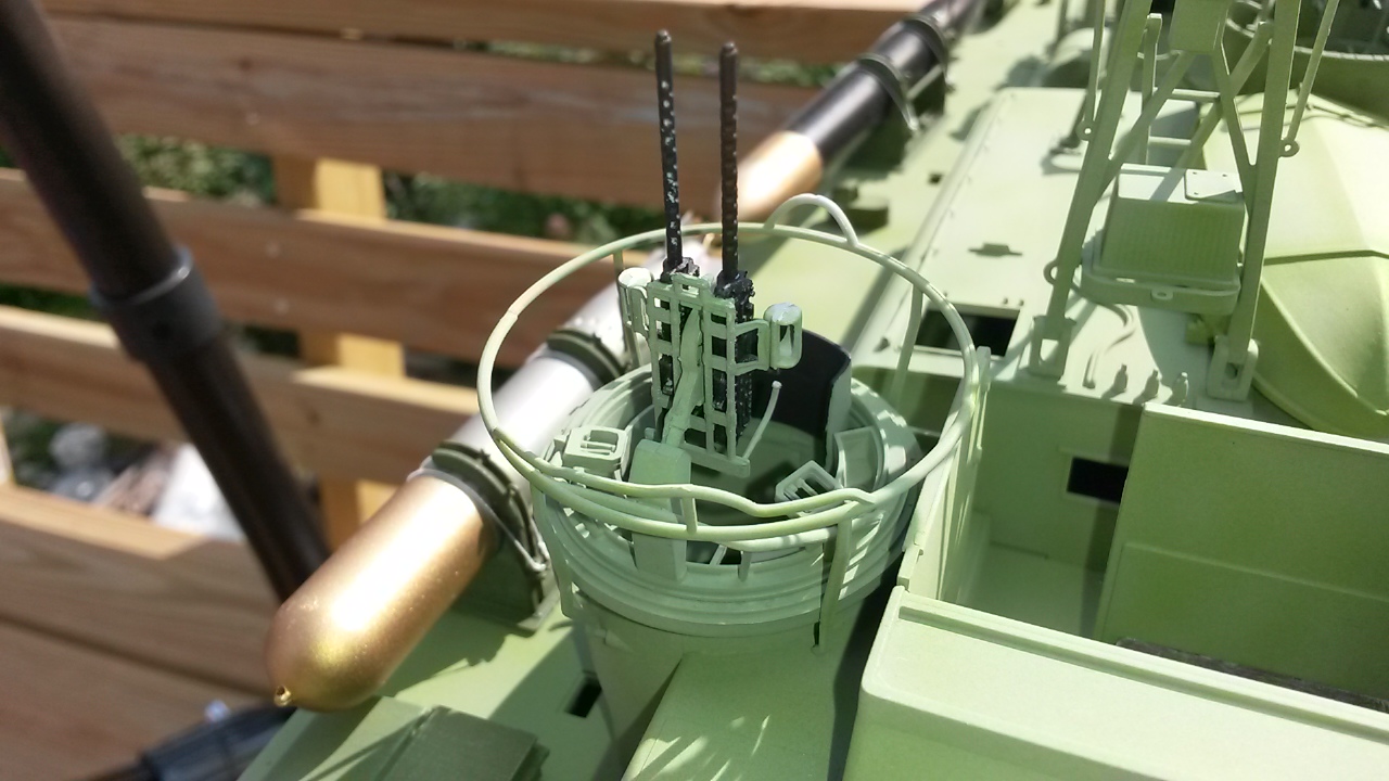

Here's some close ups of some of the detail items. Still some painting to do.
Here's the start of the camo. The plan is to leave the deck in the pale green. Bill
