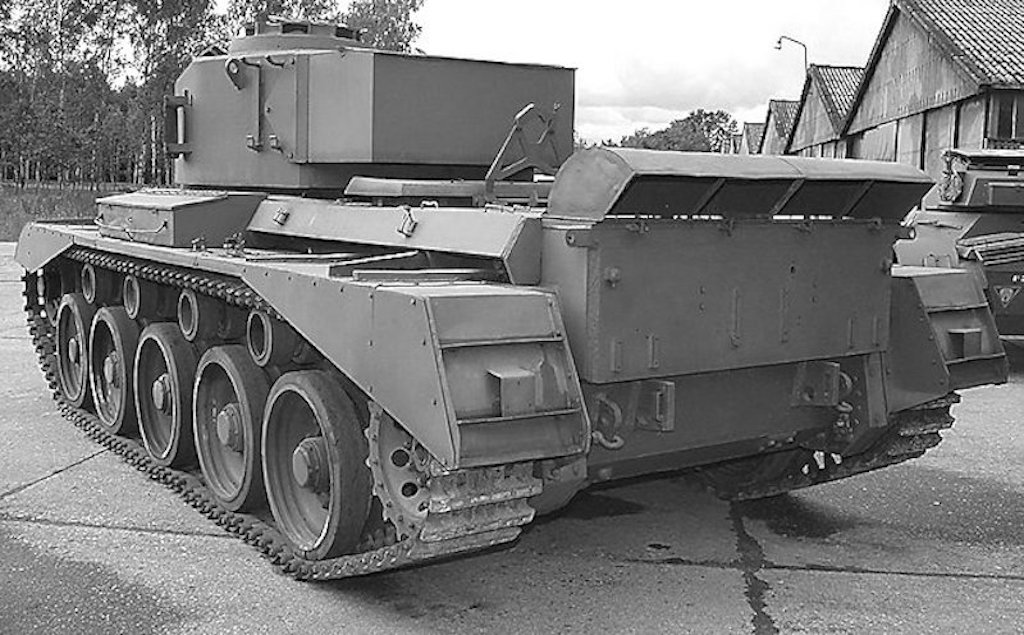

It looked like this:
Comet Mk 1-type A with full Normandy Cowl

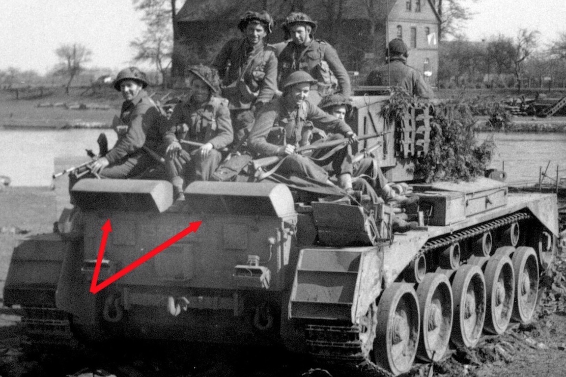

The type B Comet, introduced after the war, had fishtail type exhausts- removing the need for the cowl altogether. However, Type A models (the one I'm aiming for) were often fitted with a twin cowl, as the gap in between the cowls was needed for the Gun, when it was locked in the travel position. That's the type I'm aiming to make; and it's going to be even more niggly than assembling a full cowl. >:<
Comet type A with split Normandy Cowl-1944

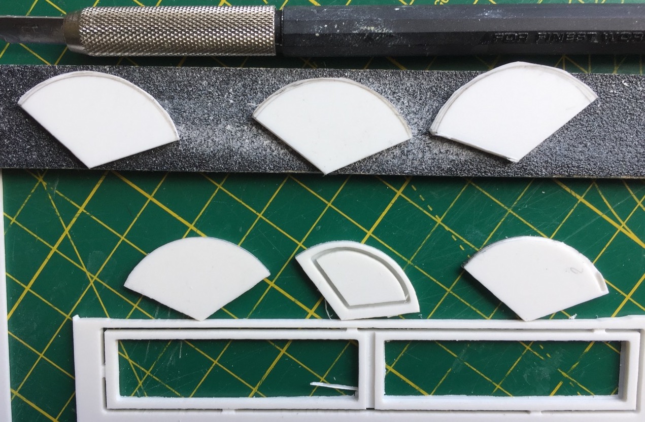

These are the parts supplied for the one-piece Normany Cowling:
Comet build-Normandy Cowling kit parts
But, I want to build the split version of the Cowling, the one was introduced to permit the gun to be locked in travel position.

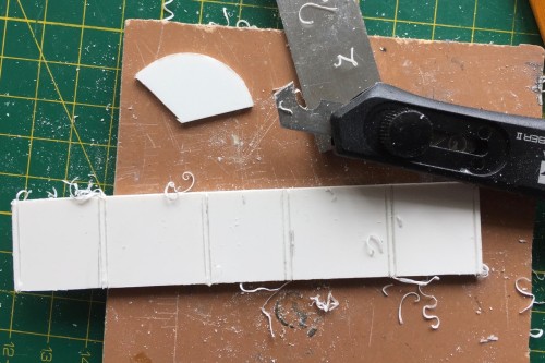

So...I used the supplied support segments to make some more supports.
Normany cowling-parts for twin cowl

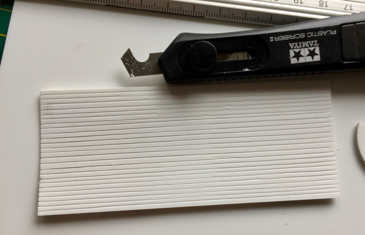

Putting a decent curve into the Cowling shroud is ... (as I recall from my previous efforts on the Cromwell build)... something of a nightmare. You can try heat and hot water, to fashion curved panels; but they don't seem to work very well. Using a heat gun can condemn the newly shrivelled up, curled, or permanently twisted styrene sheet to the rubbish bin, with only a tiny tad too much heat. :problem:
I learned this the hard way.
One method I tried of 'softening up' the reluctant styrene panel, was to score lots of lines on the inside of the panel, using a Tamiya scriber (one of my favourite tools). Here:
Scoring styrene sheet to form a curve
(Do click on all these images to ENLARGE them, by the way.)
Well, while this helped to weaken the panel, it also produced a very complex polygonal on the outside (like the old threepenny bit). This simply wouldn't cut the mustard, and so I abandoned that idea.

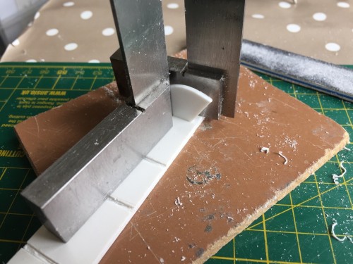

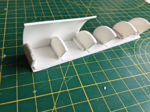

Instead, what I did, first of all, was to bond all of the curved segments to a 3mm piece of styrene- having first cut slots out, to embed them in:
Fitting curved supports to base
Then I bonded the front edge of the shroud, allowing it to cure for quite a while.
Attaching shroud
Attaching shroud

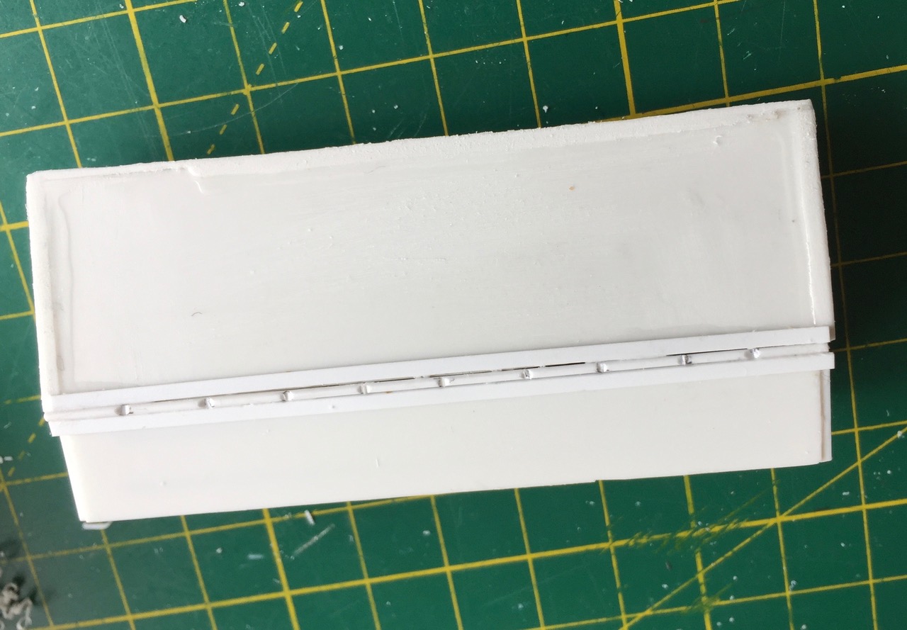

Meantime, I've got the storage boxes finished, barring sanding and ann internal hinge mechanism (I might simply use Duck tape, as the pivots won't be visible- only the simulated full-length hinges will be on display)
Comet storage box
Comet storage box

For hinges, could you use tiny brass tube and fuse wire to allow them to function .?
Posts: 6294
Re: Comet A34- Ludwig kit
HERMAN BIX wrote:For hinges, could you use tiny brass tube and fuse wire to allow them to function .?
:problem: Those 1/35 maestros would have no difficulty with that, I'm sure, HB. Even at this scale, though, things get tricky for ancient hands and eyes. The tube would have to have an outside diameter of less than 1mm in order to keep within the scale values of the box. That would be something like a hypodermic needle. 8O
Then, bonding alternate sections to the lid and the casing would be nightmarish. 8O I couldn't work with minuscule brass parts in the way that Barry does. :|

Hey I gotchya !........you are making it look easy enough to pull hinges off without any extra Whiskey shots ;)
Considering the boxes will not be needed to open & shut on any regular basis, fair call :thumbup:
Just because you can, doesn't necessarily mean you should !!!!!
Those curved cowls are sublime , nice carpentry skills Sir.
