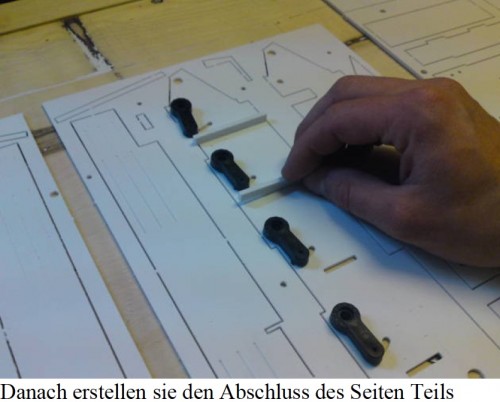

At this point in the build, Christian's Pdf instructions show the fitment of plastic Tiger 1 suspension arms (swing arms):
CL- Comet manual- assembling the sides
and with an adaptation...

Then, there are little press in metal grommets which are threaded internally to retain the roadwheel axles. Again, no mention of the means by which the 'swing arms' will pivot within the hull sides. :|
Here, however, there's no mention of how the arms are actually secured between the sandwich of plates we're about to make. By 'secured', I mean the axle or pivot the arm rotates around. On his website, he shows
a metal bar with brass bushings as an option. The bushings pass through the sides and the arm and are secured, on the outside by a screw and washer. This is similar to the arrangement found on the Tiger 1 (HL).
But it's not shown here. :problem:

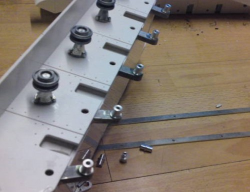

Later, we see an alternative arrangement, where alloy swing arms are used in conjunction with a spring, to simulated the Christie suspension.
I've found ( during the Cromwell build) that if you assemble the arms in place fully, with springs under tension (as per pics), it's hard then to bond the side to the floor plate. IMO, it's easier to fit the arms later..but it can be fiddly.

Here's a quick look at the main components of the suspension. The little stub axle in the swing arm (the roadwheel axle's retainer) is now a rivnut, or threaded and splined nut insert. It's an improvement on the previous stub; but is not shown in the instruction pdf.
It looks like this:
...and the general assembly. Note, I've already given the wheels a coat of primer and Olive Drab (this will be enhanced later) and the wee brass pivots I've cut are in the bag with the springs.
