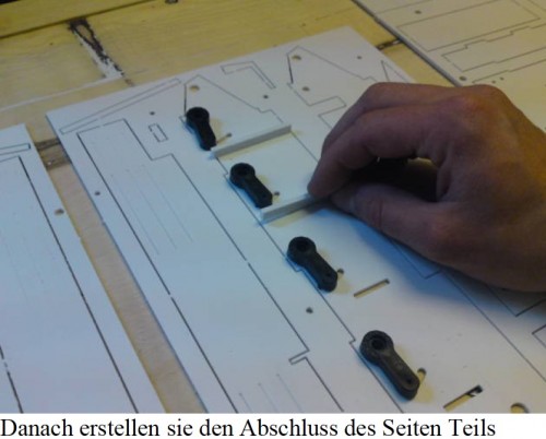

Hitherto, I've been referring to the sheets the parts appear in as 'sprues'. Tamiya and Airfix sprues are mostly like plastic tree branches, with the parts as fruit. After the parts are cut free, the sprues are only fit for the bin. Ludwig kits, however, are (Computer) cut, or formed, in large sheets of styrene of various thicknesses. I suppose I should call them 'plates'. Anyway, whatever the appropriate term, the residual bits are extremely useful.
Here's the plate the sides appear in:
The slots in the side wall are just waiting to be filled by the bulkhead bits here:
Make sure you fit them in the side that has location dots in the rear section.
You can see them in this pic. I could put red arrows in, but time is at a premium.
I made sure there were no residual tiny plastic stubs left over from where the panel was attached to the sprue. It's important to get as tight a fit as possible, and the little stubs can get in the way.

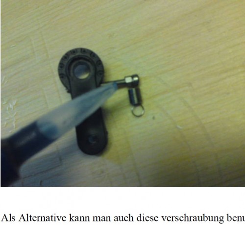

At this point in the build, Christian's Pdf instructions show the fitment of plastic Tiger 1 suspension arms (swing arms): and with an adaptation... Then, there are little press in metal grommets which are threaded internally to retain the roadwheel axles. Again, no mention of the means by which the 'swing arms' will pivot within the hull sides.
Here, however, there's no mention of how the arms are actually secured between the sandwich of plates we're about to make. By 'secured', I mean the axle or pivot the arm rotates around. On his website, he shows
a metal bar with brass bushings as an option. The bushings pass through the sides and the arm and are secured, on the outside by a screw and washer. This is similar to the arrangement found on the Tiger 1 (HL).
But it's not shown here.

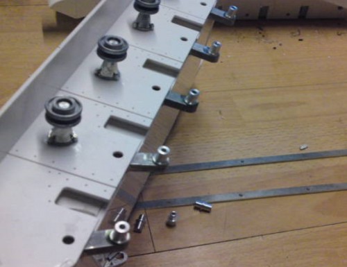

I then sawed ten lengths of 3mm brass rod off. These will act as pivots within the arm bushings.
Here, I've fitted the arm on the outside of the side plate, to get an idea of the length and size of spring I'll need to achieve the right ride height. This time around, I wasn't able to get the springs supplied with the Cromwell kit, and it was a real pain trying to find an equivalent online. The smaller of the two in this pic is closer to the type Christian uses. It stretches to 30mm, and that should be ample.
But this raises the issue of choosing the right components to get not only a credible looking suspension, but also an effective one. Too long a spring would create a risk of the tracks fouling the track plate, too short would make it look like it was wearing elevator shoes (a la Elton John in the 70s). Then there's the knotty question of where to drill the hole for the spring retaining bolt. The location also has a direct impact on the amount of tension (and therefore suspension) the arms will have, and of course, will influence the overall look and feel of the suspension.
So...that's why I decided to test the spring externally.
Jumping forward a stage or two, this is where I decided the spring retaining bolt should go. I used a compass and pencil to ensure that all holes would be drilled in the same place.
Making the sandwich (bonding the outer side to the bulkheads on the inner wall) I used set squares and drill bits to ensure that the two halves were aligned properly.
I also used weights to ensure to apply force to the bond, and also to negate any possibility of the plastic curling.

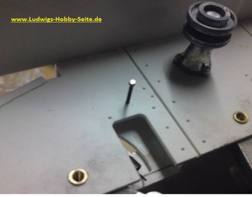

Here's a quick look at the main components of the suspension. The little stub axle in the swing arm (the roadwheel axle's retainer) is now a rivnut, or threaded and splined nut insert. It's an improvement on the previous stub; but is not shown in the instruction pdf.
It looks like this:
...and the general assembly. Note, I've already given the wheels a coat of primer and Olive Drab (this will be enhanced later) and the wee brass pivots I've cut are in the bag with the springs.
