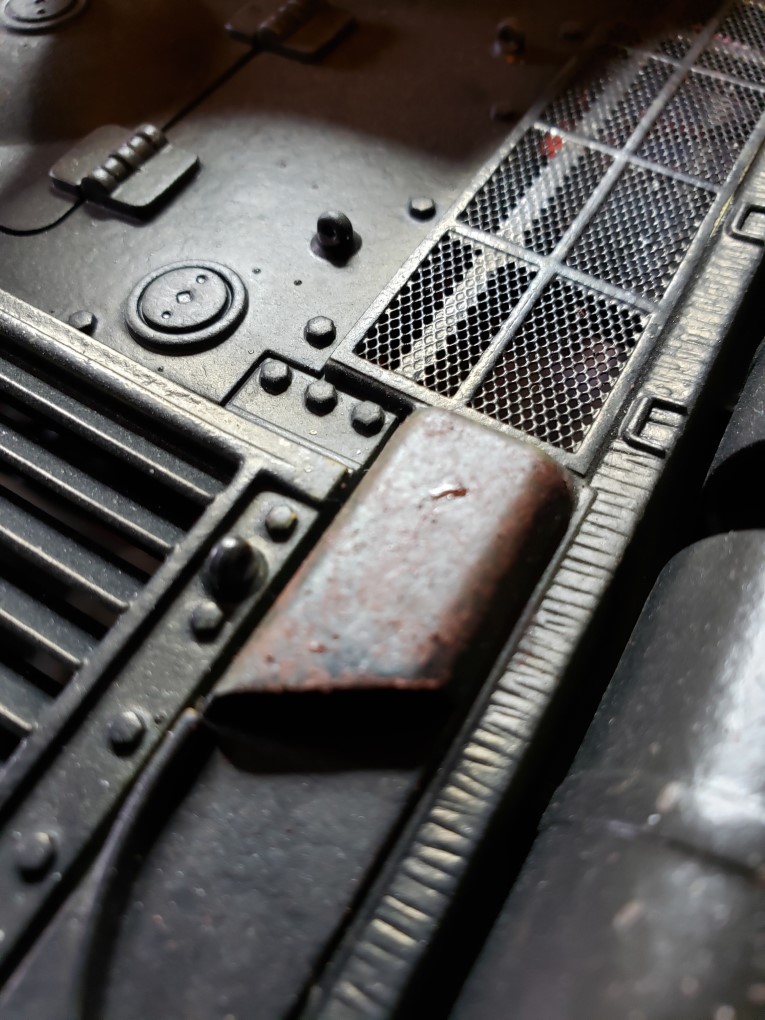

A little more detail work on the lower hull and deck. I still need to find or scratch some micro lenses for the marker lights but they are drilled out and painted inside for a start. Work is ongoing in drilling out the track pin runs for the spares up front. Pics: ( Click to enlarge )
Making progress
Making progress
The Loader approves...
Some of Taigens built in detail
Rear marker light
Rear marker light
Missing clamp added
Missing clamp added
Marker light closeup...drilled out and silver added
Detailing the hull underway
