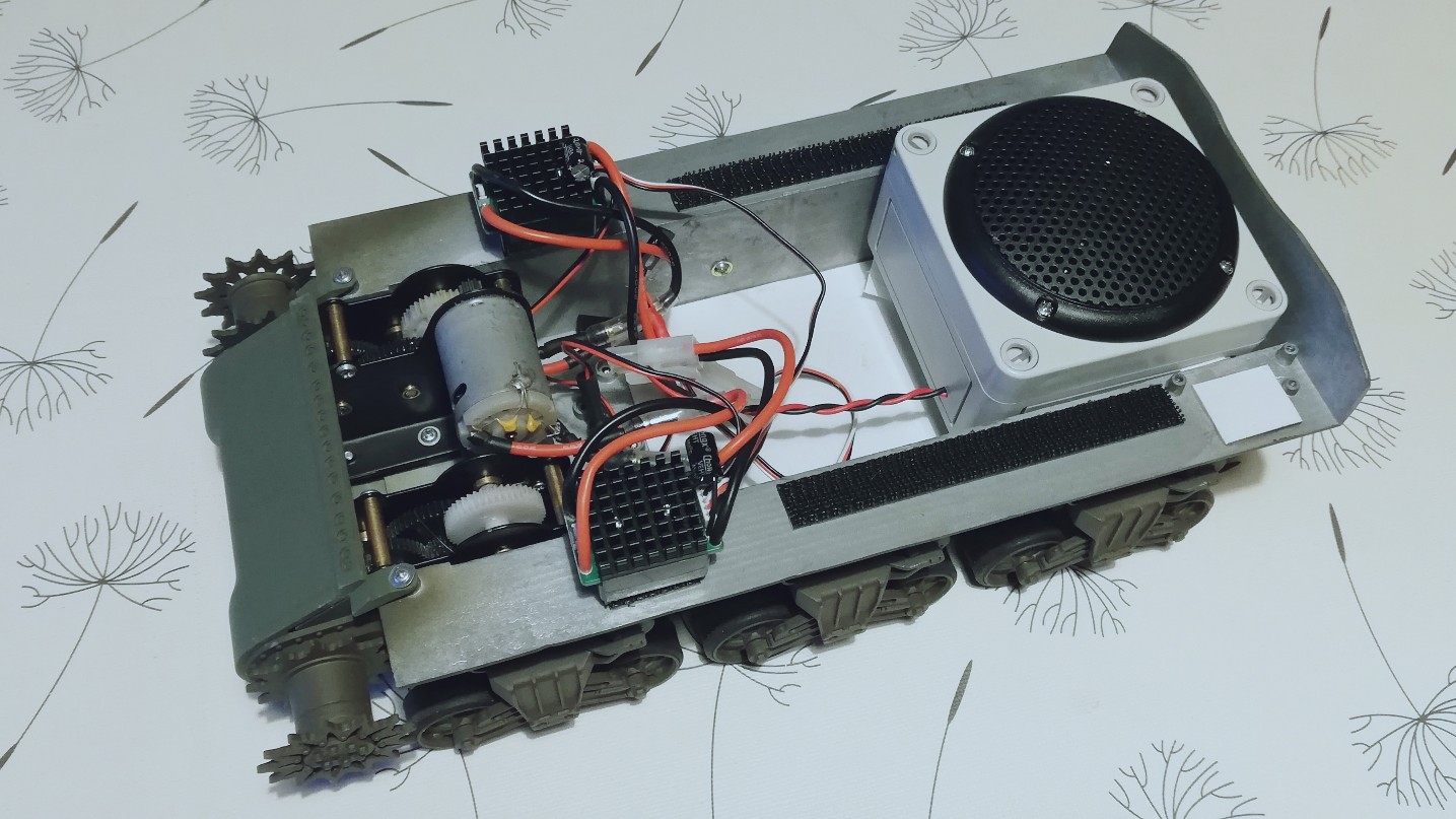

Remember about proper wooden or plastic box for speaker. In my case was little overkill ;)

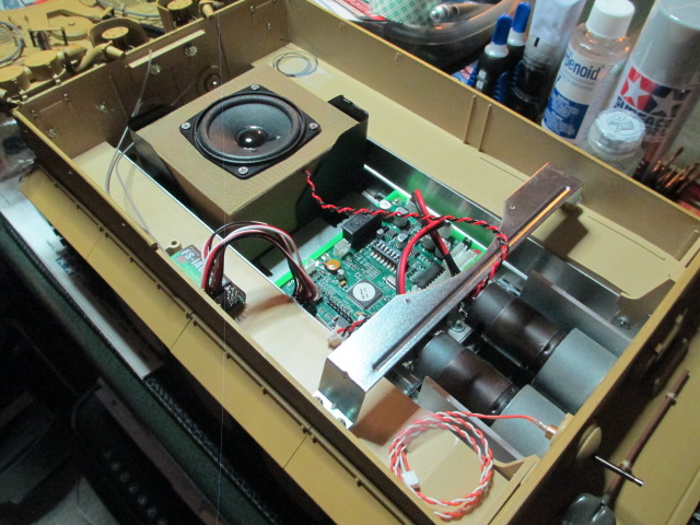

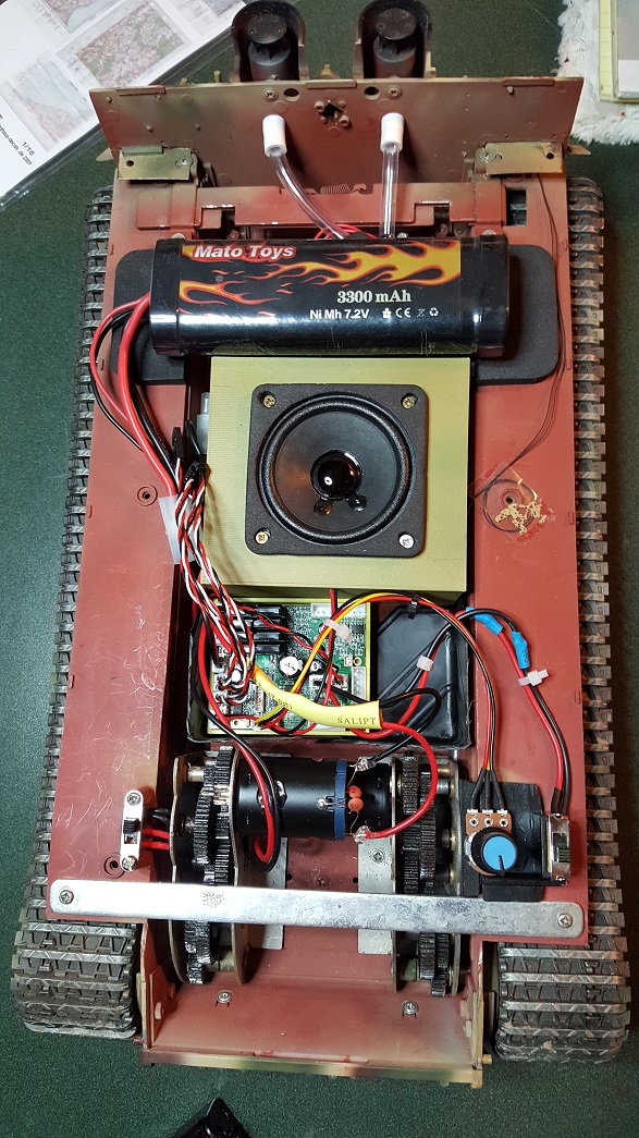

You guys need to chat with Maxmekker here on the Forum. He provides custom, sized to fit 4 ohm speakers and boxes for these tank builds. The sound is fantastic out of them. I use them in conjunction with CLARK boards and it is night and day compared to stock.

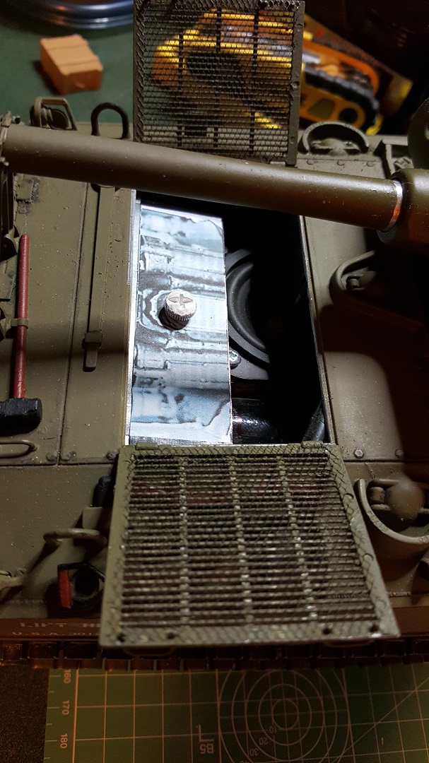

Some pics of Max's speakers in use ( Click to enlarge )
After this picture, I blacked out the speaker screws and added a line of tape across the back.jpg
A shot of the lower electronics mounting.  There is more wire management to do once the RX arrives..jpg
