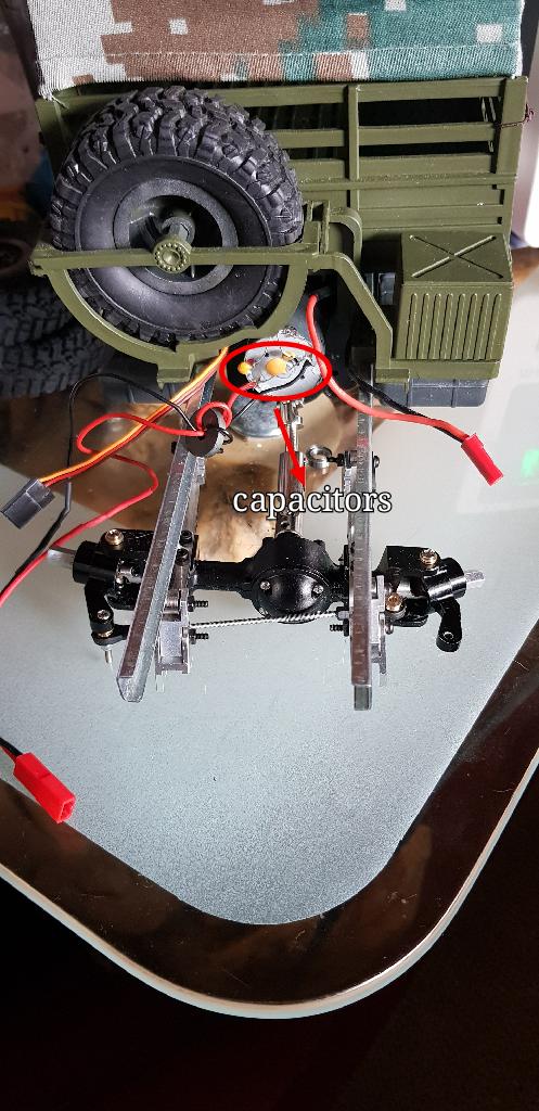

In your case I would try to connect the LEDs parallel with one 150 Ohm resistor each. If this does not fix the problem, you might suffer of radio interference caused by the motor. In this case you need to add some capacitors to the motor circuit. Start by adding one 100nF capacitor parallel to the motor (i.e. between positive and negative contact of the motor). BE SURE TO USE CERAMIC CAPACITORS! Other types will blow up when the polarity changes when you switch from forward to reverse!
If this still doesn't help, add two 47nF capacitors, one to each motor connector. The second pin of those two capacitors is soldered to the motor.
Capacitors to eliminate radio interference
I hope that I did not completely confuse you.
