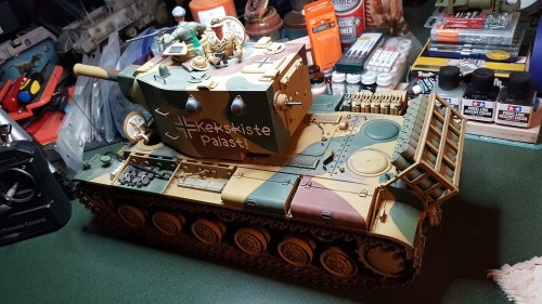

Good morning,
Don't be afraid of using the Hairy Stick in conjunction with those excellent Tamiya rattle cans. ( Model Masters is also an excellent source of very good colors for rattlecans ) The 'Palace' here had the base coat done with Tamiya Primer and Model Masters Desert Yellow from a rattle can. The Rottbraun and OliveGrun were added freehand with oil paint brushes. Lots can be done with a pattern to follow and a steady hand.
regards and have fun which ever route you choose.
