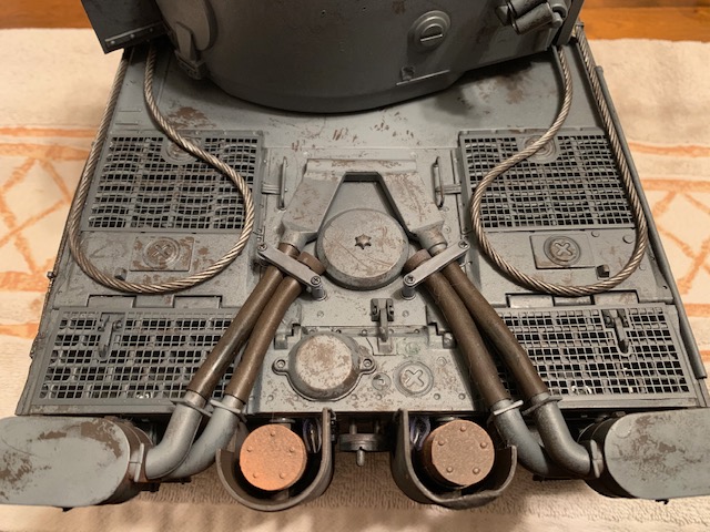

Super easy install! I still need to mash the edges down for a more form fitting look. I know this is redundant for most of you but I’m continuously amazed at how much better my tank looks with each additional detail part. It’s transforming from an inexpensive “toy” into a fairly nice model. Thanks to everyone that has helped me along the way.
