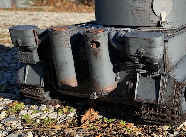

I have a decision to make about which decal set to use. I really like the big Mammoth decal that goes on the rear of the turret but the tank number 100 had side turret cargo boxes and no side skirt armor so it would be very incorrect. I may end end up using the number 302 set. Both tanks are early versions from the 502nd and were at Leningrad which is cool. I’m not sure how most folks feel about modeling inaccurate tank markings.
I’m also waiting on metal detail parts from Forgebear but I went ahead and added small chains on the back of the filter boxes that apparently kept the round caps from getting lost during maintenance. I’m having a great time with this new hobby and took it outside today for some backyard maneuvers. Thanks for checking in.

Being inspired by fellow member pvt. pyle I’ve ordered a Taigen metal hull with the 5:1 gear boxes from Forgebear. I love the addition of the sturdy metal, the awesome looking torsion bar system and the new gears. This tank is starting to consume 100% of my hobby time. I’m not complaining.

Today I received the etched brass engine cover grills (thanks to Herman Bix for the subtle suggestion). Do I simply glue these on top of the deck? Sounds too easy.

That guy that ‘grilled ‘ you about grilles was Mr Jarndice !
Yes, they go over the top ov the armoured hatches. Super glue on the plastics then lay the mesh in place.
Best to lightly sand the contact area first.
Once secure and dry, use the round end of a pencil to depress the flat mesh into the louvers below for a better look of foot traffic and suchlike.
