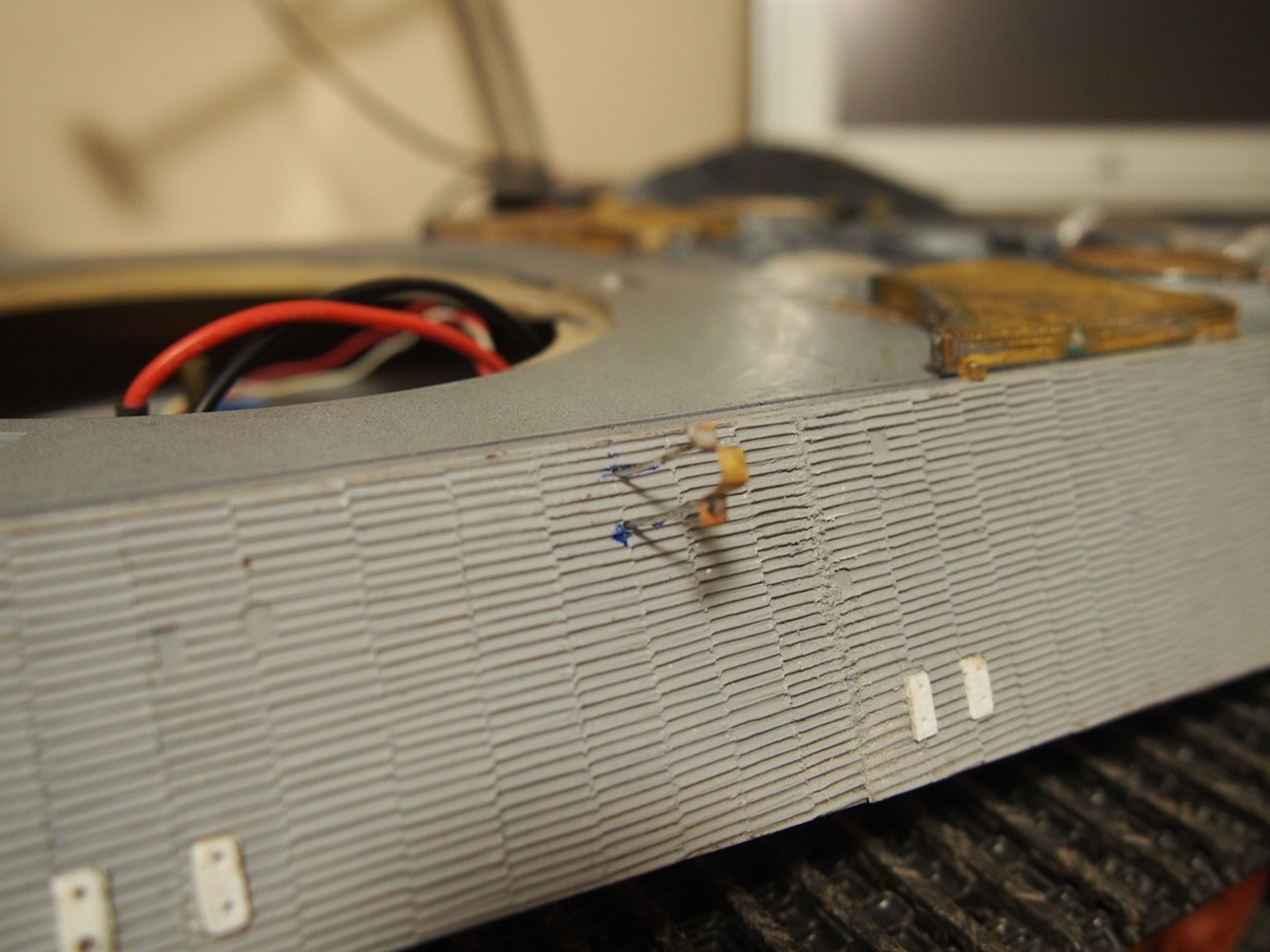

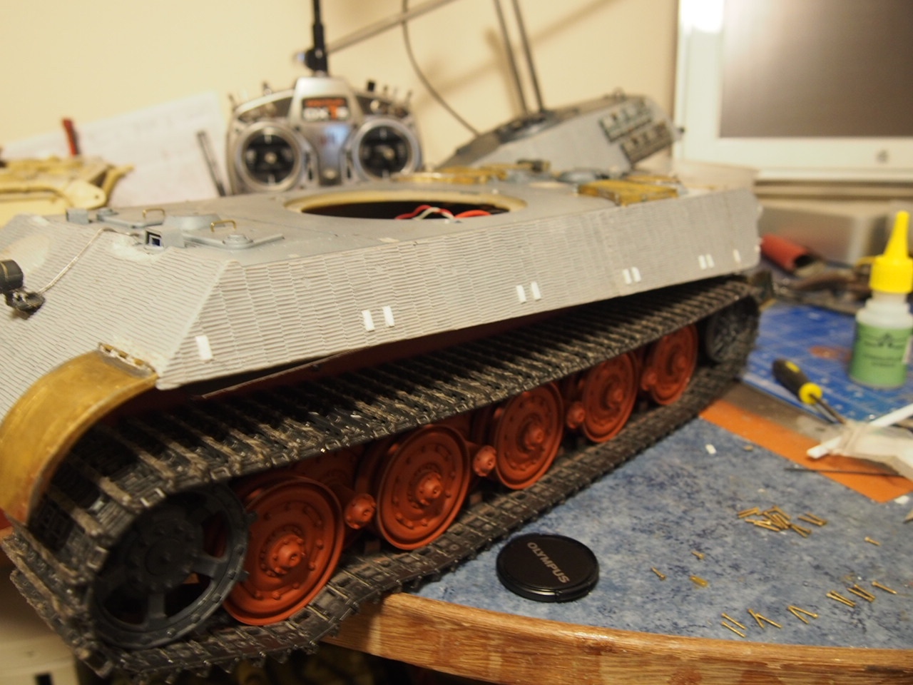

More work on the hull, some PE for the tools.
skirt plates for bolts
bolts too big
bolts too big

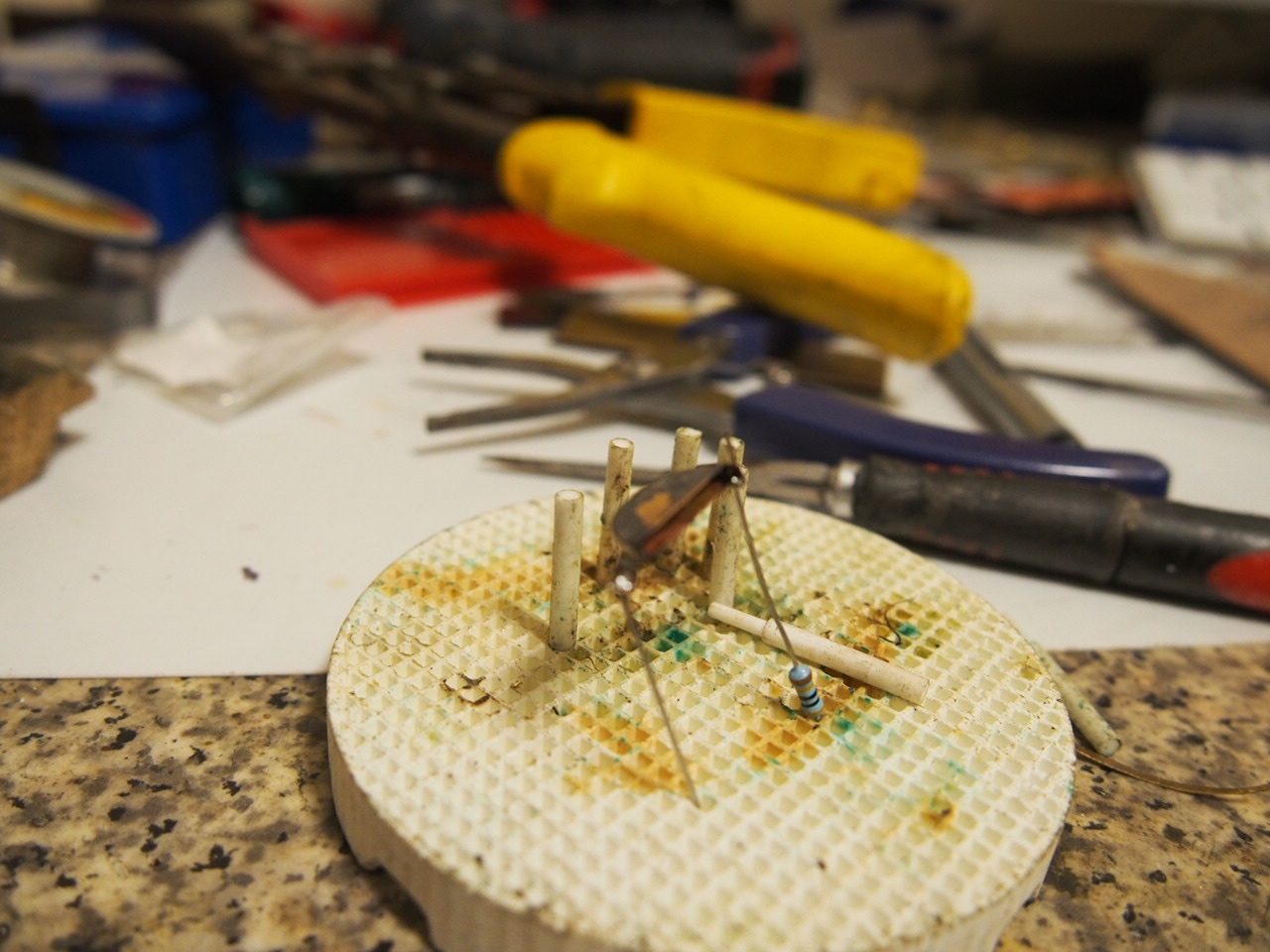

starting the tricky stuff shovel fitting
fitted used a resistor lead for fixing

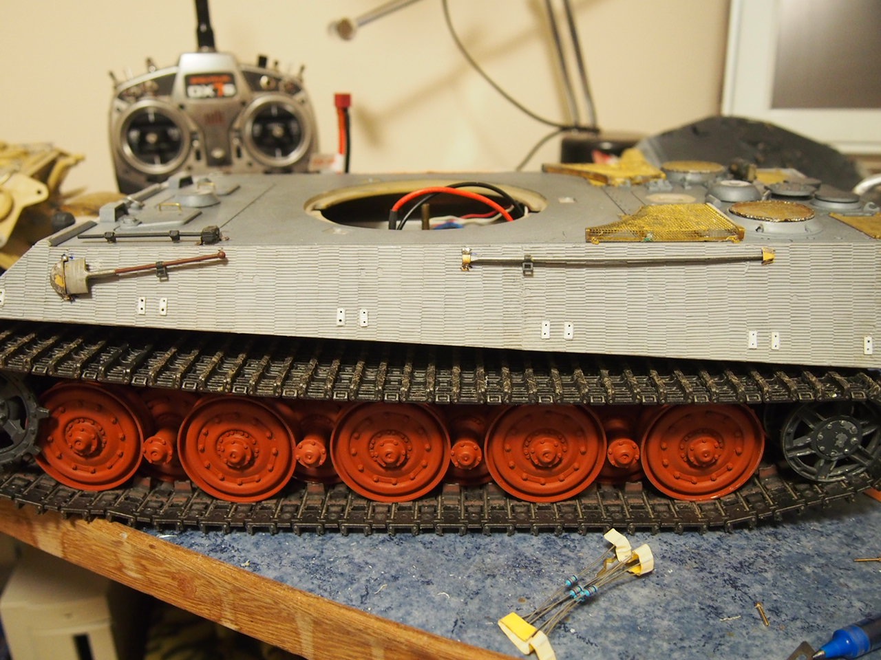

pry bar holder
pry bar holder
pry bar fitting
pry bar fitting
tool holders without the clasps
looks ok with the tools on

Thanks for the praise C73 . Don't think i an that good , had a massive fail with the Aber shovel holder it has 4 parts . The voyager PE is a bit more user friendly it has 2 parts , both sides and the curved sections are one piece . My soldering kit is a bit primitive should invest in the miracle solder paste and soldering torch.
i need an upgrade to do the little PE bits

Tow cable and cleaning rods . Found some small brass bolts just right for the screwed ends
