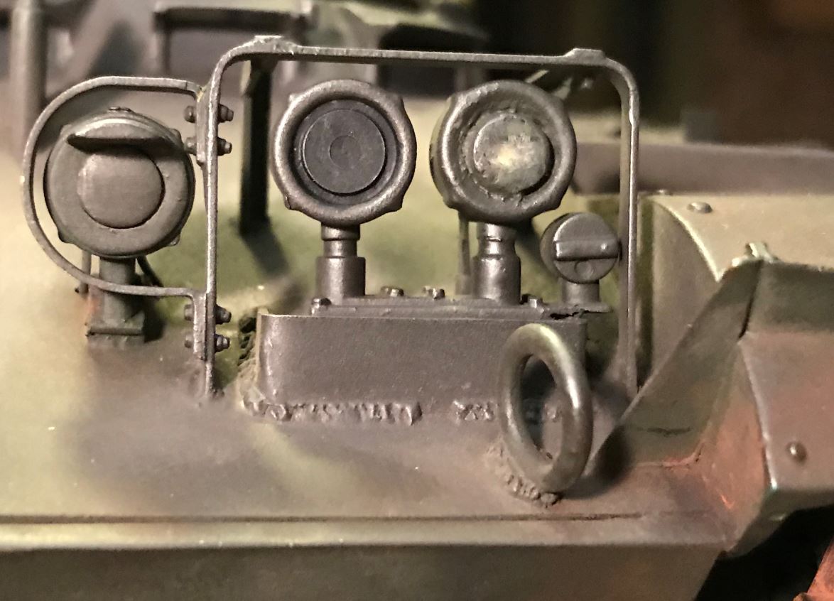

Thank for the suggestion for the headlights Philipat, I will look into it. For the suspension, its the angle on the last picture. The suspension is very strong. With the way the shock absorbers number 3 and 4 were installed inside the tank, they provide a harder suspension than before when they were strait with the suspension arm.

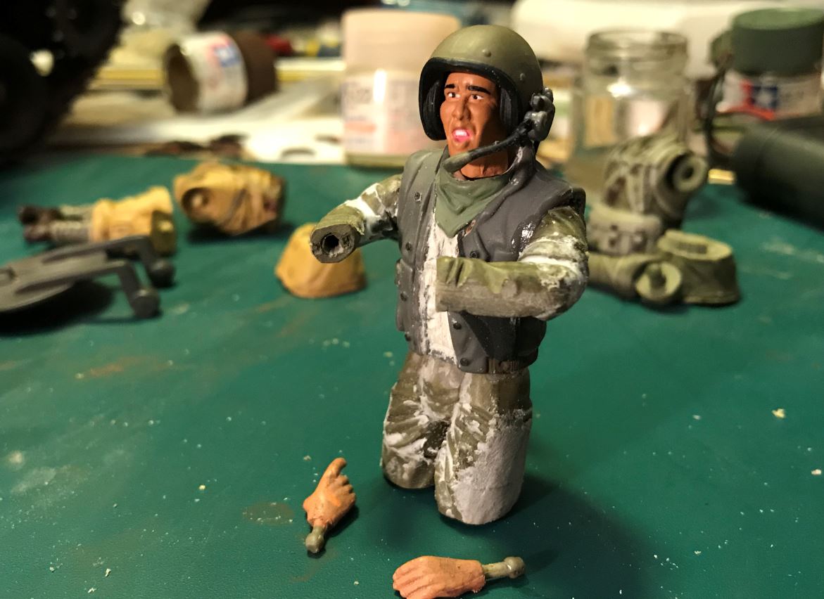

The two tank crew figures are built with the selected body parts. Putty is used inside the Jacket to make it fit the Asian head. A shirt is also improvised over the torso. The arms are still flexible at this point.
ARVN 1/16 tank crew RC for Walker Bulldog
The crew is positioned on the turret so that the position of the arms can be tested and chosen. Each arm have 3 adjustments points that are enough to provide a lot of flexibility in designing the pose. The arms are then superglued in the selected position. The tank commander will be manning the M2 Machine gun in both hands.
Then putty is applied to remove all signs of the flexible joints. It will be thoroughly sanded for seamless joints.

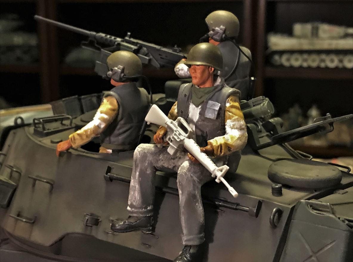

Here is the first infantry rider.

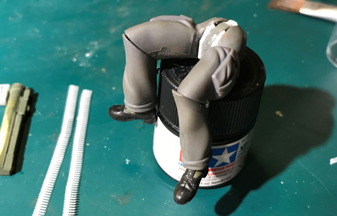

In similar fashion as the tank crew, 1/18 parts are assembled for the first prototype of the infantry, but with the Vietnam US tank crew legs and 1/16 infantry gears. You can see a Reedees miniature M-16A1 rifle (Vietnam era A1 version of the M-16), a Verlinden M-72 LAW anti-tank rocket, Tamiya WW2 US steel helmet, the rest of the gears are mostly from the Dragon Vietnam Seal figure which fits well.
M-41A3 Walker Bulldog Infantry rider 1/16 RC
The legs need to be spread out using a plasticard strip. The side pockets have to be deleted with the Dremel because there were no pant pockets seen on the ARVN uniforms. The legs are also trimmed to be much less muscular and more natural around the knees.
The first infantry rider is sitting on the tank. Be aware that the putty is still wet here and the finishing and polishing is not done. Painting will be done later.
The plan is to paint the uniform Olive green, the flak jacket a bit more Olive drab, the scarf will likely be red as seen on documentaries. Not sure if it was wise to wear a red scarf around the neck in combat... but it looked good and was likely important for morale.
The figure is still very dusty and unpolished but it gives a good idea. You can also inspect the quality of the M-16 rifle.
M-16 and M-72 Slings, ammo belts and other details will be added at the end of the build. At this point, none of the figures or ammo boxes are glued.

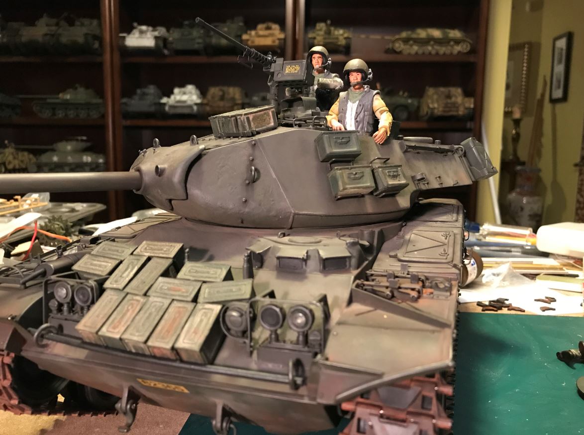

The tank itself is basically finished. Before I put on the crew and more items on the tank, here is a Before/After comparison of the basic shape to show the modifications performed. The M41 experts will notice a few mistakes here and there for sure but the overall result is satisfactory considering the number of issues with the base product and a relatively fast two months build period. My style is to avoid getting bugged down with secondary details and to maximize shape accuracy with a focus on visible items.
Summary of modifications
Notice lowered hull by 7.5mm, shock adsorber on road wheel 3 and 4 moved inside the hull, longer turret by 6mm and the embossed stiffeners on the fenders that were all redone with 1mm half rods in the proper shapes. Also new aluminum gun barrel that had to be perforated end to end to allow for gun flash. The gun has Clark recoil and also has much better elevation than before. And Barry got his red dust, typical of Vietnam roads in dry season. I finally decided to retain the Shapeways roadwheel 4 pins hubs, they do not look too bad in the dust.

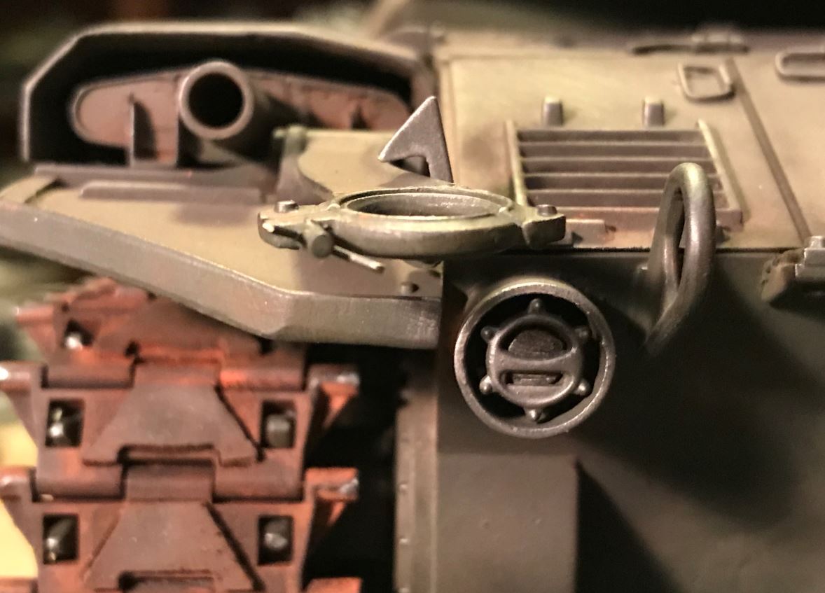

Notice the 7.5mm reduction height and new MLRS tracks from AFV-Model. Also notice Tank Modellbau M26 shackles and the auxiliary muffler that was reposition at the front, consistent with later version M41 with angled fenders at the front and back.
