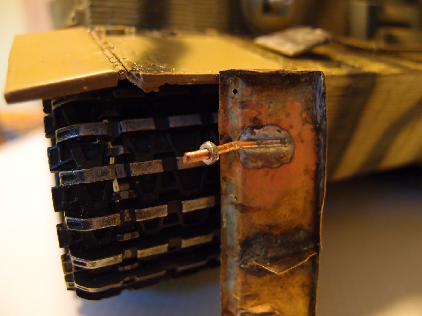

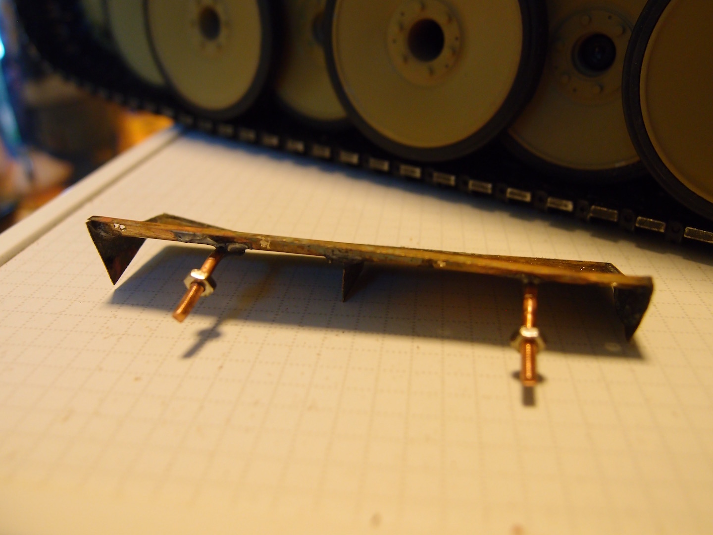

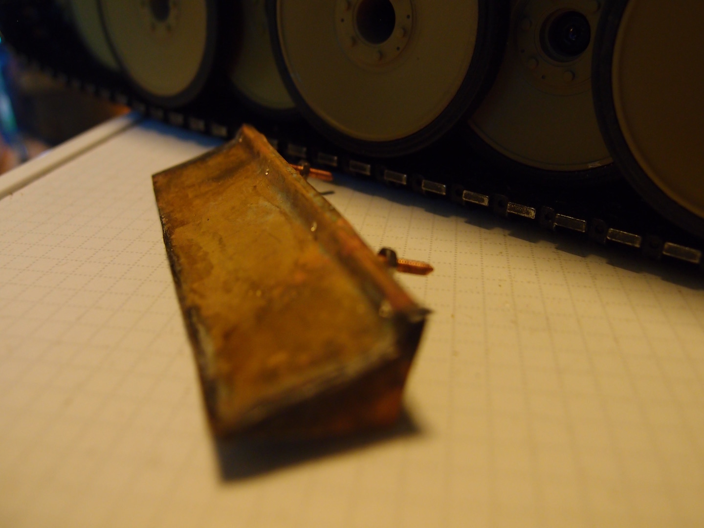

Thought it was a pain getting 16 tiny bolts holes in correct position. The brass bolts are prone to shearing when tightened up.
Easy way solder 2 copper wires ( 2.5 electrical cable is a perfect fit with a 4mm nut it cuts a nice thread as you screw down the nut . Good for ripped and bent skirts, only 8 holes per side and just glue on some bolt heads .  A slight bigger hole and a washer give some adjustment and unlikely to fall off. Will use to fix mudguards as well.
						Fixing Aber , Voyager or homemade brass side skirts
