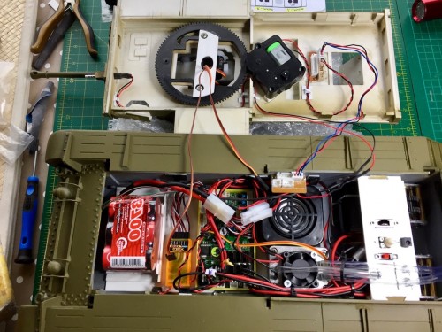

As you know, Lee, I opted for the TK60 in my Cromwell build. It's certainly more of a challenge fitting it in, given its size, but as you can see from this pic, it does go in neatly in transverse orientation (like a Mini engine). I opted for this unit because of its future potential, robustness (drive train amperage..), and also because of those amazing Rolls-Royce Meteor Cromwell sounds from Stian.
I use it with my Spektrum Dx6i.
Cromwell with Clark Tk60 electronic heart
Using a 10-channel TX would confer other benefits, as channel sharing can be a pain; but I just happen to like my Spektrum radio.. :think:
Incidentally, I had to revise the turret layout slightly after this pic, in order to make more room for the smoker pipes.
