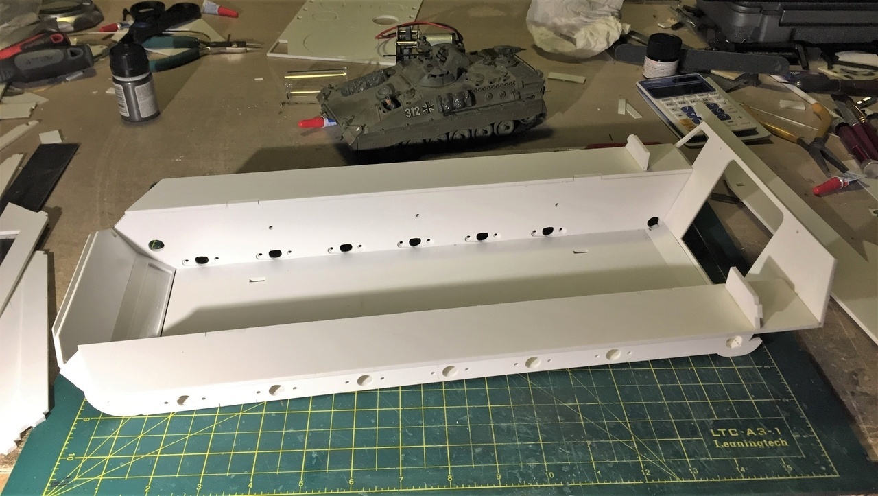

Starting construction of the hull.

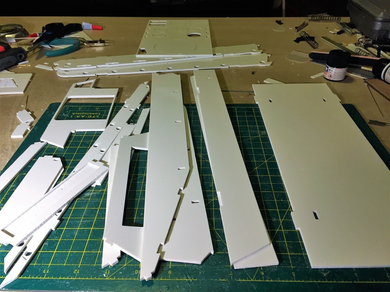

Hull parts are separated from their sheets, sanded smooth and cleaned up. It takes about 30 minutes.
Ludwigs Marder 1A1
Ludwigs Marder 1A1

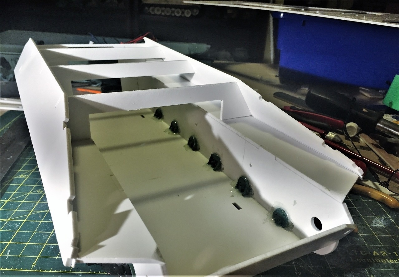

The tub is ready within a few minutes with superglue. It will be a pretty big animal.
Ludwigs Marder 1A1
Ludwigs Marder 1A1

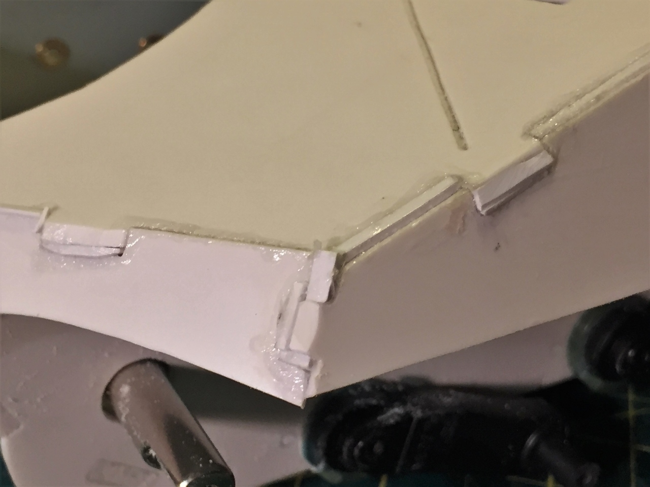

Plasticard strips will be required to fill the gaps and solidify the joints. Then an overlay plasticard sheet will be applied over to make the front plates seamless. These gaps must be expected by the builder and should be dealt with a cooler head in subsequent steps once all the main parts are in place and the overall situation can be assessed.
Ludwigs Marder 1A1
Ludwigs Marder 1A1
Ludwigs Marder 1A1
Ludwigs Marder 1A1
Always need to make sure everything is square and strait. Double and triple check everything before gluing or sanding.
Ludwigs Marder 1A1
Ludwigs Marder 1A1
This is fun, the Marder hull taking shapes.
Ludwigs Marder 1A1
Ludwigs Marder 1A1
Main top components are put together. Frames are provided to ensure the parts will be at the right angle, very good.
Ludwigs Marder 1A1
Ludwigs Marder 1A1
Dry fitting of the upper hull on the chassis shows that things are ok, no major issues. All joints will need heavy preparation with specific angles, sanding and custom made plasticard strips required for each gaps. These gaps are too big and structural in nature to just fill in with putty. This is plastic so everything can be easily dealt with. I imagine that the builder that ordered his hull in metal will have a lot more difficulty putting this baby together.

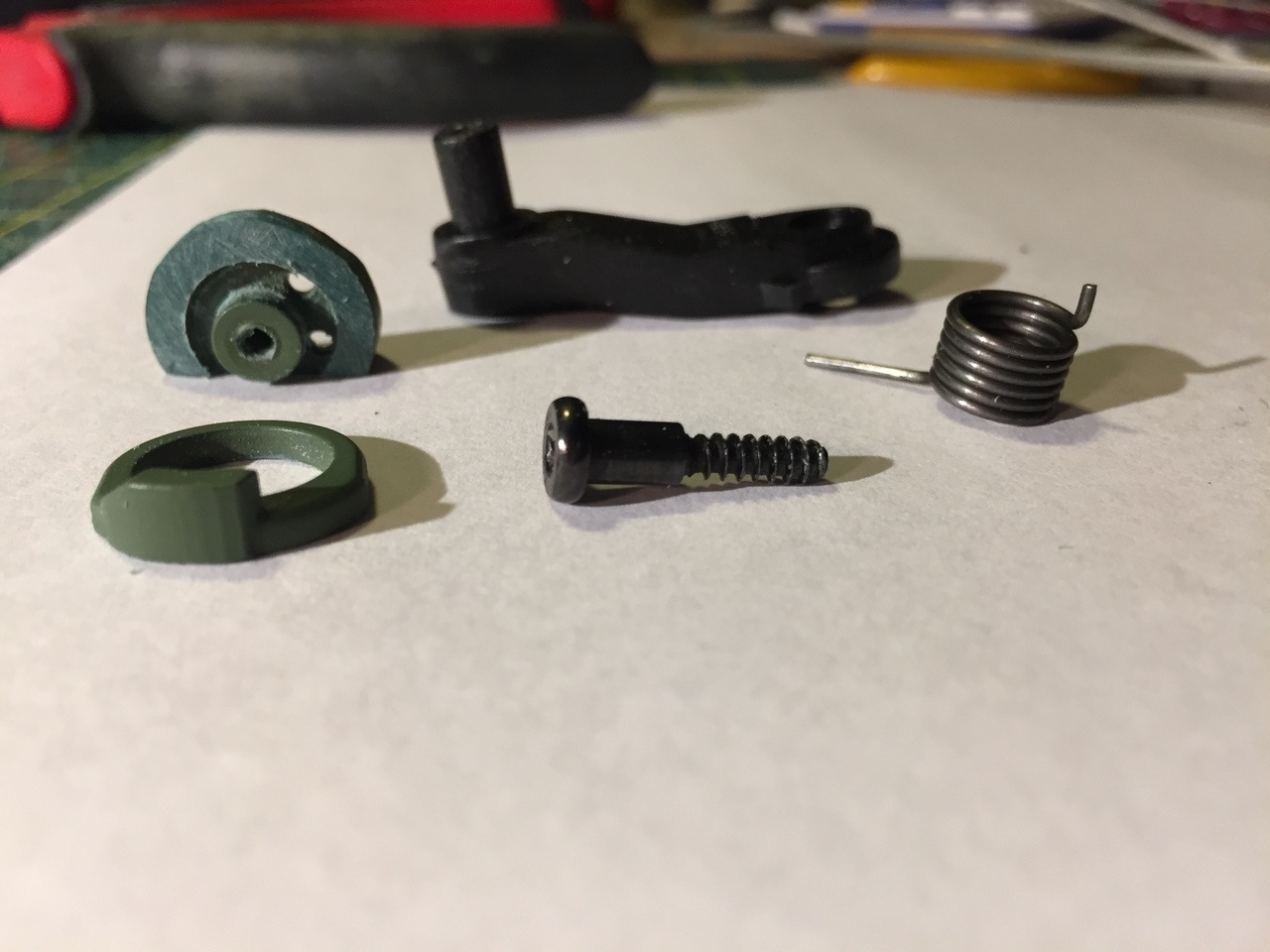

The self contained individual suspension elements are cleaned up for further modifications.
HL Leopard II suspension
My solution was to cut them is two sections for installation of both side of the Ludwig suspension hole on the hull.
There are the individual parts for each suspension arm and ready for installation.

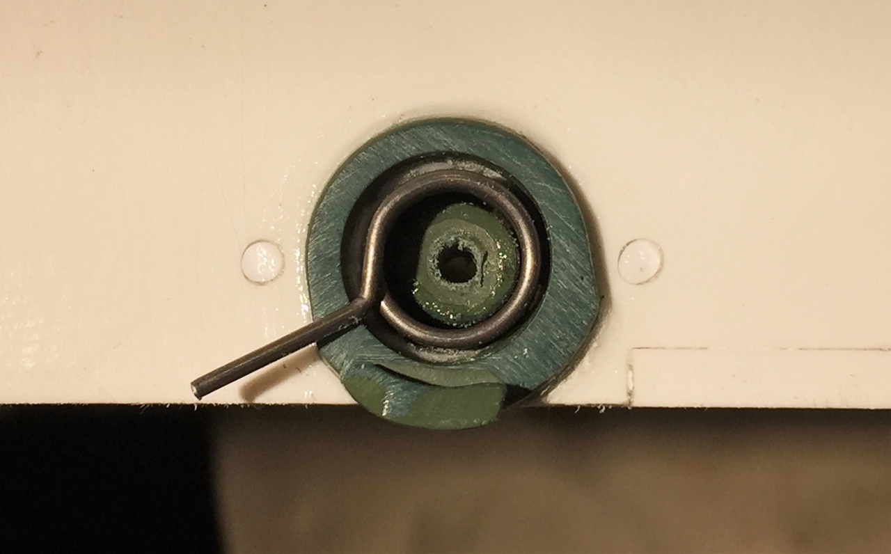

The suspension hole on the Ludwig hull is made a bit bigger for the spring to fit. Here, the base of the suspension is glued on the interior, facing outward and making sure it is properly centered with the hole.
Then the exterior part is glued after positioning it properly with the suspension the arm. It is important that the stopper be at the right location.
Spring is put in place
Marder suspension arms are installed, aligned, looking good and working fine, exactly like when they were on the Leopard chassis. It was a 5 hours operation end to end, including the prototyping. The road wheels can simply be attached to their arms with the HL screw. A much simpler task than trying to figure out a way to put HL wheels on Tamiya shafts.

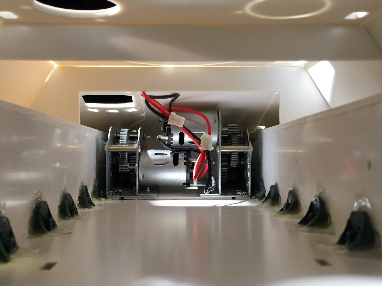

View from the inside. With the gearbox at a angle like this, it fits the Marder hull, with around 1mm to spare...
Ludwigs Marder 1A1 MICV 1/16
When positioning the gearbox, it is critical to install it so that the custom wide sprockets are centrally positioned between the schurzens and the hull, and same on both sides of course.

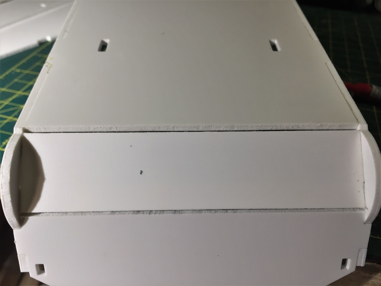

Continuing on the hull.
The 2 small parts on the front corners are quite something to install... There is actually no perfect way to install them so the builder need to do his best and then deal with the gaps. Those who have build such kit know that gaps on angled joints all around the vehicle need to be filled properly for a solid and beautiful model.
Ludwigs Marder 1A1 1/16
The builder must not throw tubes of putty in the big gaps. Such filling would take an eternity to try, will shrink, crack and won't make a solid joint. My method is to insert strips of residual plasticard of the required size and thickness in the gaps, mixed with superglue, which can then be sanded smooth with files very shortly after. Putty is only used for thin applications.
The same area after a good sanding. Once polished and primed, it will be seamless and sleek.

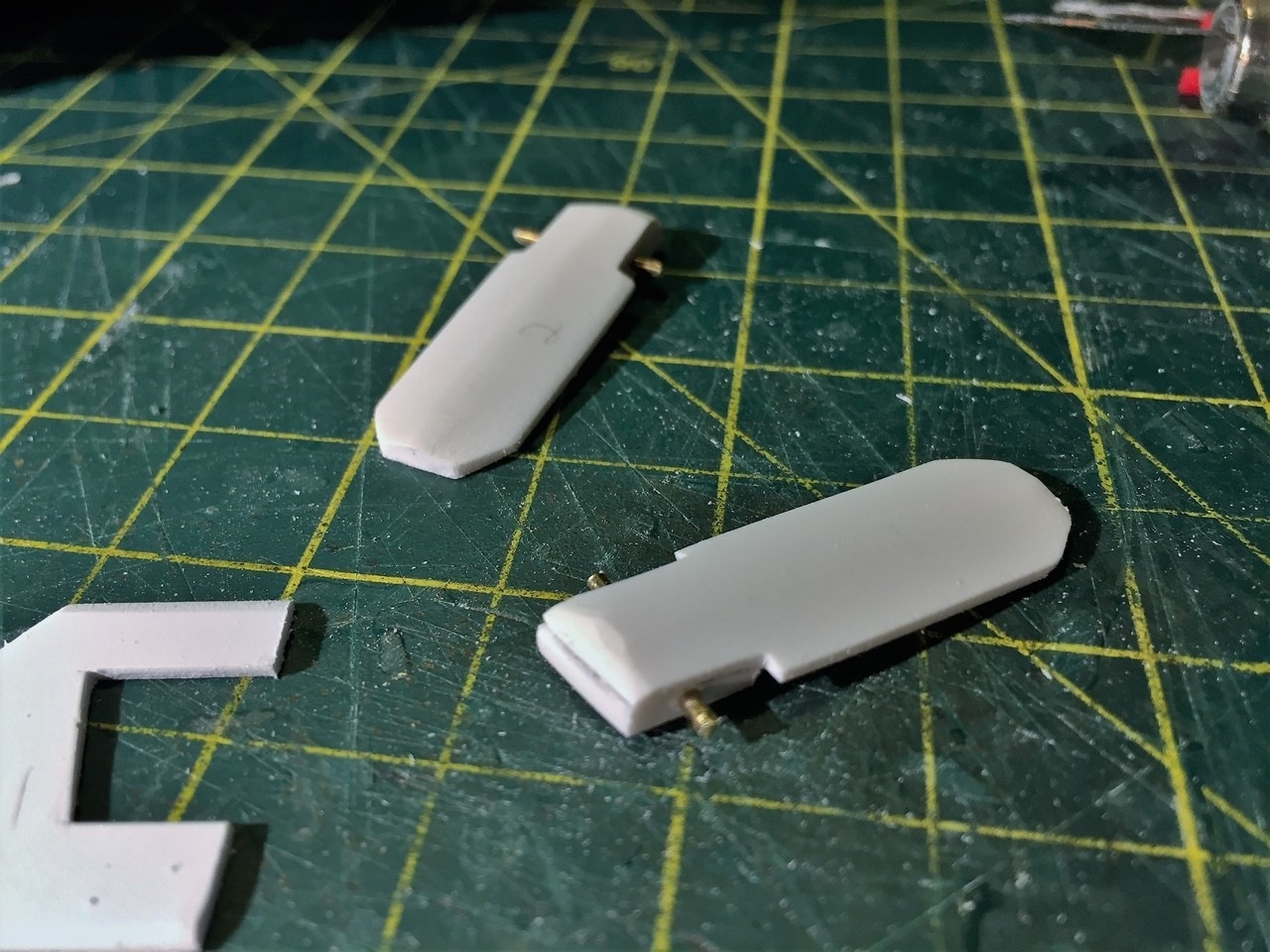

Getting ready to install the engine cover. I realised that the hinges parts provided with the kit (on the left) were of only a vague resemblance to the real ones and were too small, so I had to make new hinges by copying those on the Tamiya kit, and double checking that size and shape were as per photographic reference. They also have various angles to repro so these are no mistakes.
Its only natural that the engine cover be made to open and close like the real thing.
The brass rod will be hidden under the hinge covers.
Engine cover is installed, opens up and closes perfectly.

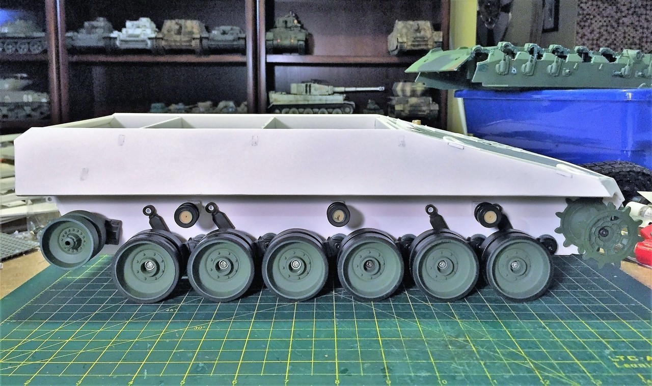

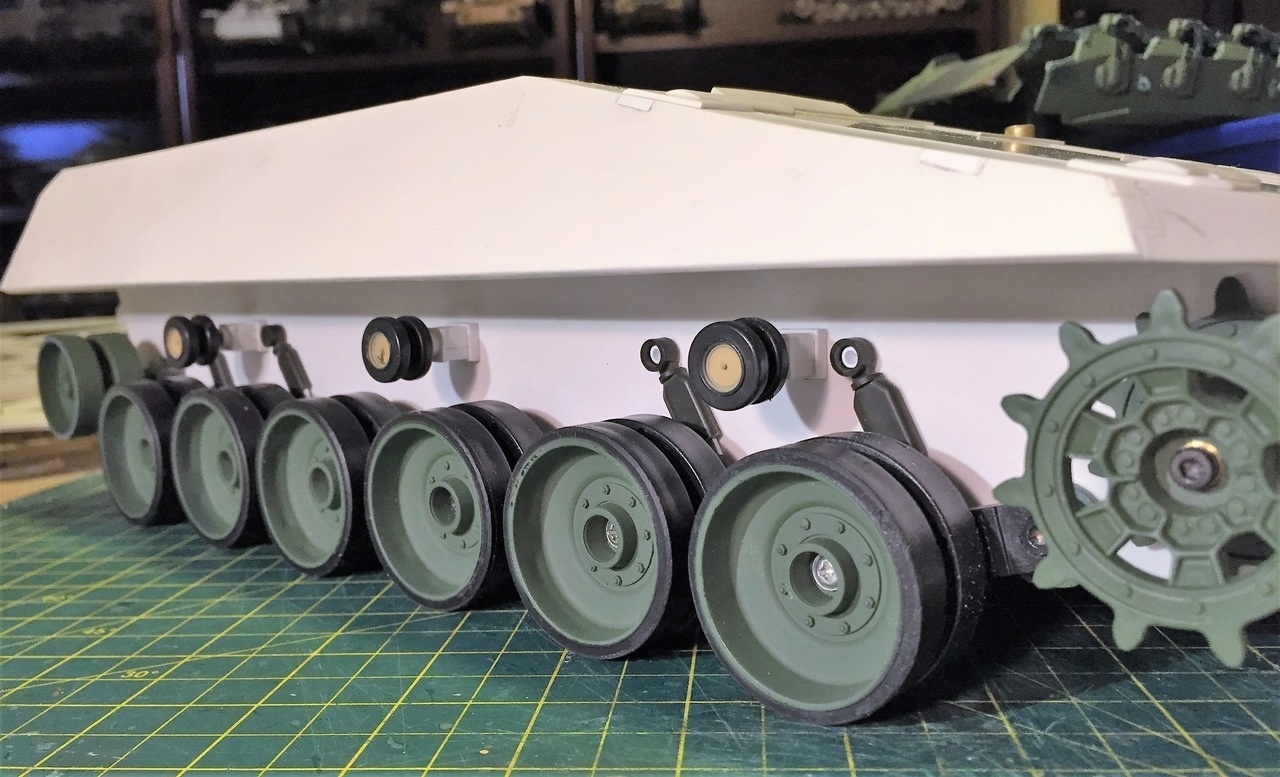

Here is the running gear.
As mentioned in the pre-planning post, each HL Leopard 2A6 road wheel was made narrower by removing about 1.5mm between the 2 wheels. It helps with the fit to the Marder because reducing the wheels themselves would be complicated.
Ludwigs 1/16 Marder 1A1
These are the parts that I have assembled to complete the running gear. Bottom left are Panzer IV rollers from an earlier project that required these to be replaced by all metal rollers. Then on the lower right are the Ludwig parts for the roller ams that need to be assembled. Top right is the idler adjusters cut out of the HL Leopard 2A6 chassis. To the left are the roller shafts from the HL chassis. Above and top left are Tamiya running gear parts that are a leftover from a Leopard 1A4 reconditioning project from 10 years ago and that can be reused here. Never throw anything away...
6 return roller units need to be made. The middle guide teeth of the Leopard 2A6 tracks will need to be shortened a bit to fit such return rollers. The ones coming with the HL chassis were not of the right style. The Marder needs these 2 roller wheels side by side.
I would have normally installed a Henntec Idler adjuster unit but the units from the HL chassis is available. This is an experiment in trying to save 35EU plus shipping. There is not much left on the poor HL chassis that was cannibalized to the maximum. I seem to have saved a lot of money that can be put to more visible use.
The HL idler is transplanted on the Marder, works well... I added the idler part from the Leopard 1A4 as per reference.
The HL Idler part on the inside fits the Ludwig groove, although I had to trim the metal part a bit for a perfect fit into it.
The external housing for the driving gears has been added to the front chassis as per reference. The front mud guards are not installed yet, they must be mounted at the same time as the side schurzens because they are integrated to them and must be aligned perfectly.
Overall look of the Marder running gear, not as per instructions but of my own design. Although most of it will be hidden by the schurzens, I wanted it to look good and be as accurate as possible. I am missing the 12 stoppers for the suspension. I am looking for them.

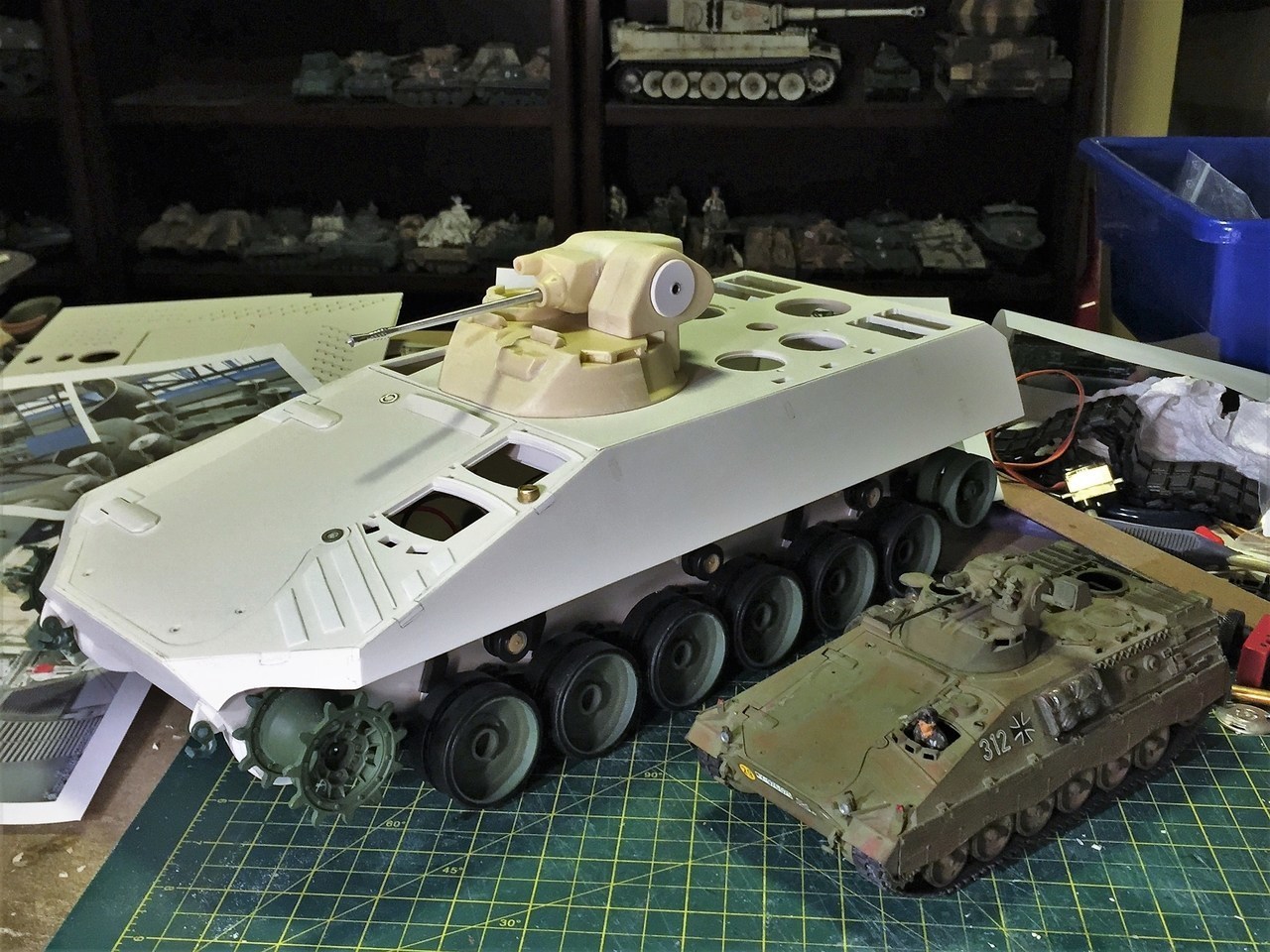

But enough of the chassis for now. I want to look at the situation with the resin turret and its buildup will be my next sttep.
Regards, Louis

Here is the turret.
These are the main resin components cleaned up, and also others parts gathered for the build. Needed parts includes 5mm and 4mm aluminum or brass tube, push rods for elevation and servo. The resin part needed quite a lot of effort to clean up. The base is very good and dimensions are accurate (great) but it has some air bubbles but no big deal. The gun stand and movable unit show much distortions and are a lot more difficult to handle. The metal barrel provided with the kit is great and comes with a lenght of fibre optic cable for the flash.

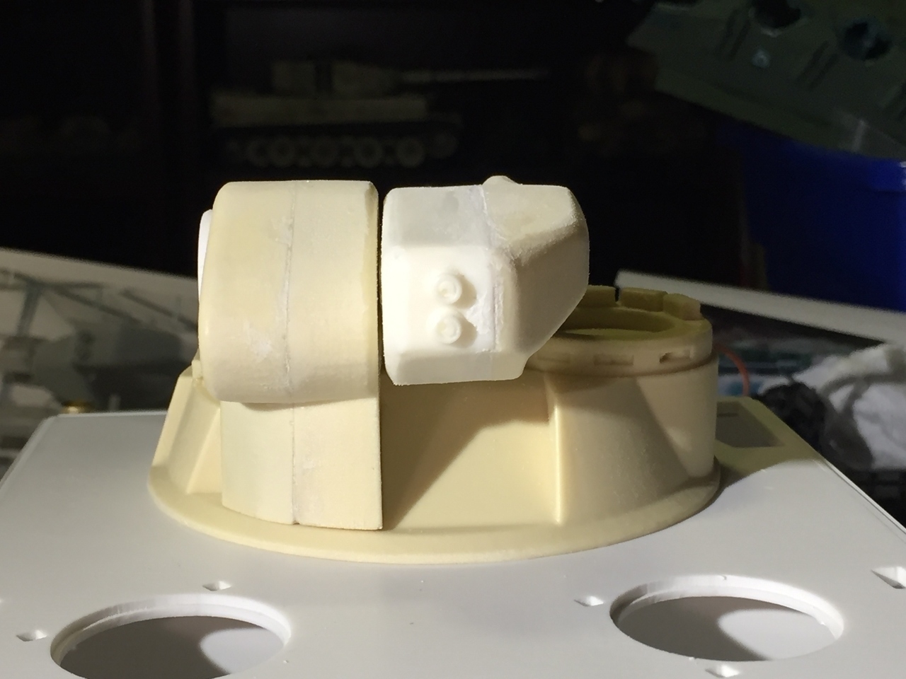

A bit of planning is required before going too far. First, once the resin parts are glued, that's it, there is no more access to the interior of the gun stand and gun unit. Here a 5mm aluminum shaft is being used to link the gun unit to the stand. A push rod is attached to the shaft in order to provide elevation and its connector will run down into the core of the turret through a hole drilled at the bottom of the stand. It is quite a simple arrangement. The cables are for the gun flash.
Ludwigs Marder 1A1
Ludwigs Marder 1A1
This is the stand. I put a washer between the stand and the movable gun unit in order for the elevation to be smoother. Resin against resin will give a lot of resistance and the elevation servo would likely have difficulty elevating the gun.
Ludwigs Marder 1A1
Ludwigs Marder 1A1

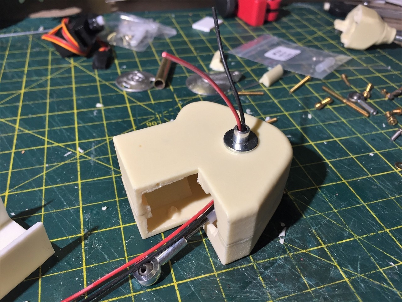

This is the gun unit. I made my own gun flash unit using a large LED to which I drilled a hole to insert the fibre optic cable for a better and permanent joint. Here also, once you glue and seal the other resin half, it will be impossible to get access to the interior of this unit, so test and retest everything before sealing. If you have to crack open it later for some reason, I think it will heavily damage the much fragile resin parts. There is much distortions in these parts and it takes a lot of care to assemble. Many applications of putty and sanding will be required to finish it correctly.
Ludwigs Marder 1A1
Ludwigs Marder 1A1
A small servo under the turret roof will provide elevation. I will install it later at the same time as the rotation unit to ensure no mistakes in the placement of the servo.
Ludwigs Marder 1A1
Ludwigs Marder 1A1
Here it is. the turret core. It only got its first coat of putty and sanding, a lot more is required to plug the gaps, distortions, air bubbles and to make it smooth and accurate. A smaller 4mm aluminum tube will be inserted into the left ring of the turret to hold the IR box that needs to be scratch built.
Ludwigs Marder 1A1
Ludwigs Marder 1A1
The turret needs a lot of detailing.
Ludwigs Marder 1A1
Ludwigs Marder 1A1
Ludwigs Marder 1A1
Ludwigs Marder 1A1
Ludwigs Marder 1A1
Ludwigs Marder 1A1
Now you can see where this is going. I am happy with the progress and I think it will be a beautiful Marder.
