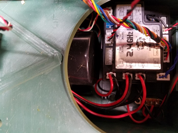

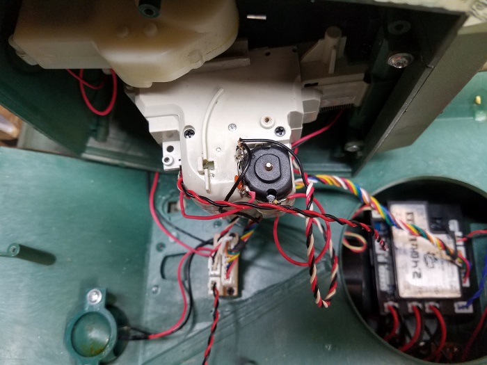

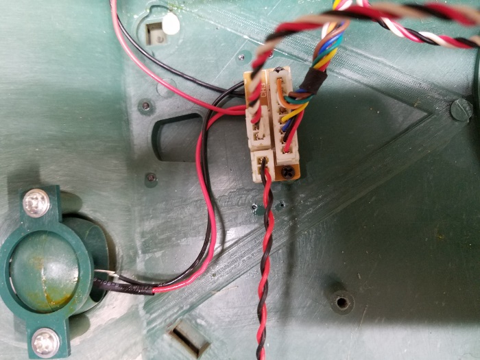

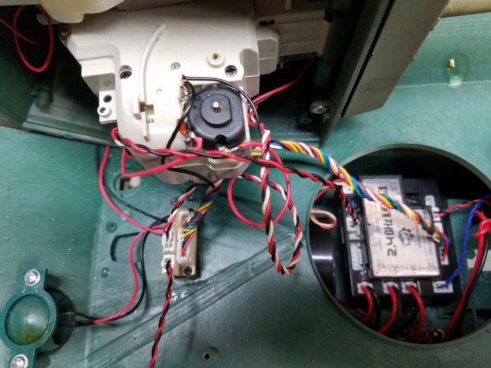

I bought this Panzer G model and the rubber sealer in the BB unit went south on me so I ordered a new BB unit. Got it all in and wired up. Just as I was putting it back together I discovered the black wire from the 2 wire plug had come loose. I originally soldered it to the manual shutoff switch by mistake. Dang thing would not fire. So I looked at my KT and rewired the unit as that one was. When I first turned it on the unit would not fire a BB. All of the buttons on the transmitter worked, MG, Smoker, Cannon sound w/recoil, turret moved left and right, up and down, but the BB unit would not fire. I then moved the left joystick down and all of a sudden the BB unit started firing continuously. So I rewired it again thinking maybe the solder came loose. No go. After that episode the dang thing went into I am not going to work again. I replaced the little Brown piece, must be a capacitor #104 (I had an extra from the old BB unit) and still nothing. So I am at a standstill. Here's some pictures of the pre and post configuration.
I think I am just going to buy a complete turret and put all of that into the turret on the tank I am working on. Somewhere I have burned, miss-wired, or something that has junked the unit.

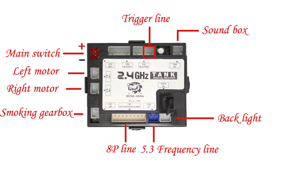

Not entirely sure whether your HL MFU board is actually the latest (I have no tanks with HL boards in now), but it looks to me as if the two pin connector from the Gun (in your PIC 1-Top) is in the wrong place. On Taigen boards, and I believe HL boards as well, the two pin connector should be on the two right hand pins of your five pin connector. That is pins 4 and 5 from L-R. You have it on the 2nd and third (LH) connectors, I think.
It's hard to tell from my iPad, and with my aged eyes.
Check this diag out (below) and there are many more wiring diags to access through the 'Search' utility, Steve.
HL 5.3 MFU connectors
HL 5.3 v MFU connectors.jpg (99.75 KiB) Viewed 2816 times
Note the position of the 'Trigger Line' socket. That's where your two pin connector should go. At least, that's definitely the case on Taigen MFUs (basically the same as HL :)
This socket triggers the recoil/gun sound etc., and completes the circuit to the microswitch. If the gun's already SNAFU (hopefully not), they don't cost all that much. Just be careful next time and use the wiring diags here before reaching for the soldering iron... :thumbup: An entire prewired turret might be an answer; but it will be more expensive than an airsoft unit, and will still have to be connected correctly....

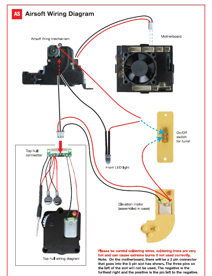

Re: BB Firing issue
...and here's the Taigen version of an airsoft wiring diagram (freely available from the Imex/Taigen website :thumbup: )
Taigen Airsoft Wiring Diagram
You can see where the 3-pin plug is supposed to go, and how..if reversed it would seriously after the gun's firing algorithms..( :D )
