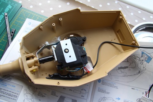

Rad_Schuhart wrote:I think you put the flash unit wrong. Once insfalled propperly, it wont move anywere. If I remember correctly the wire goes trough a side, and not through the back.

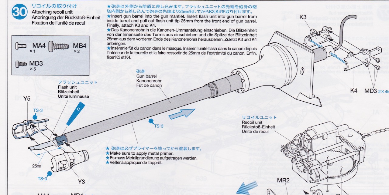

I'm afraid your memory has let you down a wee bit here Rad. :problem: The flash can only be inserted into the breech (a bit like a suppository :haha: ). There's no provision for side entry. Look at this illustration:
Inserting flash unit into barrel..
What may have confused you is that in my pic the whole barrel assembly is upside down. I had it orientated that way to make it easier to fit that fiddly wee white plastic elevation lever- you know, the one you said was apt to break. :)
I've since managed to test it and it works without hindrance, and that's what really counts. :thumbup:
The attachment Tamiya KT flash fitting 1.jpeg is no longer available
I've since managed to test it and it works without hindrance.

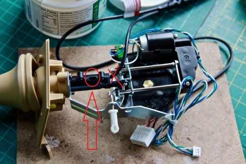

Nope, I think I am right.
I mean the flash wire, at the end of the barrel, it does not go through the bottom end. It goes through a hole in the side, between the two halves on the plastic. Doing that way the flash unit stays always on place.
And the part that breaks is this one:

Re: Tamiya Königstiger- a blitz build
Post by silversurfer1947 »
I think Rad is right. If you look at the instructions, the cable goes up through the top of K3/K4.
Richard
I'm beginning to feel a Fawlty Towers moment coming on...thoughts of Basil and Manuel. Right, well, as I say Rad, the recoil works flawlessly, and the flash unit is firmly fixed in place with double sided tape. I don't suppose a positional difference of 15mm or so is likely to be critical. When I've finished the entire project, and encouraged dear old Tom to find a flavoursome hat :haha: :haha: ..I'll go back over everything and double check that everything is as it was intended.
As for the arm that's likely to break, it'll have to break before I replace it. After all, would you replace tracks just because they're likely to wear out some day? :problem: Just a thought. Maybe Tamiya have secretly toughened the wayward
link as result of complaints. Que sera, sera :haha:

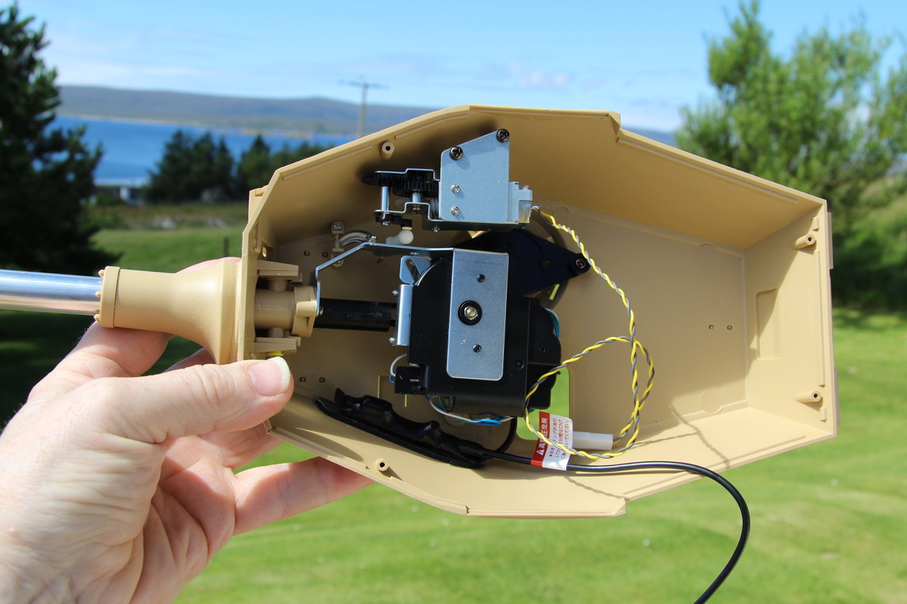

Barrel assembly bonded into turret..
and now the Elevation unit. Like most parts, fitting it requires a little manual dexterity (here the white plastic elevation adjuster is a tad tricky for older hands), but in the main it's fairly easy. As I said earlier, these Tamiya tanks really do fit together
with the sort of precision and exacting standards demanded by rivet counters, and OCD types.. :lolno:
Elevation motor fitted with guest appearance of the Sun

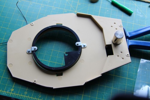

Fitting counterweight to Turret floor plate
It took several doubles takes for me to realise- and no doubt the eagle-eyed amongst you will have noticed- that the turret ring should be on the other side of the turret floor :{ :haha: I was having a topsy-turvy moment comparing the
illustration with it's 3-D realisation, before I twigged my error. By then I'd already taken a pic, and could nae be ar**d to take another. :haha: My chief concern had been to get the Counterweight in the optimal position and secure it there
with two-part epoxy. The epoxy took around 5 mins to begin to grip properly, and in the meantime, the weight began to wander :O So...i had to tape the errant part in place with parcel tape until the following morning.
Incidentally, these pics I'm posting are a couple of days behind the actual build state. Still, I reckon it will take not much more than two weeks from Box to the paint finish, if i keep chugging away, and the Sun then intermittent showers weather pattern gives way to lasting Summer Sun.. :problem:

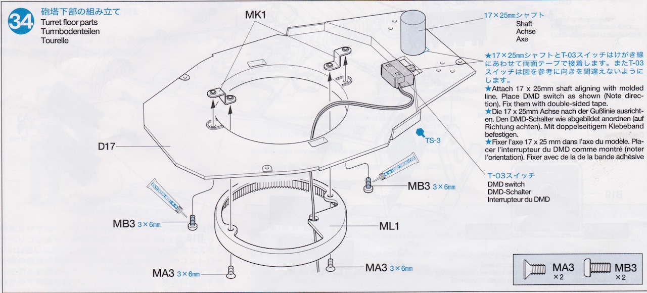

This is what Tamiya instruct you to do:
Counterweight location
