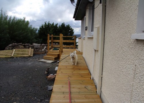

In preparation for the Cromwell's 'field trials' (no joke in my case, as my garden's surrounded by fields :haha: ), and for access to the KT and other tanks, I've been building a ramp to enable my Tanks to get in and out of the house under their own steam- so to speak. It's almost complete. But here my sternest critic is telling me how it should be done. She's a Backseat builder: a four-legged one at that .. :haha:
So, here's the Tank-ramp:
Tank-ramp under construction
This is the sort of trouble you go to, when the addiction is uncontrolled :-< :haha:
On a positive note though, the next time I break my ankle and find myself in a wheelchair again; I'll be properly prepared :thumbup:
