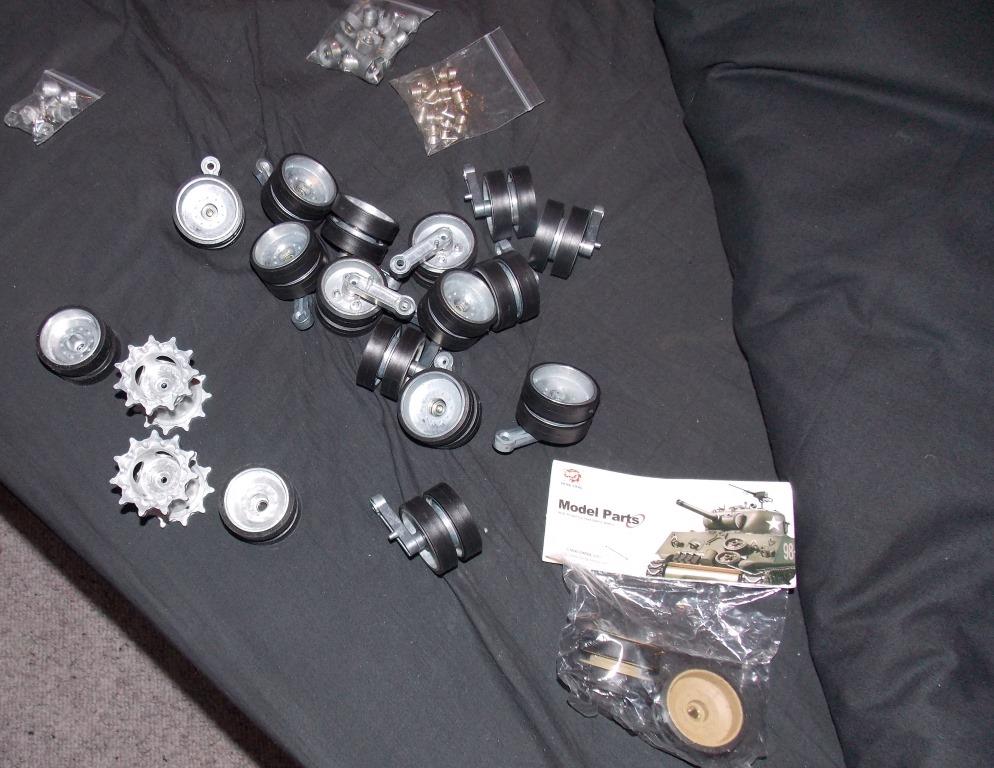

Off sick today with chest cold, but got presents from the postie! Roadwheel's,two sets of idlers..., sprockets and suspension turned up from tankarmy
So I set about taking the suspension arms off the roadwheels and the masked up the rubber parts and axle ends. Painted 3 wheels tan just to be different (most Ozzie tanks have all green wheels from the pics I have).
Will fit em' to hull on weekend.....definitely a lot heavier than the plastic wheels!! each plastic wheel and suspension arm weighs 16grams the metal ones are 84grams!! over 1.184kgs!!
Question!! is there a particular order/method to fitting the suspension/springs that makes it easier?? and do you grease the bearings or just some light machine oil??
Bruce
