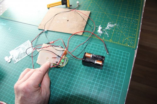

Travel was something in the order of 19mm. Now for the elevation, but for that I needed to wire the whole thing up and cycle the movements. I got a flash, a bang (speaker), but no wallop! The elevation unit worked.. but it's horribly noisy, but the recoil motor seems to be dud. I ran various tests..including using my trusty continuity tester, and 6vdc battery pack (simple testing DC motors).
- Recoil motor dead as a DC Dodo..
No joy. Even if the capacitor was a dud, and the soldered connectors dodgy, the motor should still spin when connected to a dc source.The recoil motor is actually +/- sensitive, unlike most DC motors, but in the event not even Lazurus could get any life into this crappy thing
I've sent off for another motor, and I'll probably rewire the unit along the lines of Open Panzer's simplified arrangement, (same as Aussie kev's); but for the moment, it's bye bye Asiatam
