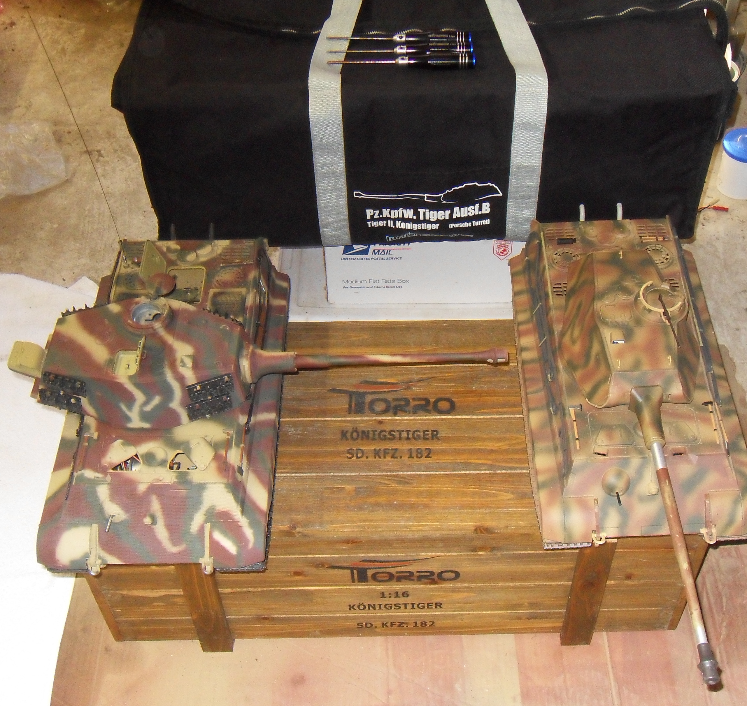

My TIGER AT 20LBS USING GRAUPNER SPEED 400 was pushing the max. 1.5amps and that was barely possible because of the double fan system and heat exchange rate,I had low end power due to gearing,yet these motors would solve so many problems for my Torro King Tiger and even my Tiger. Ok where to purchase the motors and the pinion gears,as that was an issue as well.
I have been absent to long in 1/6th land. My Torro needs some power,lets hook it up. The KT deserves the power.
Saxondog
Posts: 4293
Location: Tennessee-U.S.A.
Re: Heng Long Tanks - Advanced Modifications
Post by Saxondog »
The stand alone electronics will be the key, and possibly resurrect several of my older tanks which just cooked board after board because of the amperes frying the RX18's. Stand alone electronics will though present the same issues of feature control and sound? Look forward to your solutions Chris.
Cheers,
Blake
My last two builds before I stopped and life got in the way, these tanks have some unique features,the PORSCHE has my last recoiling airsoft gun design and SUPER SMOKER which I mention because of the stand alone controls issue. The Torro is basically stock but needs a working gun,smoker and massive power as it is my best tank. I am certain Chris your ideas have value in helping me achieve my goals.So here we have two test monkeys,lets create a monster pair ok? :thumbup:
Torro Henschel KT and Waltersons Porsche KT
