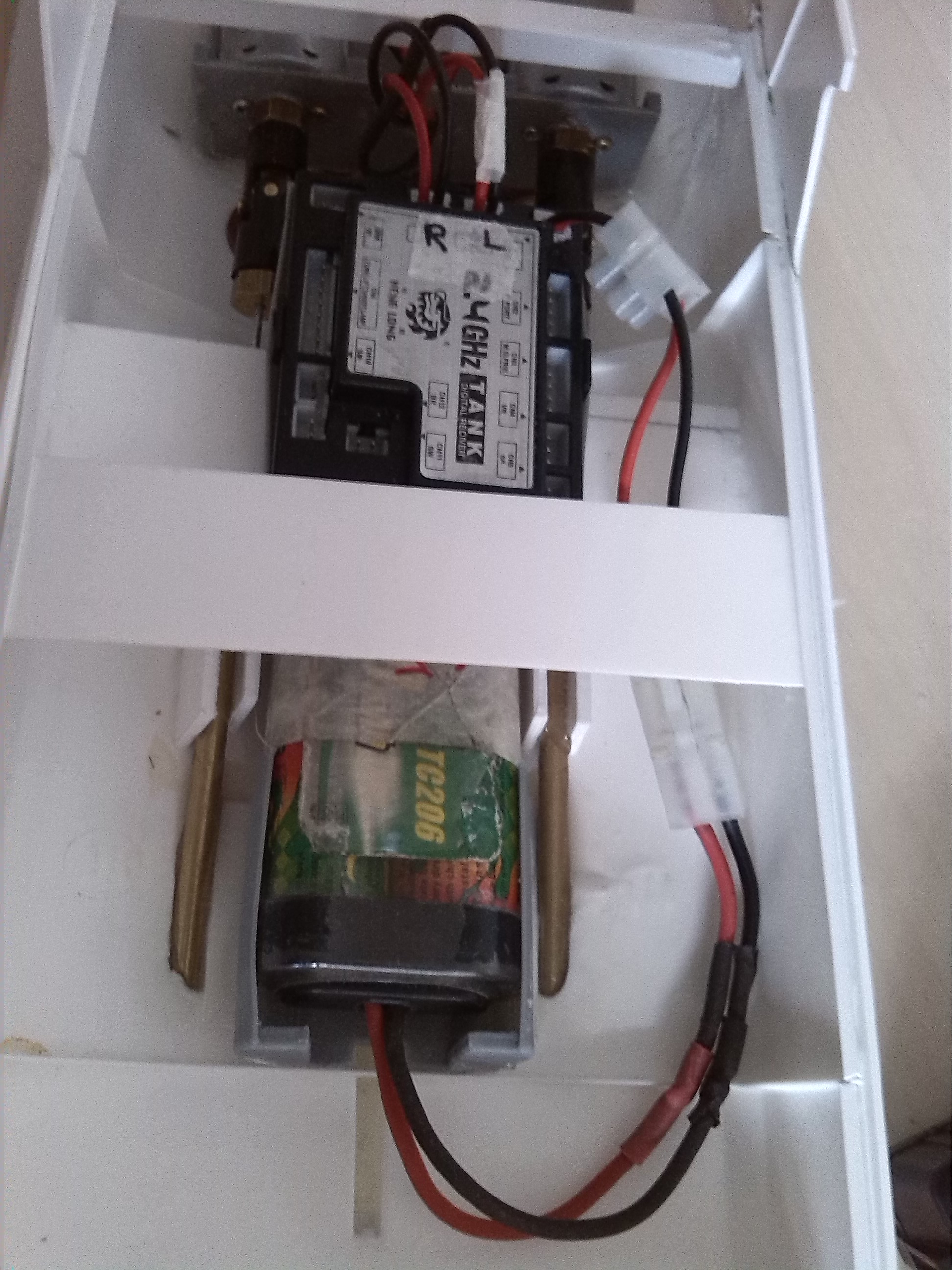

Managed to shoehorn the electrics and running gear in. It's all 100% watertight, it goes forwards/backwards etc, and turns on the props though for some reason it turns better one way than the other, though this may change in open water.
I have been using coins to ballast the hull as I can take them in and out and move them around to get the weight where I need it, and everything including the battery is mounted securely to ensure that there is no weight transfer and a capsize when it's running. I am running 2mm shafts which are made from very soft metal, and one is out of true. The good side runs silky smooth but the other vibrates. Getting hold of hardened stainless 2mm shafts with M2 thread on only one end is proving rather difficult. so I may have to try and true up the one that I have, or buy another.

Thanks for the offer but I think that the coins will do the job, it doesn't take much to bring it down to the waterline. I have spent today ripping everything out of the hull, and using a heat gun to warm the plastic and gently easing the whole thing straight again. It's as close as I can get it, not 100% perfect but better than it was. If it looks out of true when the decks go back on I will write and ask Revell for another one, I'll have nothing to lose.

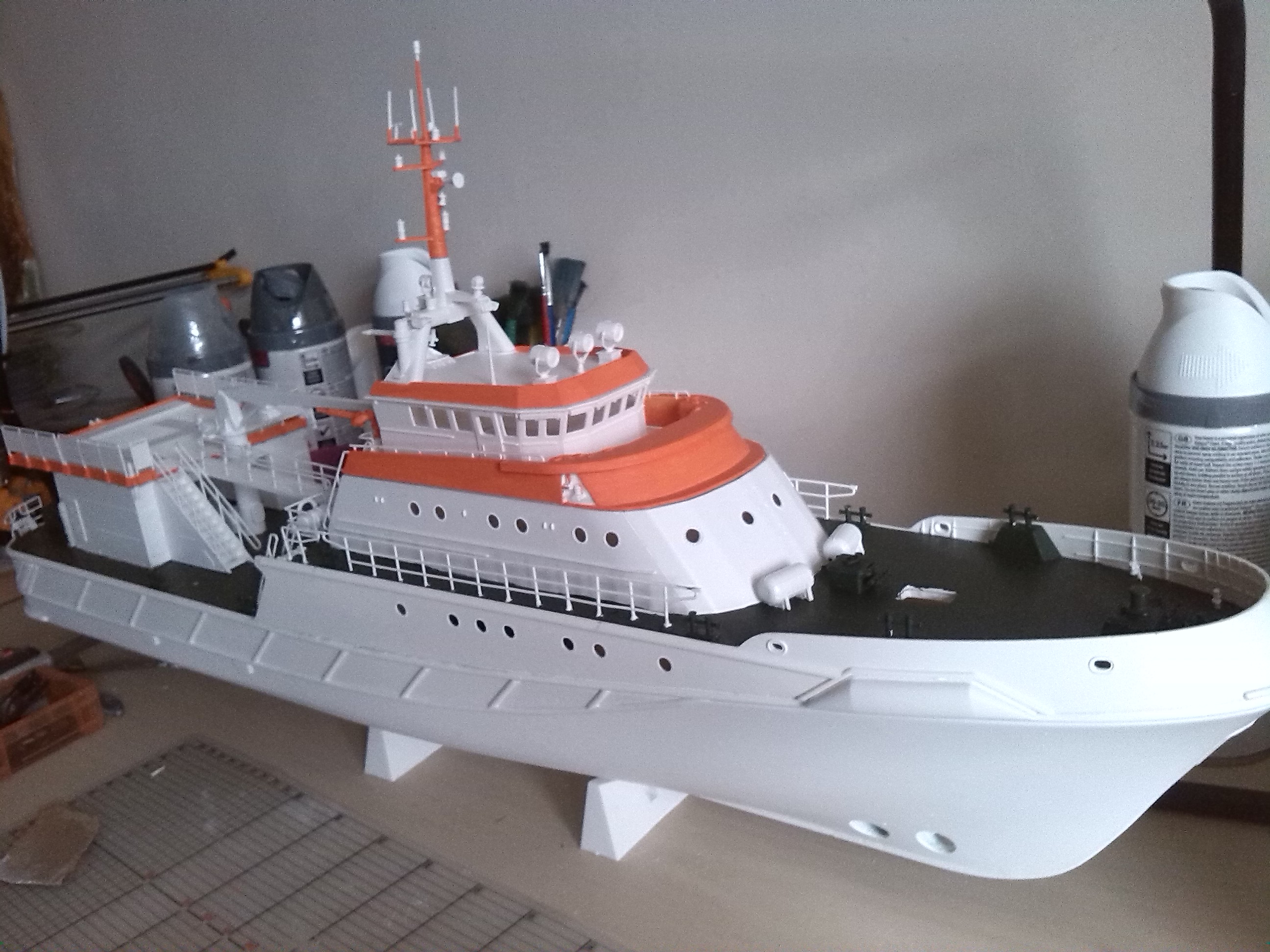

Made a start on painting. Used rattlecans for the white as an airbrush would take all day. White primer and satin white topcoat, Vallejo Military Green for the decks, and Vallejo Bright Orange for the orange parts. Still loads more to do but it's looking like the one on the box lid now.

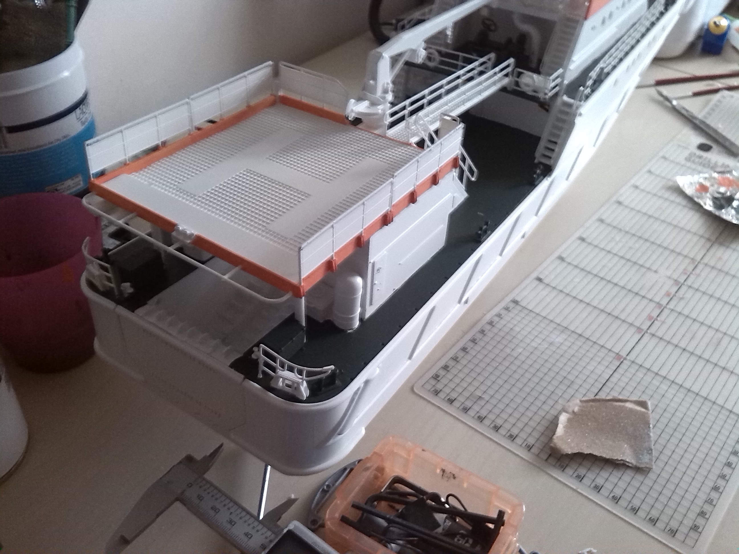

I'll be glad when its finished, I keep thinking there isn't much more to do but then hit another problem. The painting took a week?
That said, the front raised deck can be glued and sealed, the rear lower one can be removed via screws to access the battery, propshafts, and RX18, and there is an on/off switch on the rear deck. Ballast is only in the front and is coins that are epoxied to the bottom of the hull.
I have to keep thinking four steps ahead as once something is glued in I can't risk blocking access to something else that I need to do, and I need to ensure that whatever I do by way of the build, that I can still get the rear deck off. There are gantries and cranes that bridge the two on the static model, but I can only attach one end on the RC conversion.
It's getting there though. :thumbup:

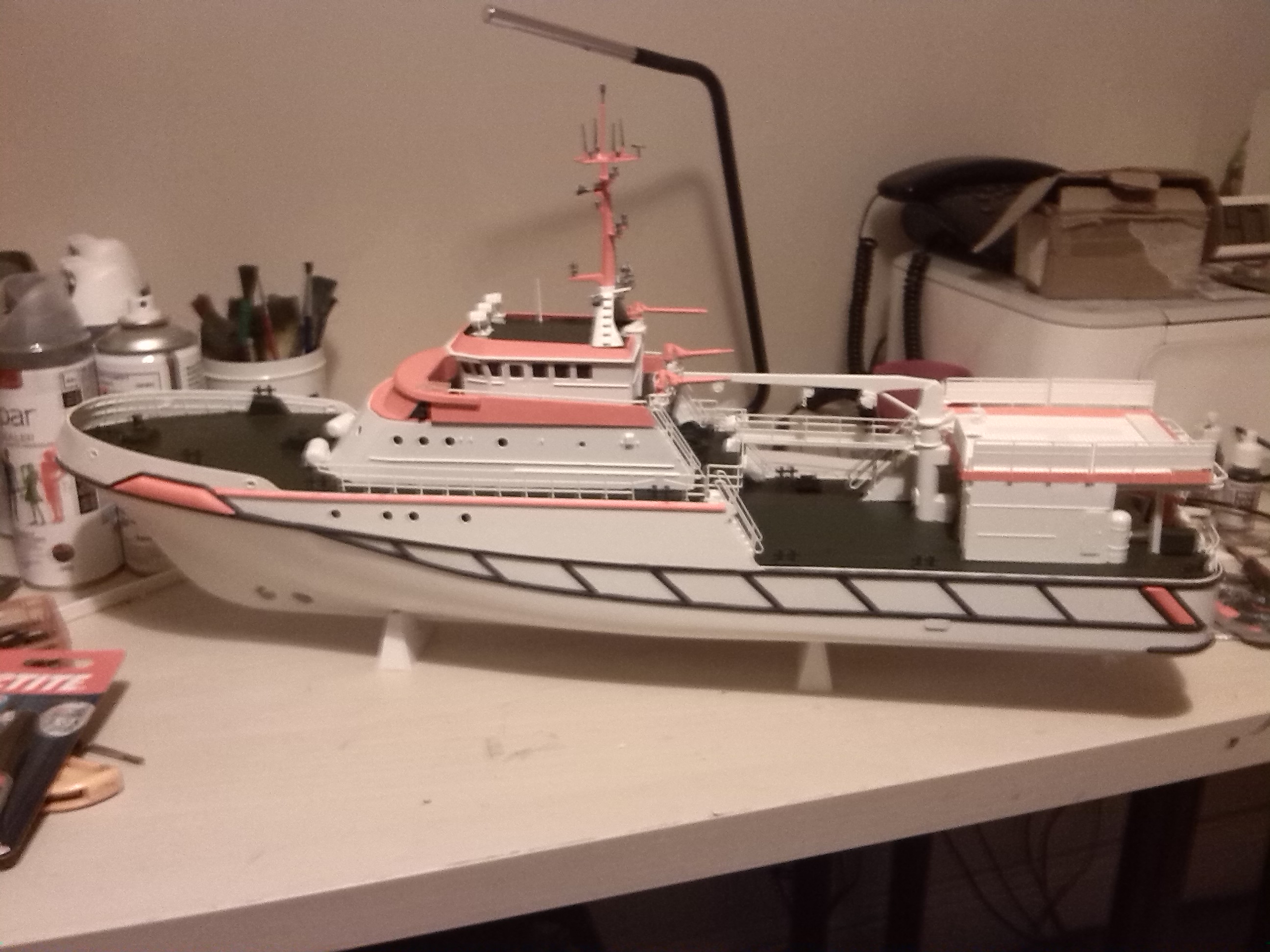

On the final run now, all of the painting is done, I have built the launch that goes in the rear, all of the windows are in, the front deck is glued in. Need to affix the decals, and solder up the switch wiring, then give it a going over with satin clear coat.
The colours look a bit washed out in this lighting, the orange bits are deep orange.
