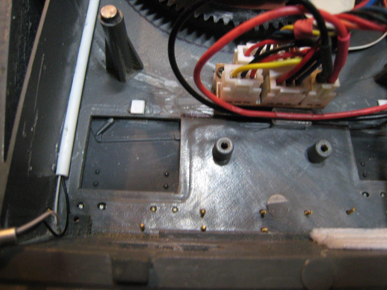

One item that needs to be adjusted is to refit the transmission covers so as to accommodate the drive shaft support bearings and the raised drive shafts. To fit over the support bearings, I used a Dremel sanding disk to sand out interior of transmission cover to make room for bearing/reinforcement. Minor adjustments could be made by scraping the inside with a hobby knife. The HL transmission cover uses two locating plastic nubs and a Phillip’s head screw to hold it in place. On one of them, I had destroyed one of the screw points on the hull because the factory had both glued it down and screwed it down. So, I figured this was a great opportunity to make it more realistic and get rid of the screw entirely. So, I made these adjustments:
- Drill out the nubs with 2-mm drill and insert metal nubs by cutting sections of an old clothes hangar.
- Drill out the screw hole using a #1 drill bit from the outside (detailed) side of the cover. From the inside, enlarge the hole with a 1/4" drill bit that sinks about 2-3 mm deep. (I’m using a 1/4" round neodymium magnet.)
- With the gearboxes, drive shaft and support bearing mounted in place, mark out the location of nub holes and the center hole. I used the forward (nearest front glacis plate) nub hole as a pivot point. Then, I found and drilled the second nub hole. With the new metal nubs installed in the transmission cover, I could lock the cover in place and use the # drill bit to mark the new center hole.
- With all holes drilled, I installed a 2x2-mm cylindrical rare earth magnet in each nub hole using JB Weld to keep them there. (Note: magnet orientation is not important in the nub holes because the nubs are steel, not magnets.)
- I filled the center hole in the transmission covers with Milliput leaving a small gap on the inside for the magnet and epoxy. I installed a 1/4" magnet in the hull side and then another one in the transmission cover, securing them with JB Weld. (Note: get the magnet orientation correct in this step or the 1/4" magnets will repel each other and the transmission cover won’t seat against the hull.)
This whole process also gave me the opportunity to glue in the styrene plates that would reinforce the front hull sides. And, I used some of the extra Milliput to fill in some of the hack job that happened as I tried to find the right spot and height for the drive shafts.
Note: before doing any of this with the transmission cover, you need to have the final position set for the gearboxes. This drives where everything else fits - support bearings, transmission cover, hole placement in the reinforcement plates, etc.
Also, I recommend doing this over several days and letting the epoxy in each step harden before moving to the next. Reinforcement plates, then metal nubs, then hull magnets (with cover magnet loosely seating to get the height correct, finally the cover’s 1/4" magnet.
