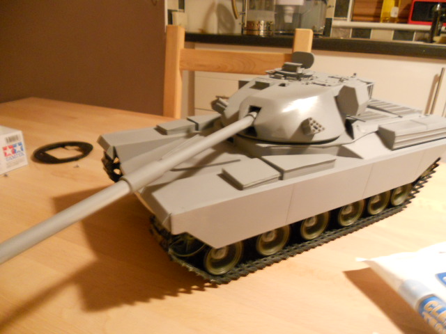

Blooming day I have had. Decided to try and print the turret baskets rather than make them out of brass rod.
The first pair fell apart when I was removing the flashing.
The second pair cleaned up nicely and I glued them on.
I then realised that the rear boxes were too tall, and that the baskets should be longer and shallower.
I then realised that the bustle was still about 1-2mm too deep and was going to hit the rear deck and boxes.
So I had to pull the old boxes off, redesign and reprint the baskets yet again, then redesign the boxes and print those, and then slice material off the bustle base...which was a pig of a job as it was a large slab of 3D printed PLA. @)

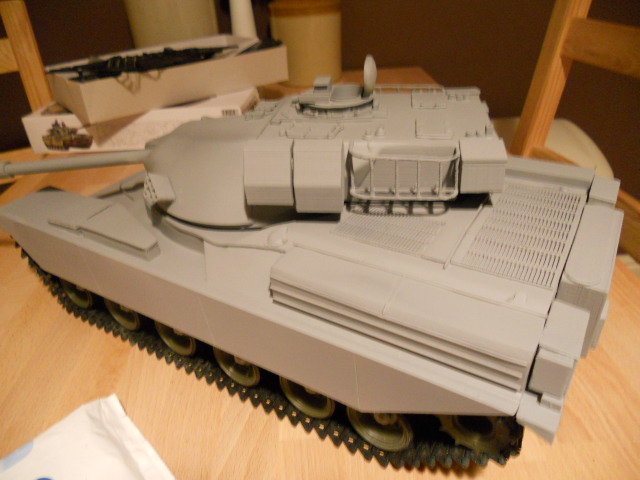

Managed to get some more of the turret paraphernalia done, not perfect but reasonably close, more angles and bevels than my brain can cope with...

Looking more like a tank now
