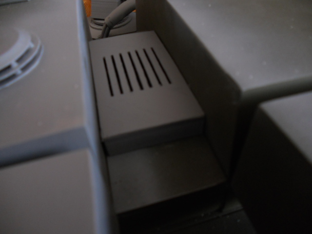

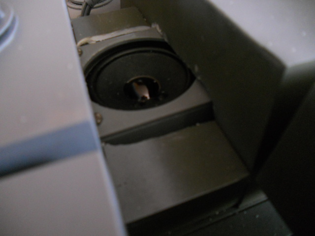

The spare speakers arrived yesterday, so I set about fitting one. There is no room at all in the lower hull so I had to cut into the top from underneath. This was pretty awkward as I was cutting through several layers of styrene and had to maintin a square cutout, and avoiding wrecking all of my work.
It was at this point that my trusty multitool that I bought from B&Q about a million years ago decided to cry surrender. There is a torsion spring between the motor shaft and the output/chuck shaft, and this decided to shear off. I have found a spares supplier in Southampton and I am hoping that they carry the spare spring, if not I will have to make something. I then had to use my Dremel, which is not good for styrene as even on the lowest speed setting it is way too fast for sanding, and at that speed it has no torque. The B&Q one was perfect.
Having cut away styrene, I printed a speaker box, mounted it up in the hull, and then printed a cover to allow the sound out.

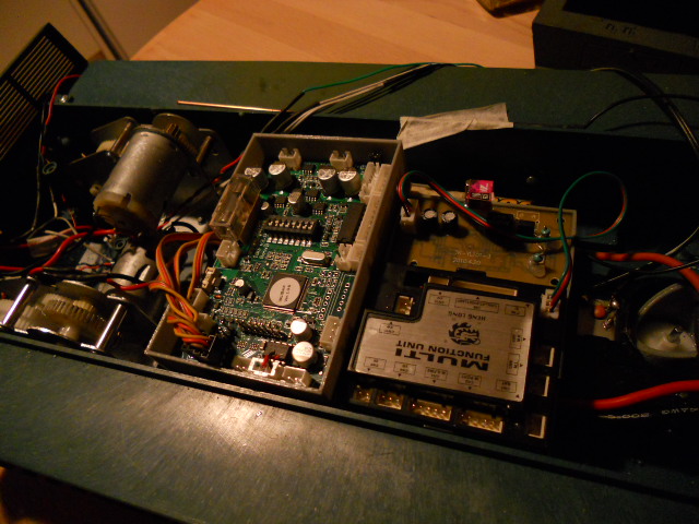

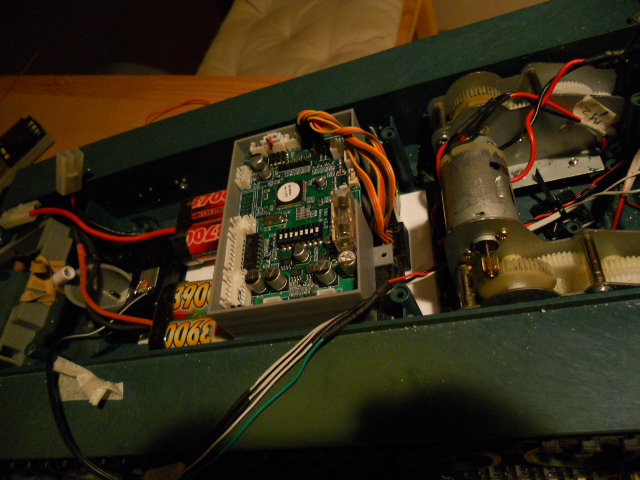

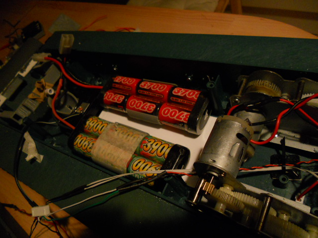

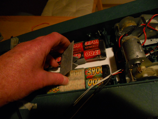

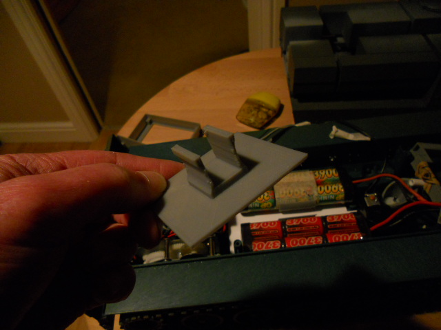

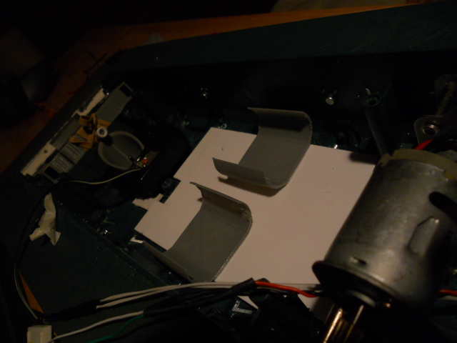

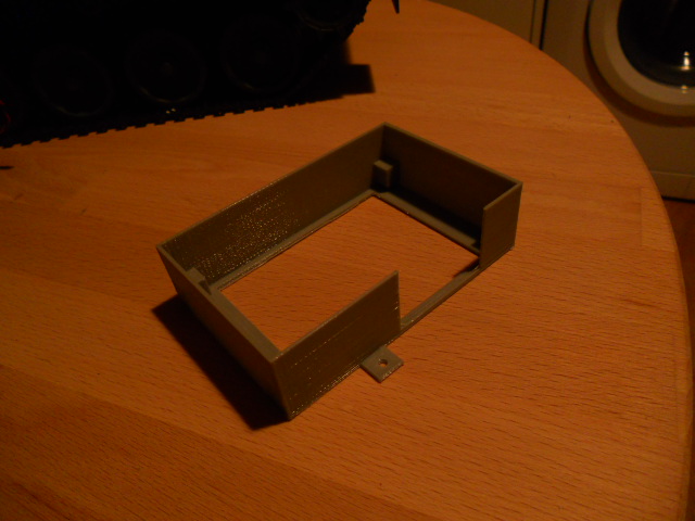

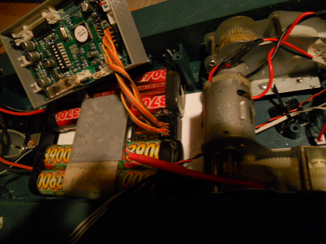

The inside of the Kodiak was looking a bit of a dog's breakfast, and it really needs two batteries, one for the IBU2 and one for the RX18. The problem was how to mount it all nice and neatly so that I could remove the batteries and boards if I needed to.
I hot glued a flat styrene sheet into the lower hull after cutting out the battery box.
I then created two battery clips. The batteries simply drop into these.
Then I created a platform that clips between the two batteries.
The IBU2 receiver fits in the gap between the batteries.
I have one custom tray for the IBU2 that allows airflow all around it, no glue the board simply clips in, and has access to the SD card. So no grubby fingers need to touch the board at all.
I have a similar double tray for the RX18 and receiver.
So, it all clips together, and can be pulled apart anytime anywhere.
I have removed the two hatches on the rear panel and will mount two on/off switches under these if I can figure out a neat way to get access to them.

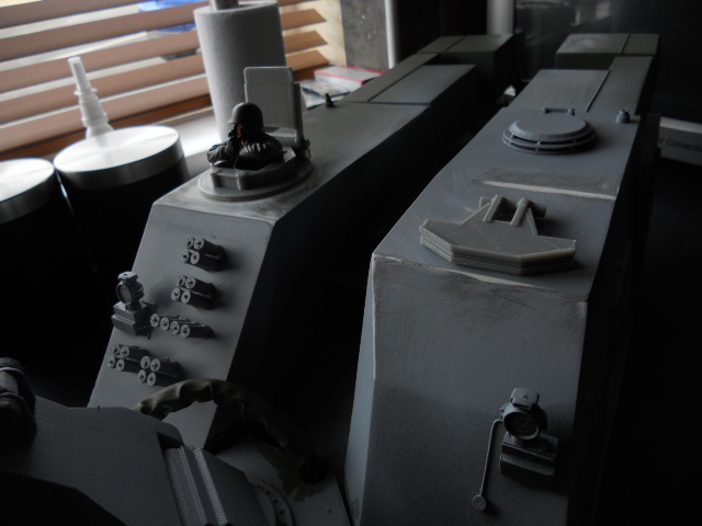

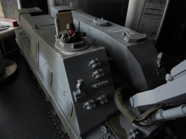

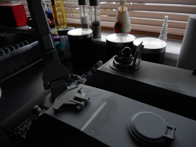

Reworked two of the hatches now that I am getting confident with my Openscad abilities, the open one will have a Bundeswehr commander in it, with two switches for the electrics mounted underneath him. The original ones that I had on there were a guesstimate, and it was only because I came across a 1/35 scratch build that I discovered what they really look like. I have to say that the build I found was pretty mind blowing in detail??
http://leopardclub.ca/ReadersModels/Osc ... a_Vasquez/
It wouldn't last 5 minutes in an RC environment, but hats off to the guy. He is a modelling God.
I don't know what other people's views are, but I tend to think that if there is one thing that makes a tank look 'scale' it is a figure or two sat in a hatch.
