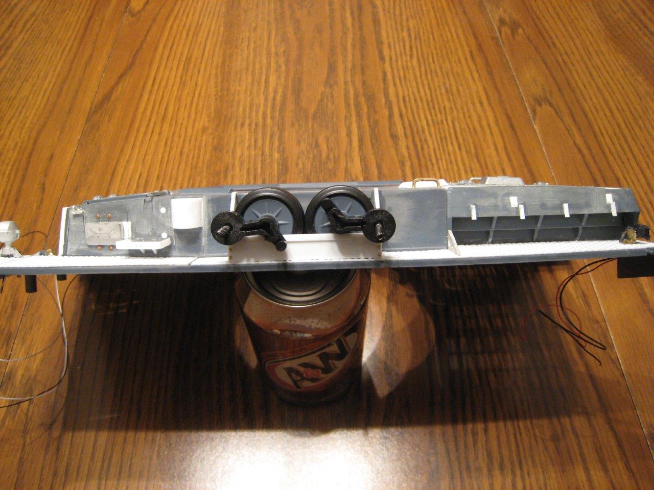

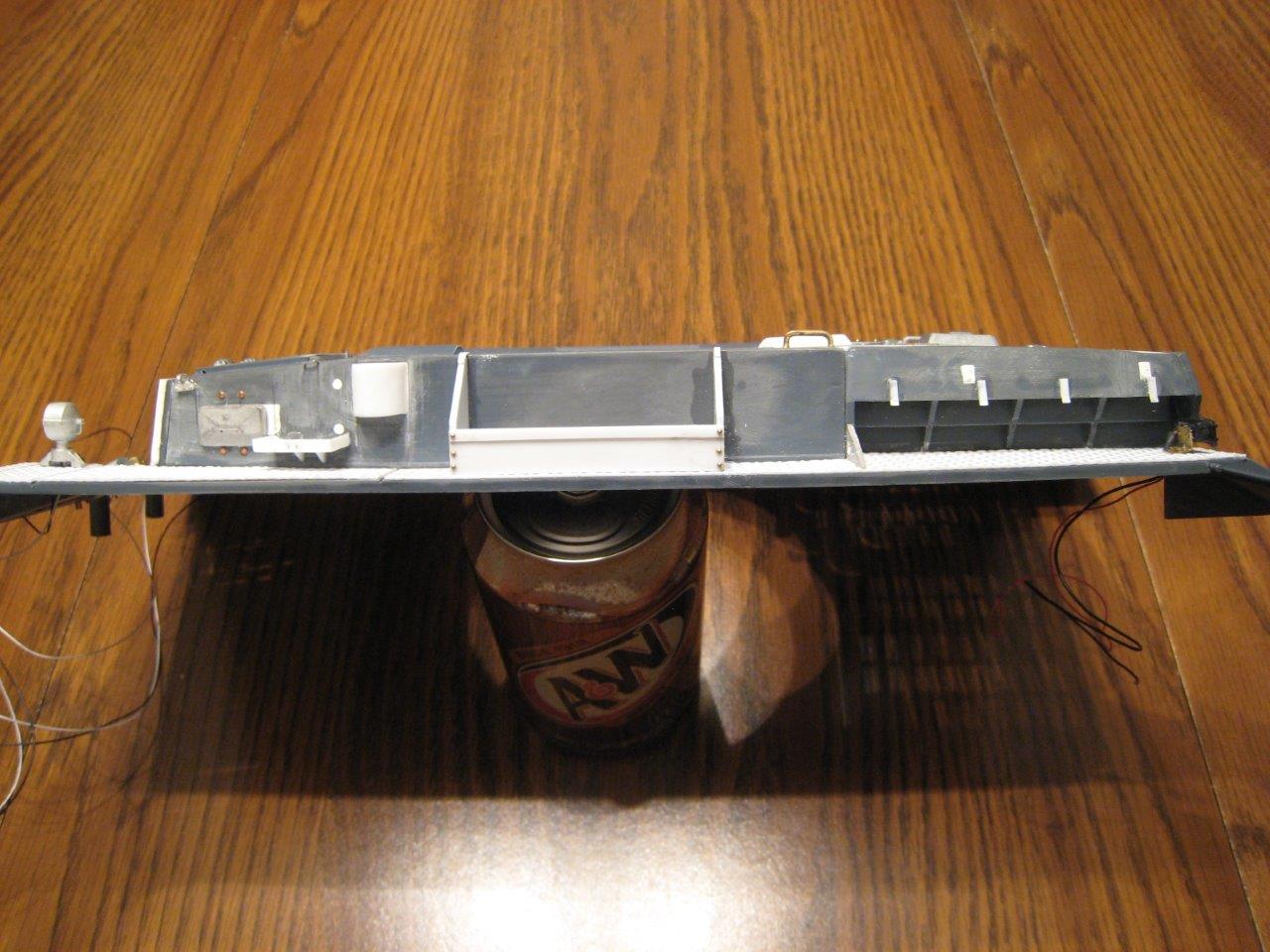

Got a little more done. Amazing how much time it takes to complete something that I thought would be an easy and quick detail to do.
Headlights: added the “lamp cables” using brass wire and hex rod. Tip: prepare this part before gluing the headlight into place. Don’t ask... :{
Convoy light: got this installed. I used the same parts and setup on my PzIII build. The difference this time is that I had .8-mm hex head bolts, which gave a better scale appearance. So, I used them on this build.
Spare road wheel box: I built and installed that. The road wheels are a snug fit (still need to take the suspension off of them).
Questions for the history buffs:
- There are two styles of these boxes. One has higher walls with a bracket for a holding bar that runs between the outer and inner wheels and keeps them from bouncing out. The other has a more angled side wall (like the one I built). How were the road wheels secured in this setup? I’ve found that nothing stays on an armored vehicle unless it is bolted or tied down, regardless of how heavy it is. These look like they’re waiting to get bounced out.
- I read somewhere (don’t remember what blog or forum) that the road wheel box was either omitted or used for something else by the Afrika Korps. Can anyone confirm that or provide more information?
- Did the Ausf G use the reflector on the right (starboard) fender? I have the one that HL provides. But, generally, I’ve only seen the Gs with the reflector on bottom edge of the left (portside) mud flap below the convoy light.

This is looking great!! I have seen MkIV's in Afrika with three wheel long boxes, two wheel boxes of both types and make-shift boxes usually just being a metal bar bent into place. There is no right or wrong answer unless you are trying to do a specific vehicle.
philipat
Posts: 530
Re: DAK Pz IV Ausf G Build
Post by philipat »
I am trying to use the Spade 7 as a the basis for this build. But, I can't find any photos of that side of that tank. So, it sounds like I have some flexibility in that one. :)

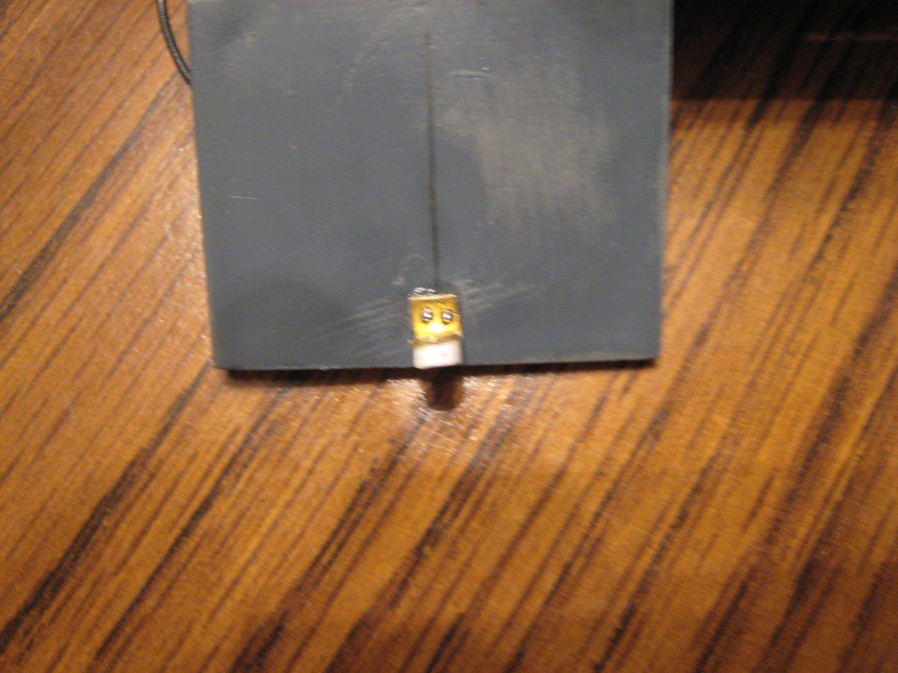

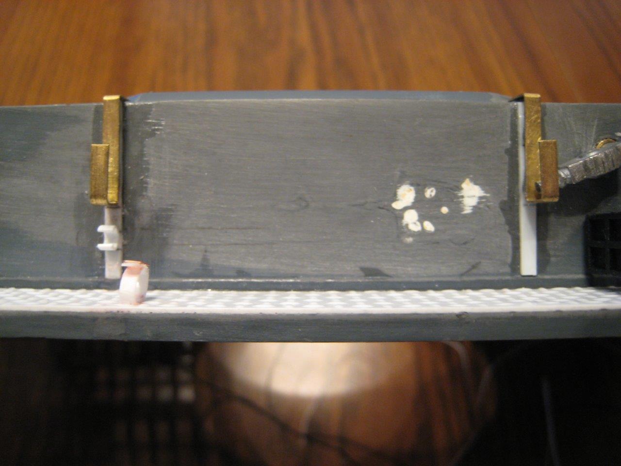

- I fabricated the reflector that sits on the left, rear mud flap. I made it using brass strip (F-1x-4 from http://www.specialshapes.com) as the frame and 1/8" (3.2-mm) styrene rod and tube cemented together with plastic weld. I was concerned with how well it would stay attached to the mud flap, even with 2-part epoxy. So, I drilled two .6-mm holes and added 1-mm rivets. These I bent backwards and epoxied everything into place. Hopefully, it survive a few small bushes when my driving isn’t so great. ;)

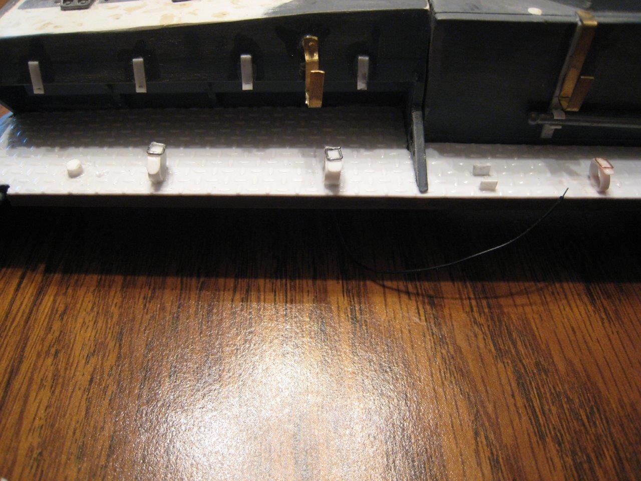

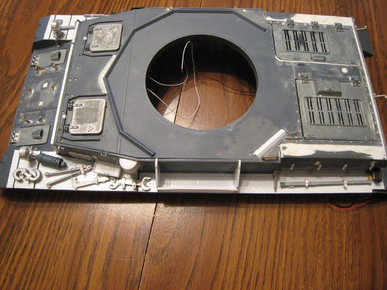

- Next big thing was to layout the tools and add the bits that would “secure” in place...something to add some realism rather than just gluing them into place and having them float along. First layout tried to blend the directions in the Taigen and Tamiya manuals. But, I realized that it wasn’t quite going to work. So, I made some of my own adjustments. Probably not exactly right, but you get the idea. The straps were made with .3-mm styrene cut into strips 1.5-mm wide (2.5-mm for the long box wrench). The silver buckles are standard office staples. The copper buckles are individual strands from 22-gage electrical wire. The styrene shapes and straps are welded to the tread plate using plastic weld. Most of the shapes are .5-mm styrene sheet cut into strips and set in place. The wire cutters use 3-mm L-shape. The circular clips are more of the 1/8" styrene tube hollowed out (to a #52 bit, if I recall correctly). I slid it over the crank handle and then cut the top piece out. The crank handle was a good guide for getting everything right. If it was a slightly snug fit over the handle, then I had hollowed it out just enough.
With the filling and sanding completed, I believe that I have completed the detailing of the upper hull, unless someone sees an egregious omission.
Gotta figure out what to do with the tools, though. One option is to prime and paint them in their entirety. The other is to try to blacken them slightly just to dull the shine. Then, prime the portions that should either be painted (hull brackets, for example) or represent wood (like handles) and then paint them appropriately. Any suggestions?
