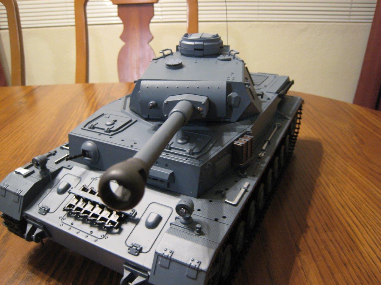

Basic start...two mods already done. I turned the commander’s cupola around since it was on backwards. At least, the current generation has the hatch properly aligned down the center. And, I installed the correct muzzle brake, which is a Panther G metal brake from Mato. The end of the gun tube is threaded (for real...HL threaded it). The brake wasn’t, but the metal is soft enough to use the gun tube to cut threads into the brake.
And, many of the upgrade parts are here. I think that I’ll start at the top and work down. Turret, upper hull and then lower hull.
Airsoft gun works, too. :) Might have to upgrade it with Taigen’s, though.

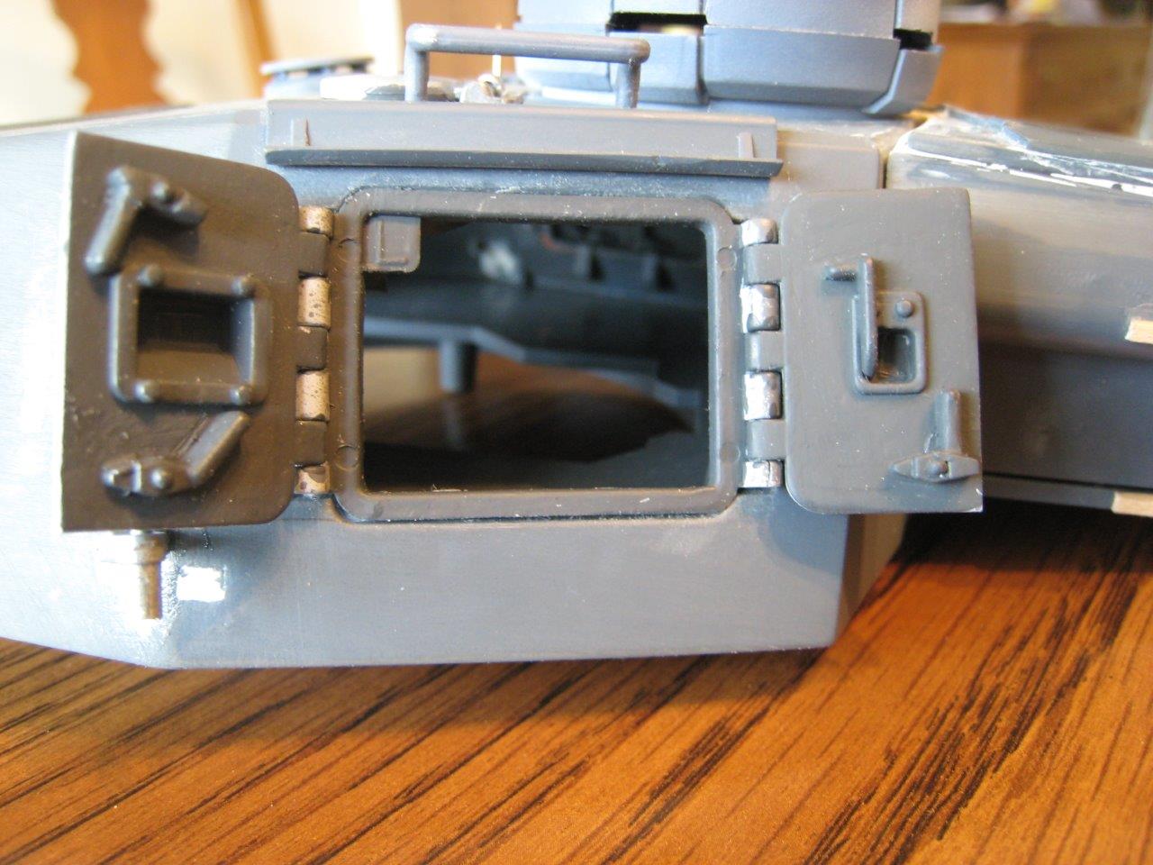

- Fixed the commander’s cupola. HL has it installed backwards. (Note: see the attached photo with placement of the internal locking mechanism. Photo is from pg 21 of Squadron Signal's Panzer IV, #6081.)
- Corrected the turret side hatches and removed some of the casting artifacts.

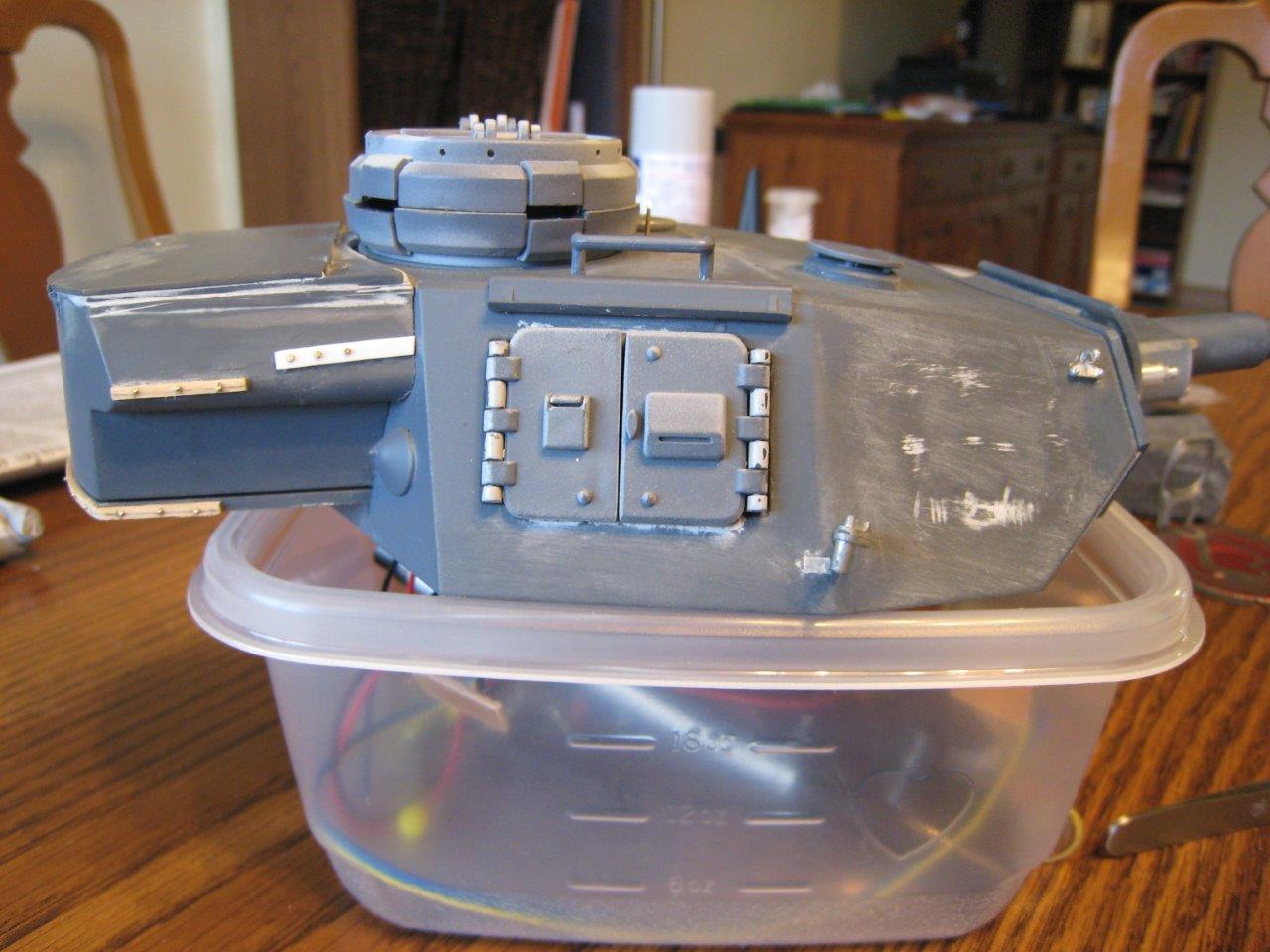

- The turret signal port (aka, hatch for loading airsoft BBs) has a tendency to flop open. So, I used a little JB Weld to secure a small piece of steel (soup can lid) and a 2x2-mm cylindrical magnet to the hatch and the opening in the turret. That will hold it closed but still allow me to load it with BBs.
- Reassembly...looks a bit like an Ausf G’s turret now.
