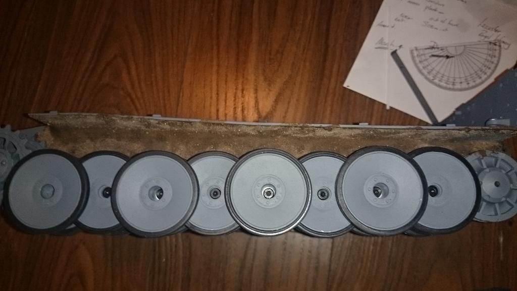

Got the wheels on tonight

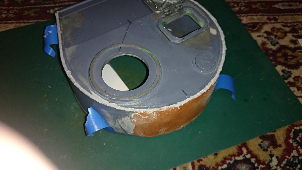

And have been filling the gap created when removing the stowage bin. It looks a bit rough at the mo...but worry not ( I hope 8) )

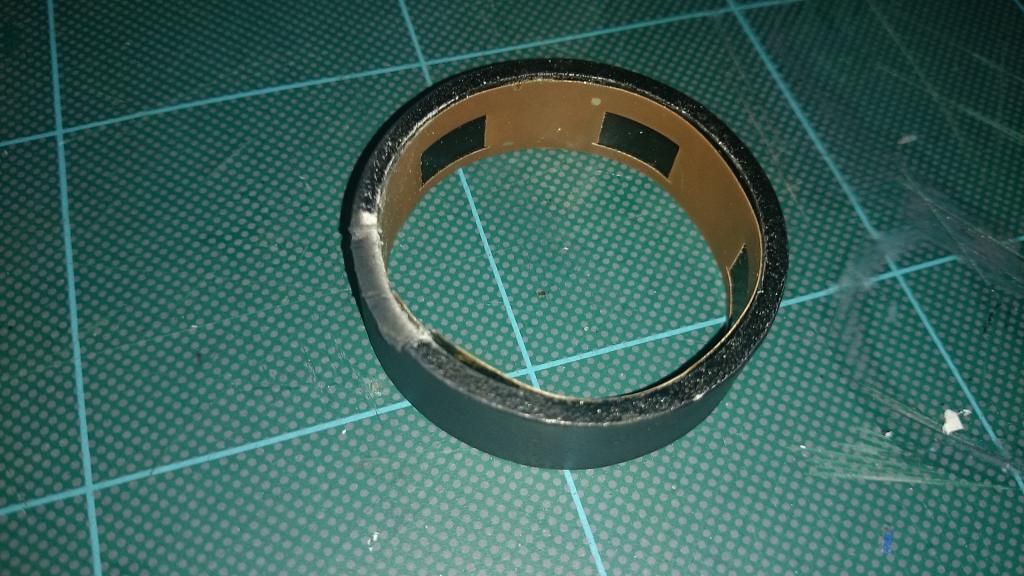

So I thought I would have a go at the Aber etch for the commanders cupola. When i tried to curve the ring that holds the periscopes...I ended up with a octagon rather than a nice curve...I am useless. So looked for a pipe with a 42mm int diameter. Found a 40mm (int dia )solvent weld through pipe coupler and thought I could lathe off a couple of mm.
However when i bought it ( 65p ) its internal diameter was actually not 40mm but almost exactly what was required within fractions of a mm so massive result. Glued the etch into the tube and job done.
Needs a bit of tidying and painting the ivory colour. I thing the periscopes are basically black. The ring fits very snug into the cupola.
Just need to build up the periscopes and mount them.
