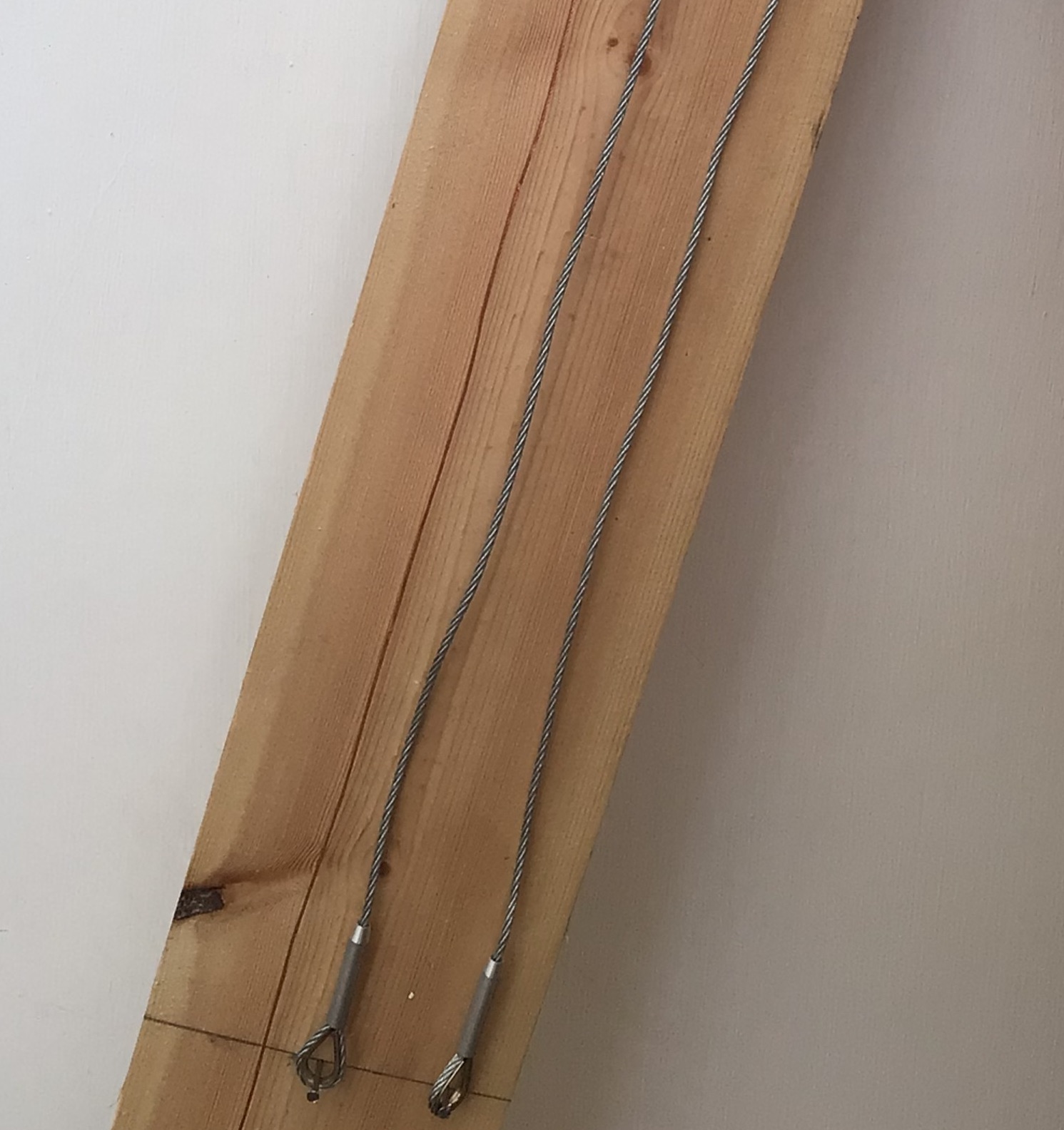

Dogberry wrote: Sat Nov 09, 2024 7:58 pm The ABER cable sets are metal but really soft and pliable, They are easy to put together. The cable as provided in the kit is too long for Tiger1 tow cables. I made a simple jig of two nails banged into a piece of wood to get the correct length. The thinner track mounting cable on the side of tank is also easy and again benefits from making a jig

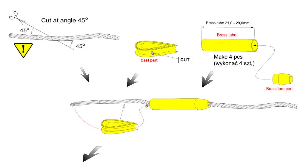

Hi Dogberry, on the thicker cables Aber suggest the cable should be cut at an angle to help both cables fit into the brass tube.
What did you use to cut the cable? Would scissors actually do it as the pic shows?

I used heavy duty kitchen scissors the type used for cutting chickens in half. The type of scissors you find in the wife's kitchen knife block. Heavy stiff blade. Cutting the cable flattens it and splays open the strands which is good. Fold the cable round the eyelet and roll the flatten end round the live cable and feed it into the brass tube. It is bit of a fiddle. When it is just in pull the live end of the cable to tighten it round the eyelet then use very thin CA glue squirted liberally down the brass tube to hold it together, use an activator to set the CA and that does it for me.

Sorry I did not the photo of making them just them on the jig- these are mine.
