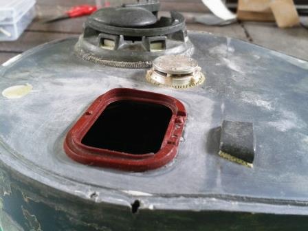

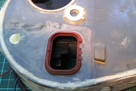

It's all looking so good through the hatches (and it really is) ... that you may be about to hate me for pointing out that the HL loader's hatch has issues. Whether or not you correct the shape of the aperture (and it's a small difference) the thickness of the turret roof needs reducing considerably.
The Tamiya loader's aperture transplanted onto the Heng Long turret.jpg (29.87 KiB) Viewed 5002 times
View of the loaders hatch looking into the turret.jpg (25.91 KiB) Viewed 5002 times
What you should see through the open hatch is nothing more than the internal rim of the splash guard - this was bolted into a larger aperture in the turret roof.
At least this will show off more of your fantastic internal detail!

Tanks FTM, you are a Hero, was just muttering to myself that it was time to get glueing the turret up...good job I checked in with the forum first.
Thanks Dude, will get that thickness off and go check your thread again..sometimes I get carried away and forget to check the reference. :clap: :clap: :thumbup:

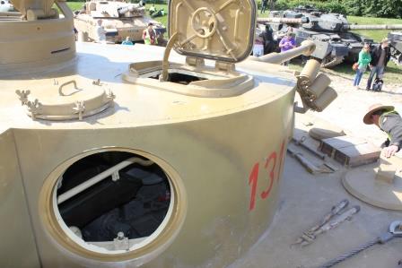

Just to clarify - since my last email was sent late when I was a little 'tired' - this photo shows how much of the hull roof will still be seen:
Bovington Tiger with turret hatches open.jpg (34.74 KiB) Viewed 4987 times

Have taken off the inner ring now, which with all the interior was a bit of a faff but got there in the end.
