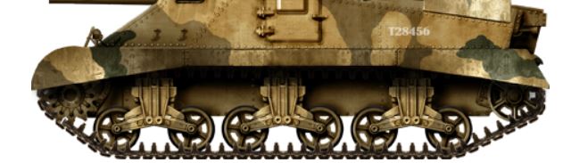

Re: M3 Grant (Lee?) scratchbuilt... or that's the plan anywa
One important thing to check is the height of the return rollers compared with the sprocket and idler. The tracks should be flat horizontal to look good. I have some experience with converting Sherman suspension into M3 and this is one of the main challenge.
Grant
Grant

lmcq11 wrote:Hi,
This is what we call "Close enough for Goverment work" in the engineering business... Can't go any lower with the stock HL bogeys as a basis and the stock HL track without fouling on the track horns.
;D
Good, and if you put on skirts, everything will be perfect.

lmcq11 wrote:Good, and if you put on skirts, everything will be perfect.
But *he* will know....lol
