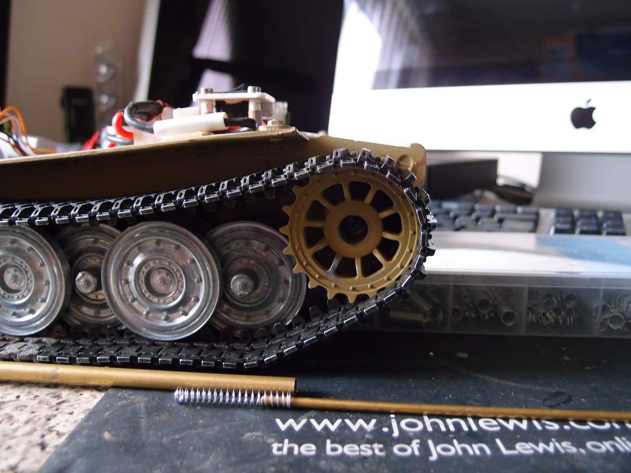

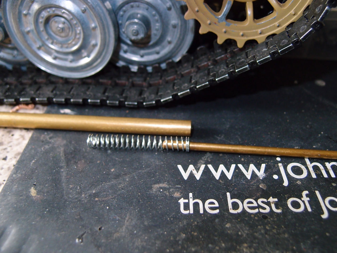

Hi Son of a gunners video set me thinking , i have the same problem the tank is nose heavy. Going to try another version of your trick for fixing the low front end. Some tube, rod and a spring to push the front up.
